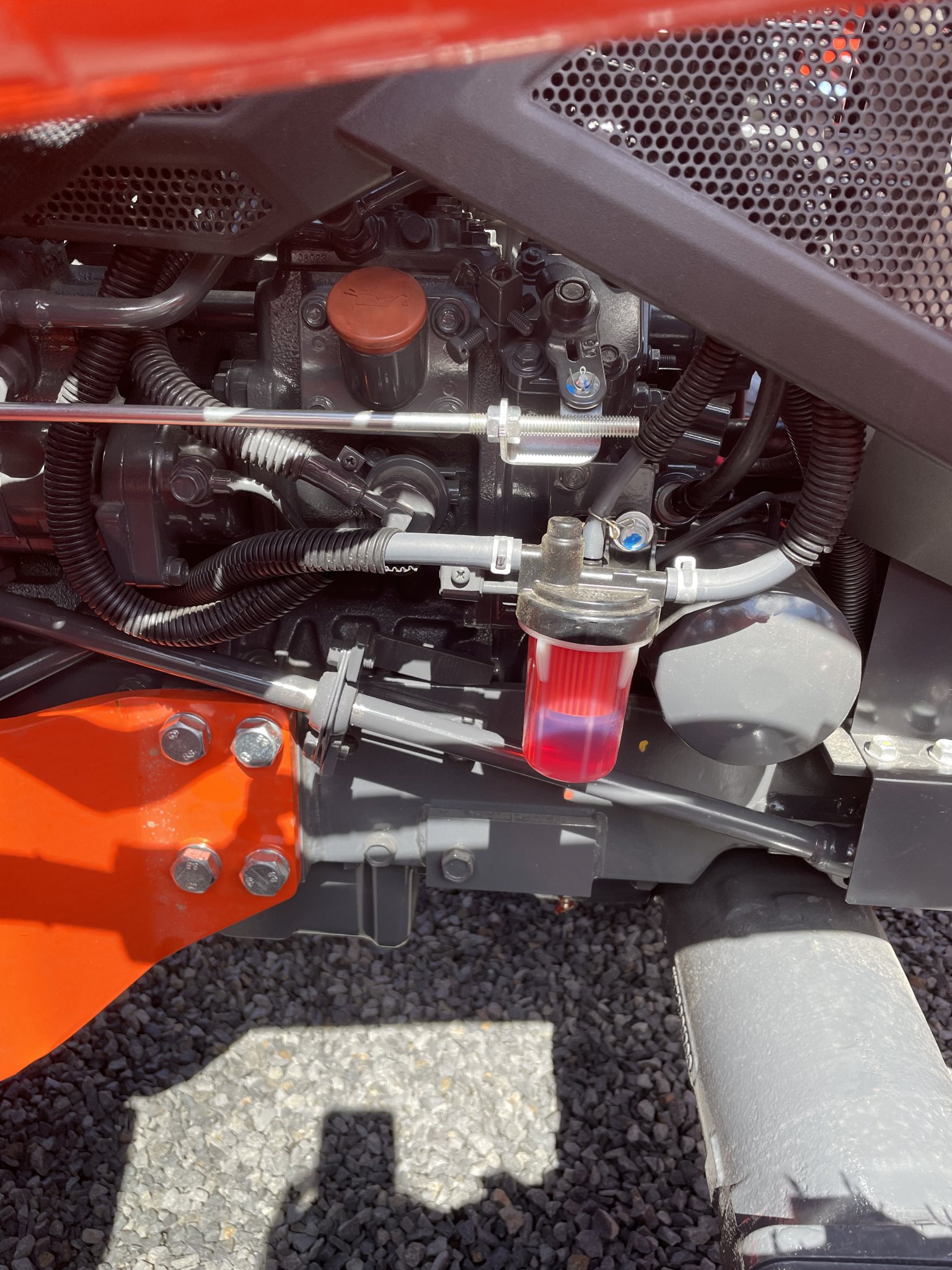

The injection pumps on the L2501 and L2502 are completely different. I haven’t had the chance to really dig in and research the L2502 pump yet but, if you do a search, I made a thread and took some pictures illustrating the differences between the two tractors.

L2502 Injection Pump
L2501 Injection Pump.

You can’t trust the parts diagram. The L2502 pump is a different design. However, you’re more than welcome to pull it off and play with the shims. Please take pictures if you do.

Yeah last night I started looking at mine and compared it to the video of the 2501 pump being shimmed and realized they were completely different. I am contemplating removing it so I can take a peak and also to see if it is a Bosch pump and has a part number on it.
