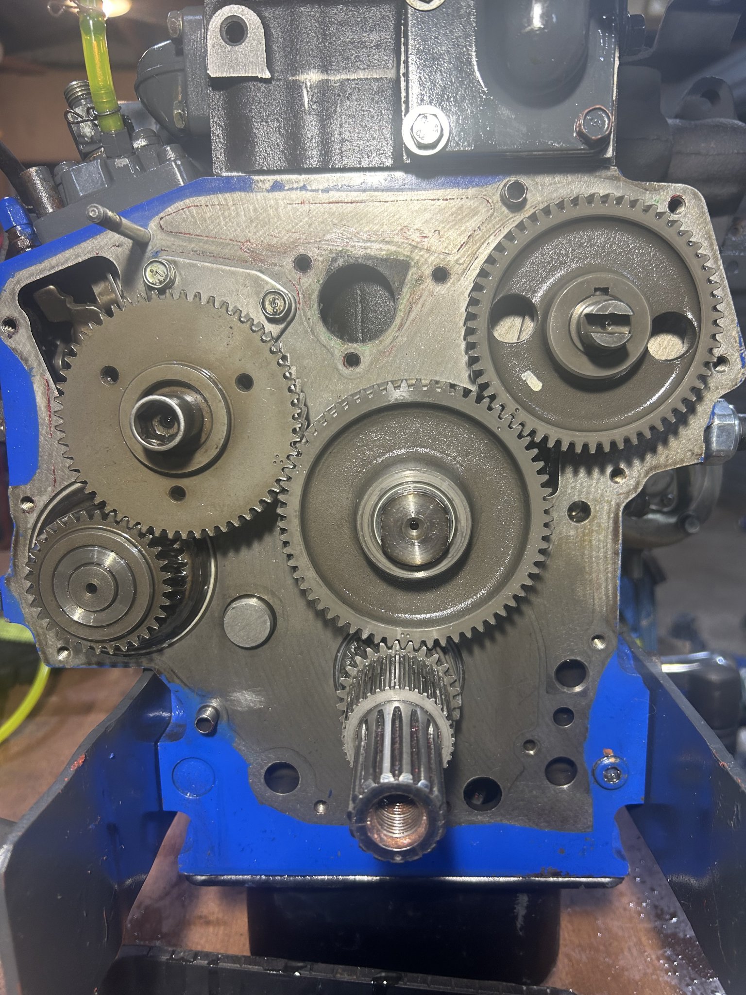

Thanks for the ideas and the image. Mine looks the same but can't see the keyway due to the oilpump gear being in the way. Is there an easy way to pull the oil pump gear without having to pull the whole crank out?
Answers to other questions:
Can spin OK by hand with injectors removed
All cylinders approx same measurement
Compression tester is new and correct adapters used, but have nothing to calibrate against
All gears aligned at once, took a photo tonight and will try to upload to this thread

hmm, all the gears in the picture look properly timed but I have a question...
Is there any way gear #4 ( camshaft ? ) could be installed 180* off ?
#3 and #5 show 'keys' so they can't be wrong
I can't tell how #1 is attached

crankshaft gear is keyed, so can't be the problem but still #4(camshaft) might be 180 out.
can anyone confirm/deny that is possible ?

Impossible if all dots are lined up as his photo shows.
The cam can not be 180 out in this case.

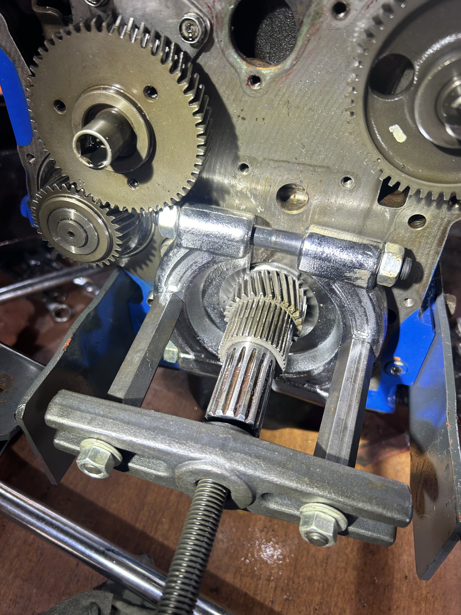

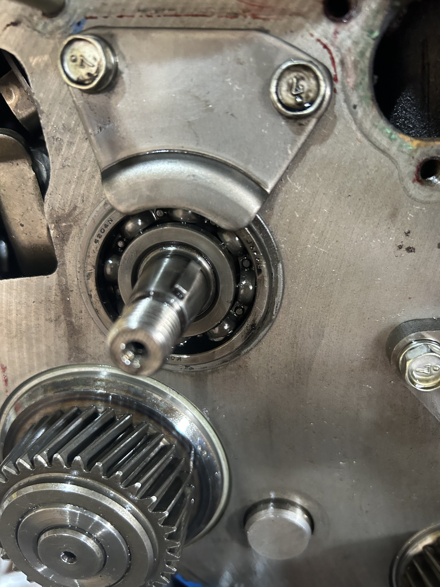

Hi everyone I pulled the camshaft gear and it has key behind the retaining nut so all good there. All lined up ok.
Thought I’d pull the oil pump and timing gear off the crank to check the keyway but can’t get any separation between the gears to use gear puller and trying to pull both together I can’t get them to move- have tried penetrant and heat. Worried something will break if I keep cranking and don’t wanna do that as may not be anything wrong with them.
any suggestion's on how I can get them free would really love to check keyway as this is third time I’ve had it apart.
could key have sheared and is jamming the gears?
11,315

A sheared key in the crankshaft WILL toss timing off ! I've seen them on 20+-HP gas engines on riders as well as push mowers. They use aluminum keys..kind of a 'safety' thing to protect the engine when you hit a big tree root. They get mushed and flywheel moves .
WOW a REAL puller ! Nice to see the proper tool being used. I've used pickle forks and wrenches with success but BUT only after having a little gap to get behind the gear.
Have you tried a SHORT 'burb' with an air impact gun ? I do that to get stubborn flywheels off rider engines. Usually 1 burp, pause 4 steamboats, 2nd burp, clunk....off it comes
I'll keep a couple finger crossed for you ,hope to see 'tada' picture soon !

Look under the bottom of the crank and you should see the key way slot even in the oil gear.
The slot is 180 degrees from the dots on the top.
I use 2 stiff putty knives, one on each side driven in between the oil drive gear and the crank gear to get them to split apart.
Unless the engine had something that stopped the crank with incredible force the chances are really really low that there is any damage to the key way.
