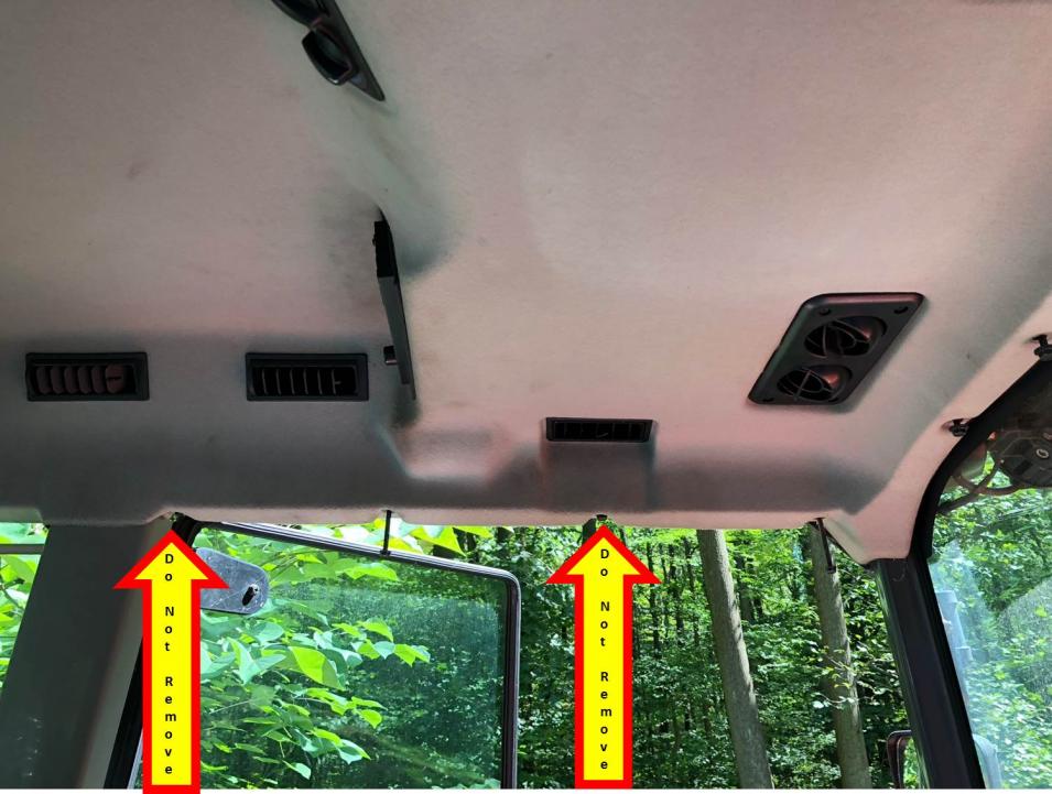

The defogger wires were protruding from the roof liner, but were a bit short to attach to the glass. There was too much resistance when trying to pull the wires downward. Not wanting to risk any damage to the wires, the roof was removed for inspection. Nothing was really preventing the wires from being pulled further downward except for all the tape wrapping the wire harness. (Removing the roof was unnecessary in the end.)
When removing the outside roof, do not remove the four screws (2 each side) at the door opening. The picture below indicates which screws stay in place.
