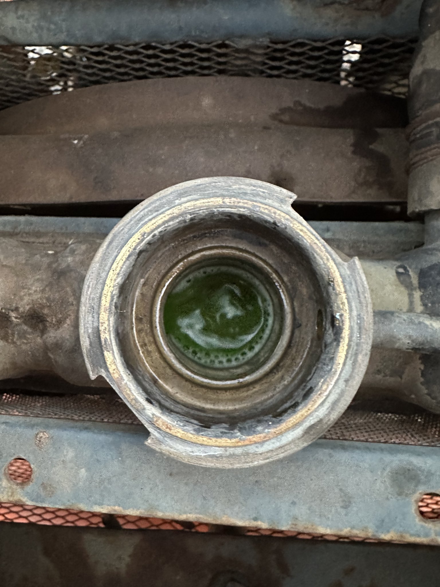

Your local auto parts store should have pressure tester to rent. And adapters. Probably like an inport adapter, nissan or Toyota may fit your rad.
