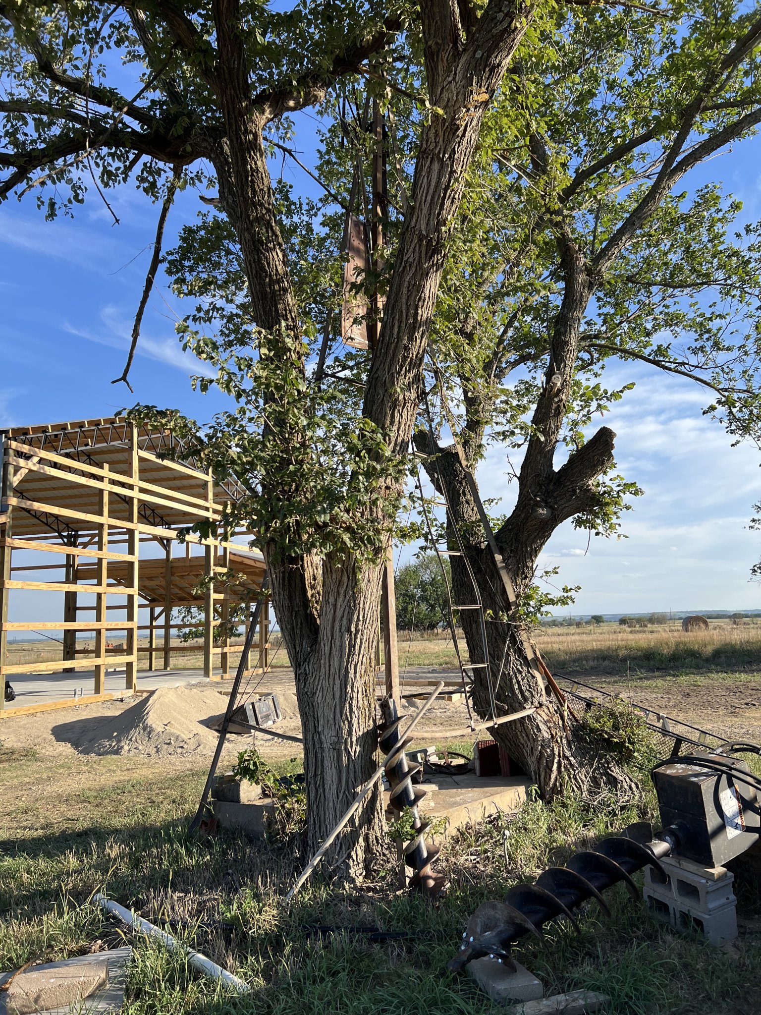

I will cut the Elms down. Both of them are right on the concrete cap of the well. They have caused that cap to move some. I’ll get some pics to post. There is a wind mill that used to pump water out of the well, directly over the cap, Elms growing in the base.

The Elms are touching the concrete cap (the cap is about 7’ square) & have engulfed 2 of the wind mill legs that are over the cap. I believe the wind mill provided stock water back in the day. I know these Elms suck a bunch of water out of the well. The Elms also provide some nice shade for me to park under during this KS heat. The new building will provide new shade, & the Elms will go away.

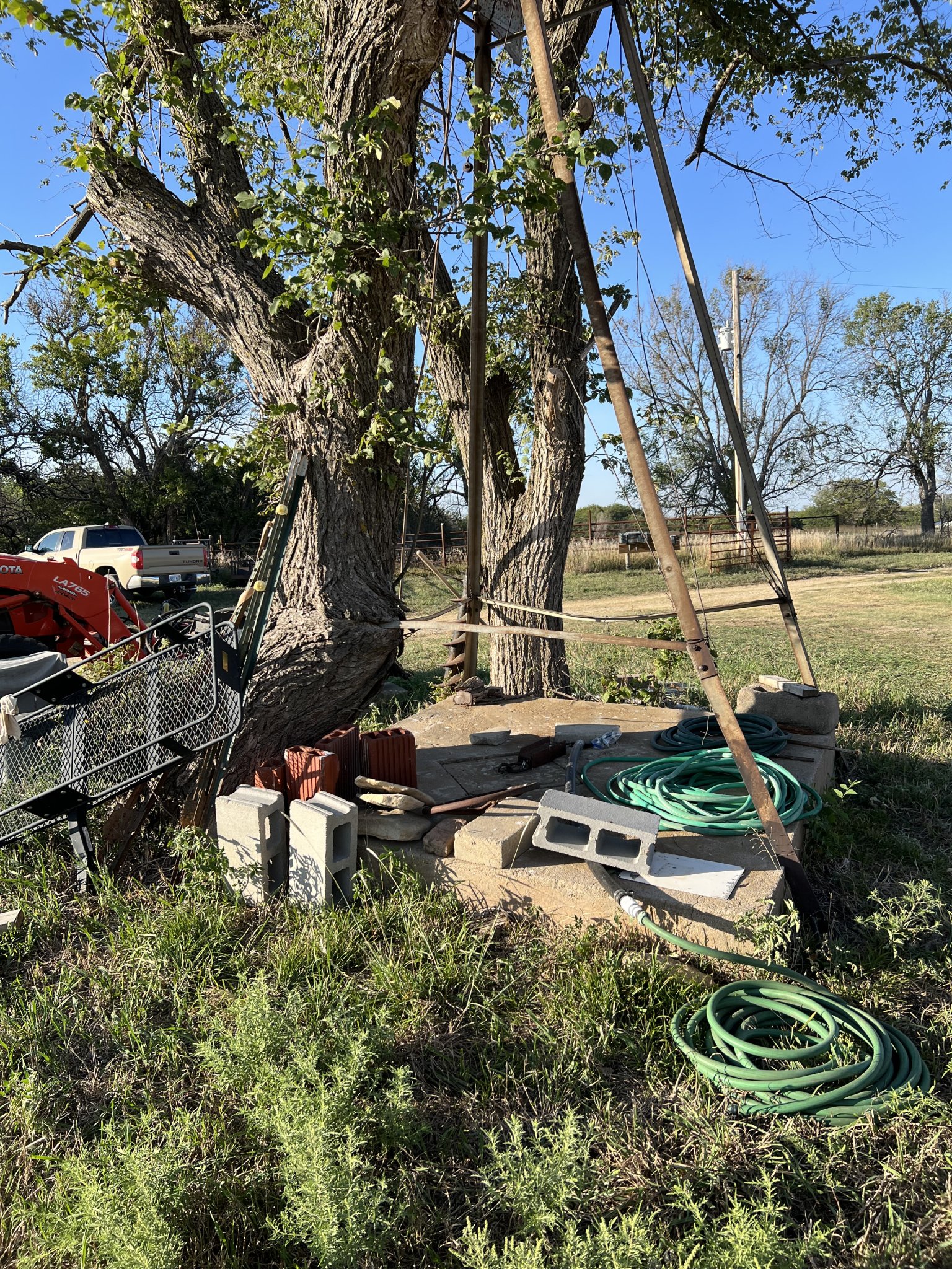

With the tree that close to the well I'd be concerned about the roots pushing the rock wall casing in. That would ruin the wells integrity.
Post a picture of the well area. Is the windmill all there? If its not too far gone I'd rebuild it and use it when needed for watering garden, livestock, etc. There is a windmill restoration forum on FB.
I'd consider cutting the trees down but I might leave the stumps in place a couple feet above the ground--no digging or grinding. I'd also check with someone at soil conservation office or local chemical sales company to get clarity on any chemical to use to kill tree stumps. I would think a ring of Tordon on the outer growth ring of those stumps would never get to the water, yet stop all growth.

I agree with D2Cat- I wouldn’t do anything besides cutting the trees down with them that close. Leave the stumps.
I certainly wouldn’t try to dig the stumps out. Too great a chance of compromising the structure of the well.
The Elm trees are against the concrete cap on the well. They have the base of the windmill jacked up. I’m thinking cutting the down to ground level. I will not dig them out.
The rock lining is still round on the inside of this well. You can see where the pump jack was attached.

OK, I have to ask...
WHY did you allow those trees to grow next to your well ?
Silly neighbour has a tree 2 feet from foundation and wonders why basement leaks.....
