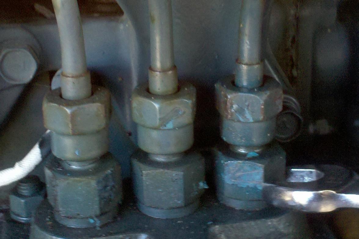

Well, for all of those who posted to my question or anyone who might be intrested here is what I learned...... I bought this tractor from my brother in law. He sold it because he said it didnt have enough power to mow his seven acers with a five foot bush hog excecpt in low 2. As advised by others on this forum, I did a complete service. I did find water and gelled fuel in the bottom of the fuel filter (no suprise in Florida, the humidity capitol of the world). I filled the fuel filter with injector cleaned (recomended by NAPA), bled the injection pump, and then loosened the pressure fuel line to each injector. While my brother in law cranked the engine I tightened the first injector that started to pump fuel. I just happened to be #3 as soon as I tightened it the engine tried to start. Immedatly number two started pumping and I tightened it. The engine started running like it was when I bought it. Funny thing though, No fuel from #1 injector. As you can immagine Thoughts of expensive fuel pumps started running through my head. I was hoping that It might be a clogged High pressure line so I went to loosen it at the injector pump. I found that the fitting coming out of the pressure pump was loose and could be moved around by hand (the bottom fitting the the wrench is pointing to). It was not leaking and had no signs of it in the past. I went ahead and loosened the line from the fitting. Still no fuel from the pump. Just for fun I tightened the fitting going into the pump (3/4 of a turn) and all of the sudden it started pumping fuel! I quickly reconnected the high pressure line to the #1 injector and PRESTO! I had a tractor that didn't chug. It ran like I thought it should. My brother in law just stood there shaking his head. He has owned that tractor for 5 years, never touched the high pressure lines and says it has always run that way since he bought it. For fun we hooked up a 6 foot bush hog and ran it through chest high weeds in high 3. That little cream puff never even let out a wimper......It's probably good that it was getting dark, so I couldn't see the tear in his eye.
This goes to tell a lot about these little giants. Three cylinders, minus one, plus the drag of the other cylinder equals about half power, and he has been using the tractor for years. I can only hope that there is no damage to the "draging" cylinder. All I can say is if you ever have a doubt about what type of tractor to buy, try running the others on half power.

OK , if you are intrested I got the photo to upload.....Finally! The loose fitting was the one the wrench is pointing to.
