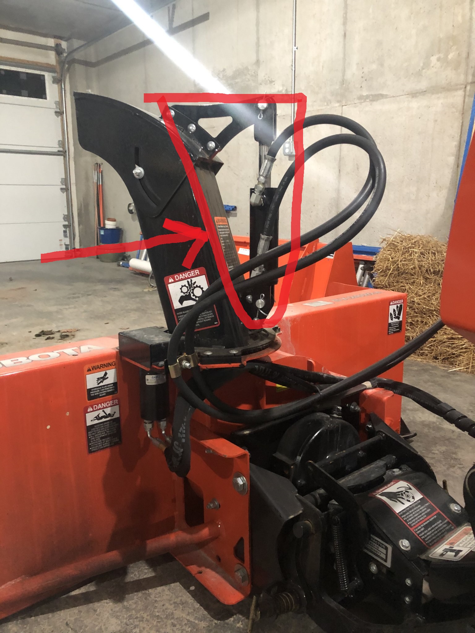

So I want to hydraulically articulate the chute deflector on my BX2822A 55" commercial snow blower with my B2601 tractor TRUE THIRD function.
I can't see paying $1100 for the hydraulic chute deflector kit BX2821A when all I need are the parts highlighted in red. If you purchase the kit, you are purchasing parts that you really don't need if you have a third function. You will be paying for a diverter, electrical harness, etc, all you don't need, and WORST YET another switch up on the joystick in addition to the 3rd function. YUCK!!!!
The dealership confirmed that the hydraulic chute deflector kit for the snow blower includes extra items you do not need if you have a third function on the tractor. It includes electrical connections and a diverter system that are unnecessary.
The dealer priced the actuator only and the mounting hardware at $560, which would save me $500 over the full hydraulic deflector kit.
In the picture below, the person paid for the diverter on the blower and the dealer came out and hooked the deflector directly to their tractor third function.
Borrowed picture from someone kind enough to show me the clean setup.
STILL WORKING THIS ISSUE TO GET THINGS HOW I WANT THEM. THIS SETUP IS PERFECT!!!! CLEAN AND ONLY ONE BUTTON ON THE JOYSTICK.

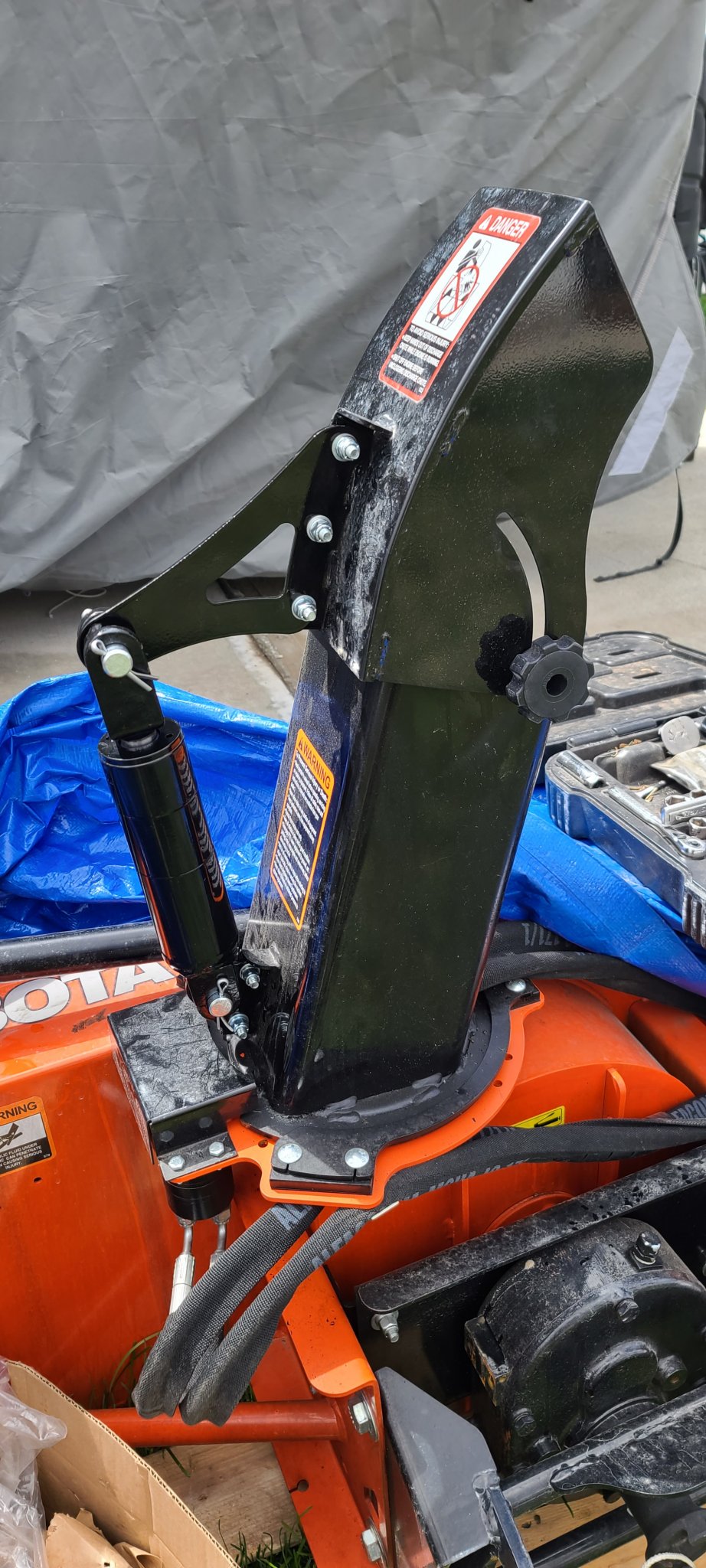

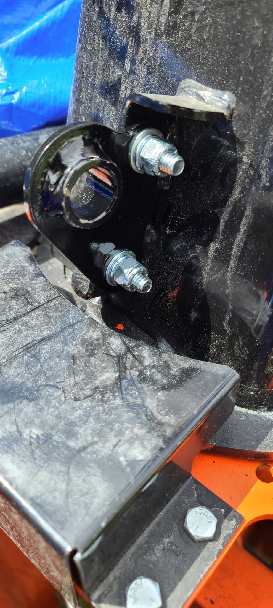

Again, a big thanks for this info, it saved me a lot. Here are some pics of my current install.

I wanted to give you a HUGE thank you davidmem!
I bought a BX23S-1 in Dec. 2021 and it arrived in early Mar 2022. I ordered the 48" snow blower (BX2830) but did not order the blower kit (BX2821A). Later I found this thread and ordered all of the parts on your pdf examples except for the hydraulic cylinder and paid $230 from my local dealer. They wanted $540 for the cylinder but I found it on Messicks for $423 and in stock (saving $117). Once I got the parts and started installing it, I realized that I my cylinder came with the attaching pins and I could have saved around $50'ish not buying those, but they might come in handy later so I'll keep them. I also realized that I didn't have the bolts for the hose clamp and support clamp which I'll have to get later. But most of it is installed. So without hoses the cost for me was around $680 (ship+tax,etc).
davidmem can you tell me how long your hoses are? The pdf just says "1 set hyd hoses". Once I get the hoses I can attach the 90 deg elbows, but I'm not doing that now since the cylinder holes are currently plugged and would not be if I installed the elbows, so those will be done when I get the hoses. So the hoses and flat face connectors will raise up the final price but I'm happy.
Awesome!!!! Very welcome and I'm glad it helped you. I will try to remember to measure the hoses and get back to you. I'll try tomorrow.
