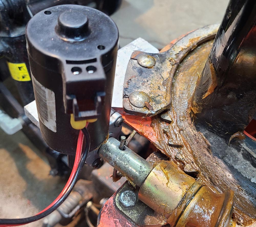

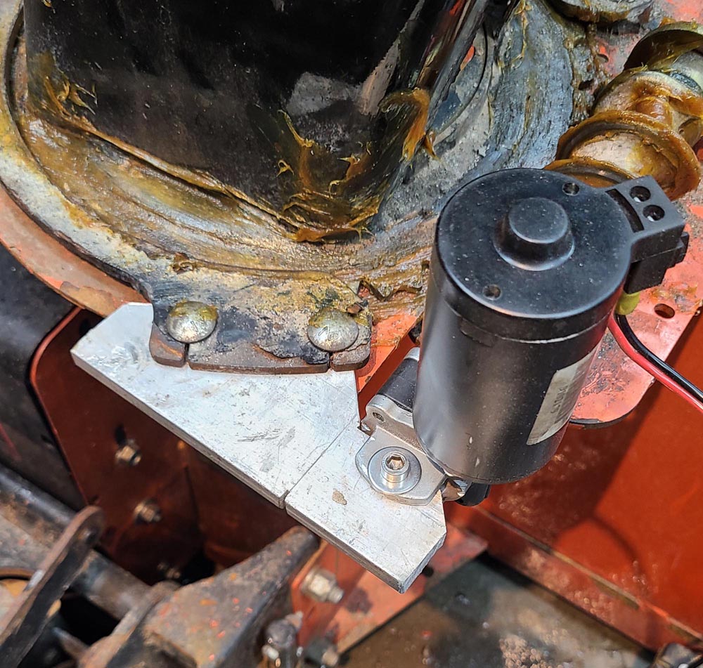

Step 1: Mount the motor. I cut about half of the shaft off of the motor so that it fit in the worm gear on the blower. Then I drilled a hole through the shaft so that I could us a hitch pin to mate the motor to the worm gear. I then removed the chute spacer closest to the motor and used a piece of 1/4" aluminum as a bracket. I made a cardboard template first because it is easier to work with, then transferred the pattern to the aluminum and cut it to shape. The spacer went into the parts bin.

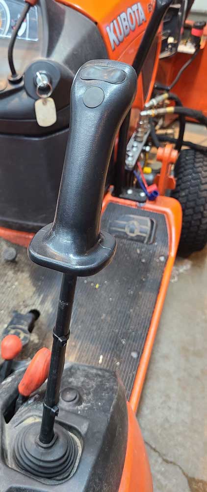

Step 3: Mount the Joystick. I mounted the joystick on top of the factory kubota valve. Pull the factory knob off, just a friction fit. Then unscrew the metal part from the joystick and drill out the threads with a 1/2" drill bit. Then slide the joystick onto the valve shaft.

I have been using this for a couple of weeks and it is working well. I was worried that the motor may not have enough torque, but so far it has been good. If it turns out to be the weak link, I will just source a new motor with more torque and fab a new bracket. The bonus to using the winch relay is that I could almost put a starter motor there if torque does become an issue.

Is the middle button on the joystick a momentary or latching push button?
It is a momentary micro switch.

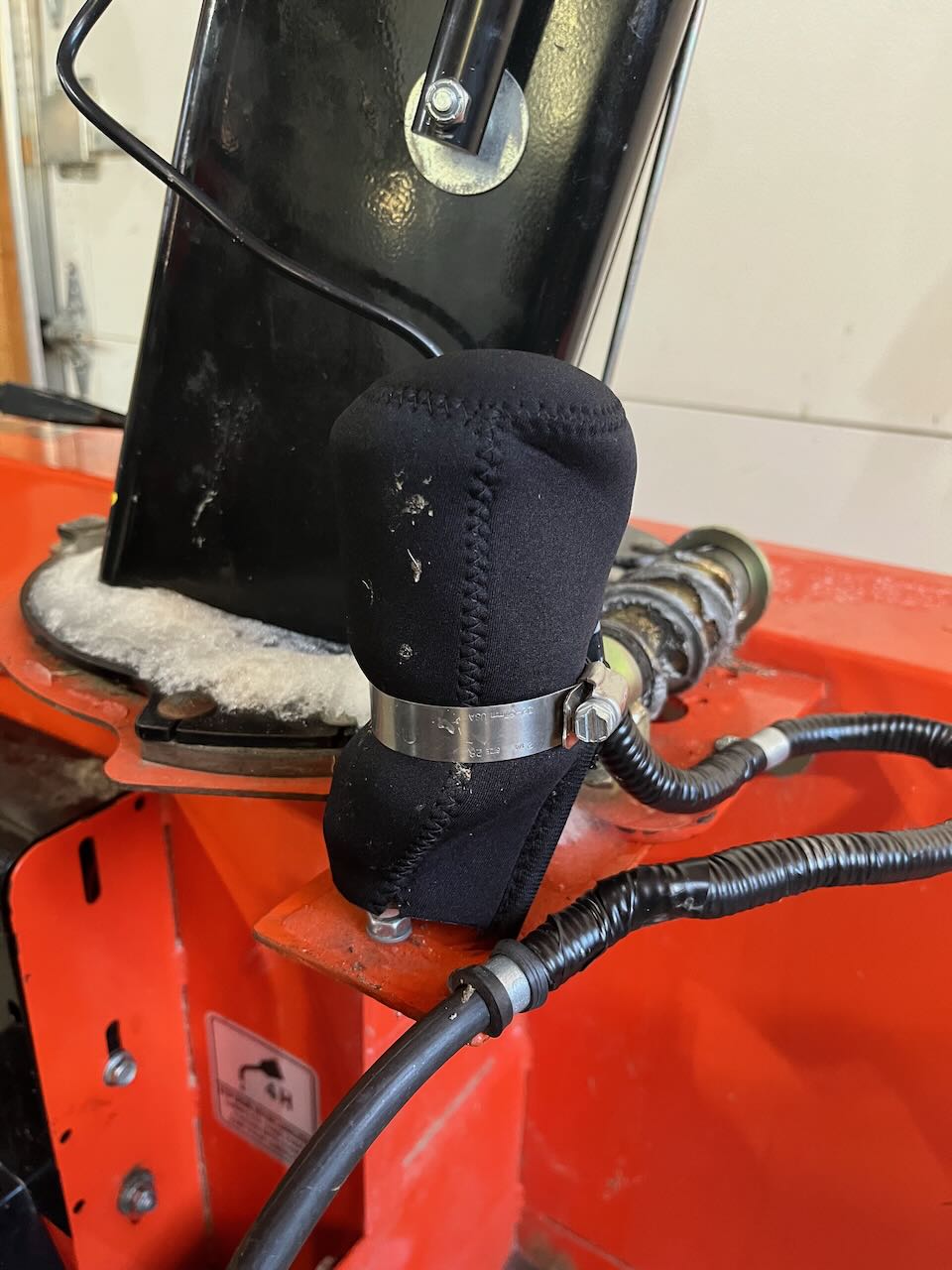

I too used that same seat motor. It is perfect. After install I bought two beer bottle coozys and weatherproofed both the seat motor and the linear actuator I used to lift the chute angler. I know your controller is a better solution but I cheaped out and used a project box I had and two DPDT momentary switches from China. They are boound to tbe the weak link so I have a spare but when they fail I’ll do the relays. Thanks

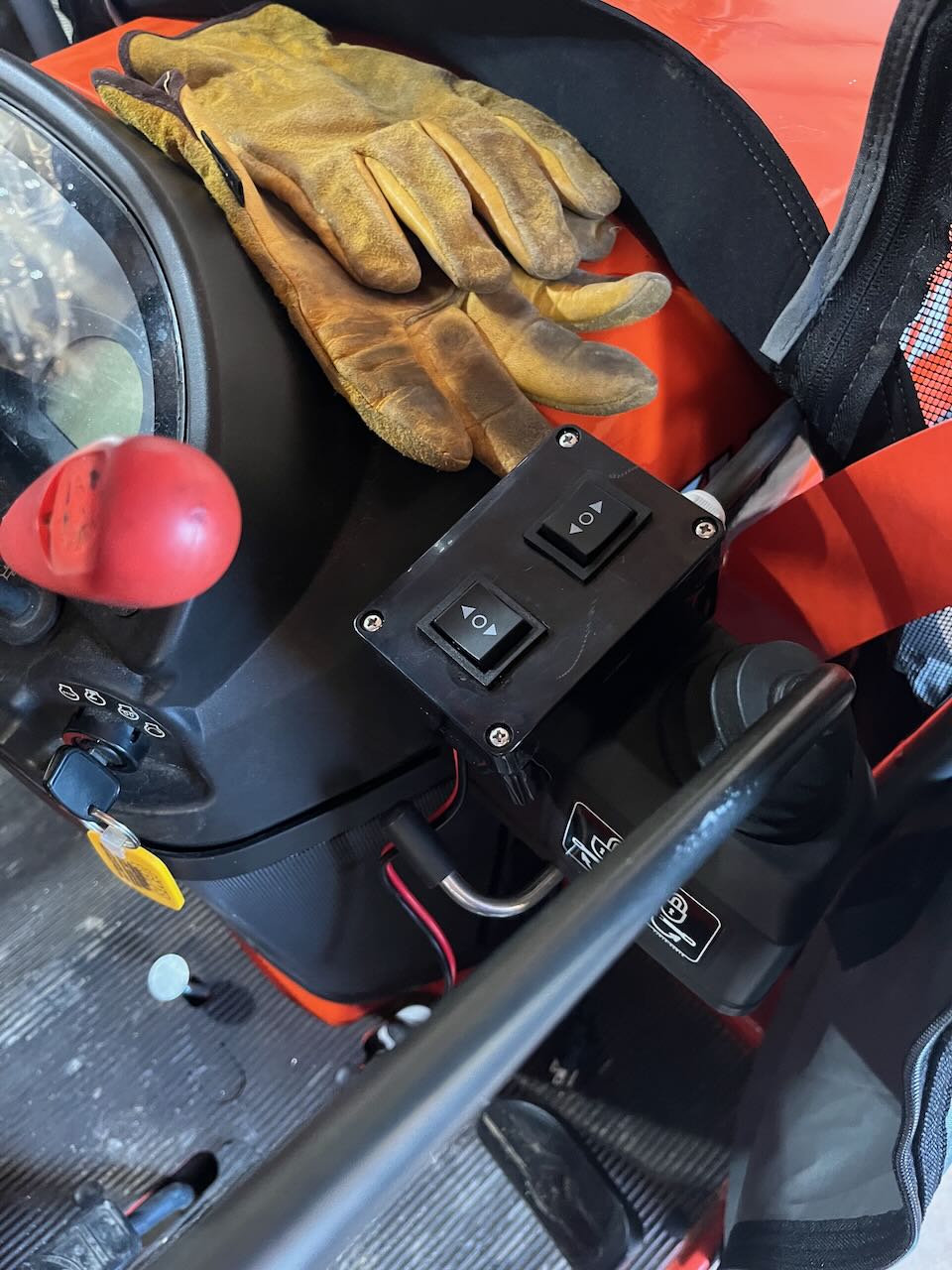

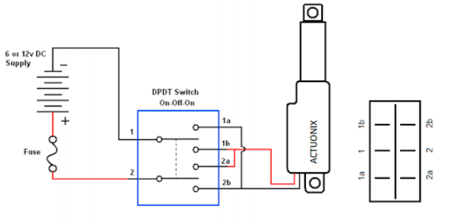

A spring loaded, center off, double pole, double throw switch (DPDT) is what I use to directly control my electric chute rotator and linear actuator on the chute deflector. the motor and the linear actuator draw such little current that it doesn't take a very heavy duty switch to handle the load. I don't think my motor draws much more than 2 amps.

The switch that comes with the solenoid kit is a SPDT center off rocker. Single pole will not work for controlling an electric actuator directly. An electric actuator moves in each direction depending on the polarity applied to both terminals of the actuator. The winch solenoid or a DPDT center off switch flips the polarity applied to both actuator terminals.
