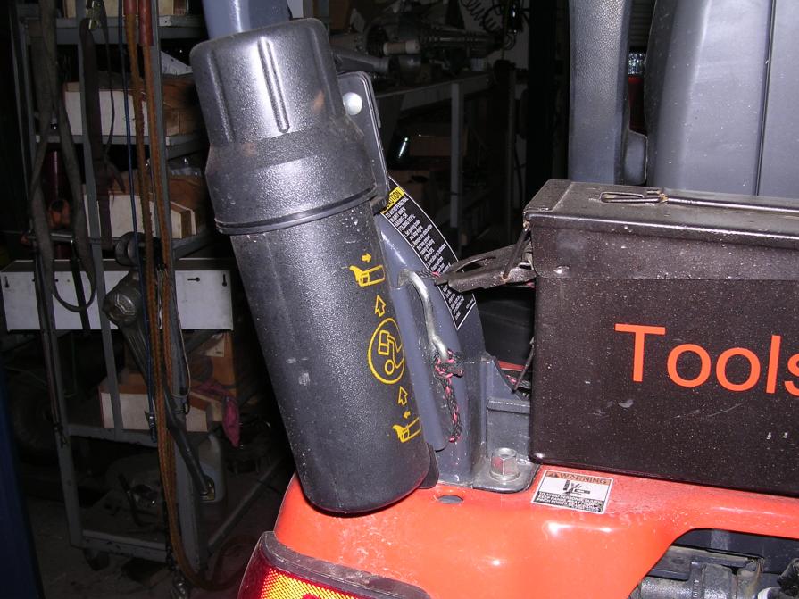

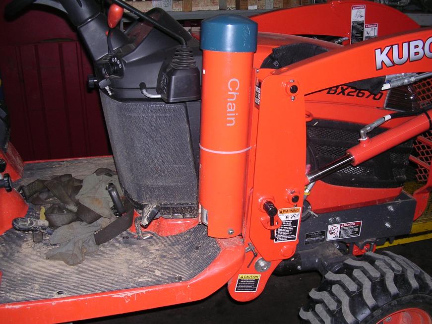

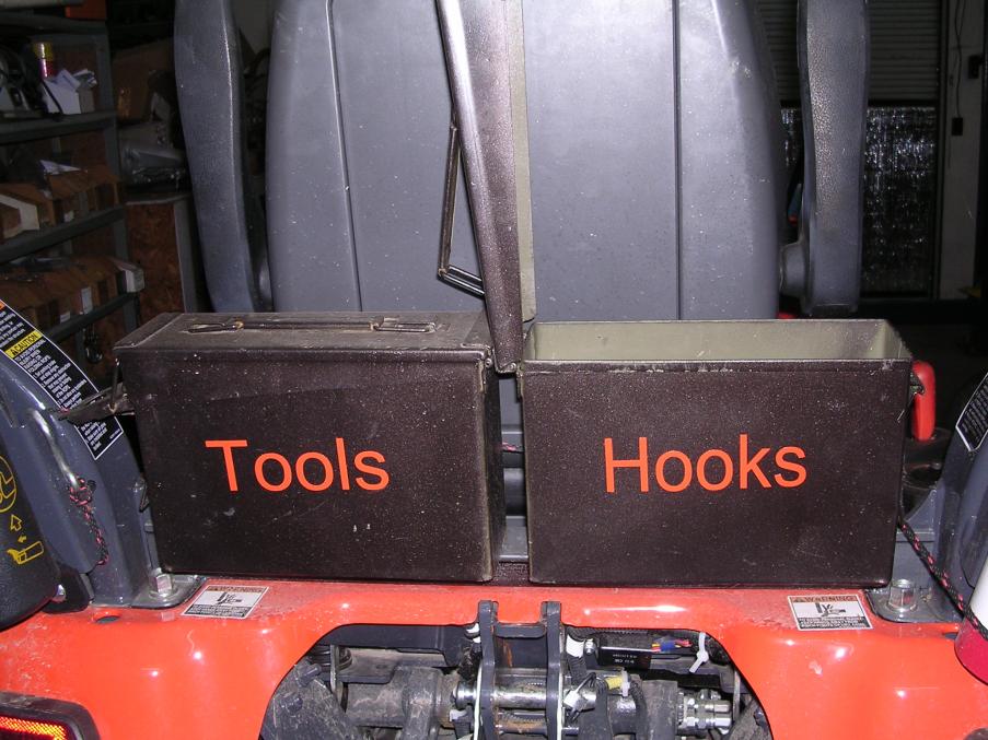

They are bolted ( 2 in each box) to a 1 1/2 by 1/4 thick angle iron with a pad welded on the end where the bolt for the rops is. Notice that there is about a 2 inch section cut off each end on the top rail where the boxes are, so you can get to the bolt to tighten it down. There is just barely enough room to get them between the rops and leave room between them so the lid will lift up. Very sturdy. That round plastic one on the left is a tool box also. The round tube on the fel support, there is one on both sides. !!!5!!! storage boxes/bins.
