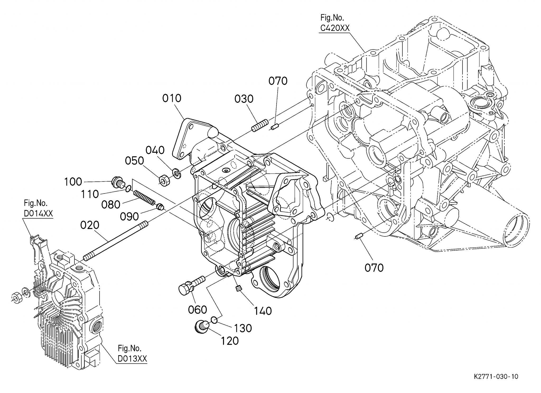

Heck of a good question, I find the WSM less than helpful.
The parts catalogue is a little more helpful, but still doesn't identify if this is for the PTO clutch or not. I think parts 100, 110,80 and 90 constitute the relief valve.
Thanks, DrankTheOrangeKoolaid for your,
Can anyone else confirm "PTO relief valve" location pic would be nice!?

Guys thanks for all your ongoing input, note the PTO is working much better:) e.g. after the auction taken from the good advice received to date. so over the past week's of testing, we found the PTO still only works for up to a 1Hr+- from a cold start before it begins losing power and stopping, its an improvement on the 30+-min run time before, hence in our efforts to fully resolve we seeking more help!
Question1: @ PTO clutch valve R1/8 test port what is the optimal PSI reading we should be getting?
Question2: where is the "PTO clutch Relief Valve" located on the BX25DLB ? is this it Fig2-S40? if so, how would we know it's clogged! and or blocked....

Help! please! Q. Where is the "PTO clutch Relief Valve" located on a BX25DLB ?
