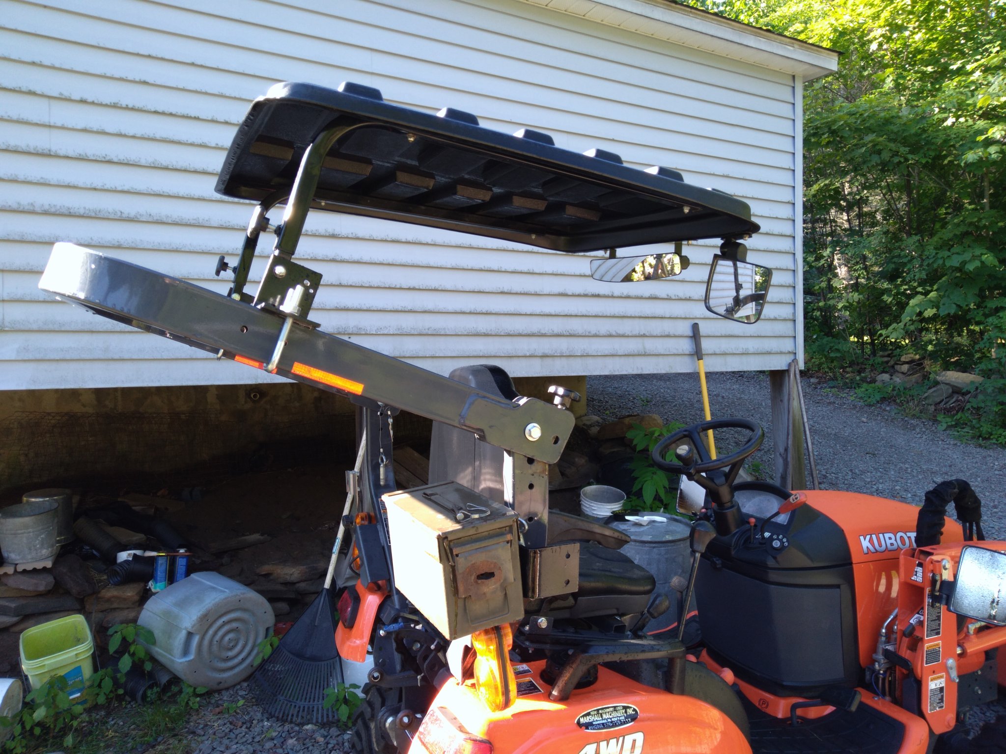

Rhino top folded down for getting in the garage.

Thanks Jay. I'm going to consider making something shorter. IMO, the ROP Bar is too tall.
Being as mine is always tilted back, I don't know how many times I hit my head on the dang thing
Oh I have whacked my noggin quite a few times off that rops when folded down!

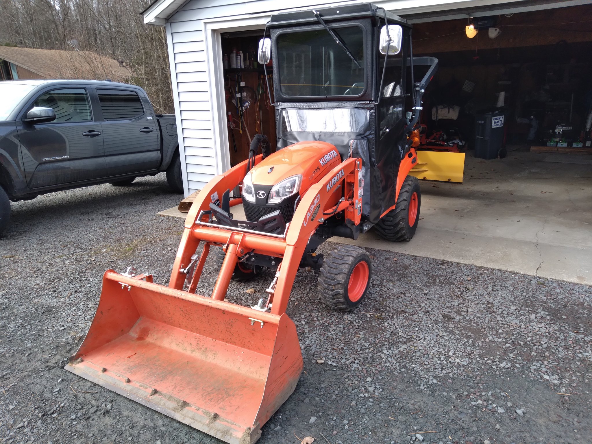

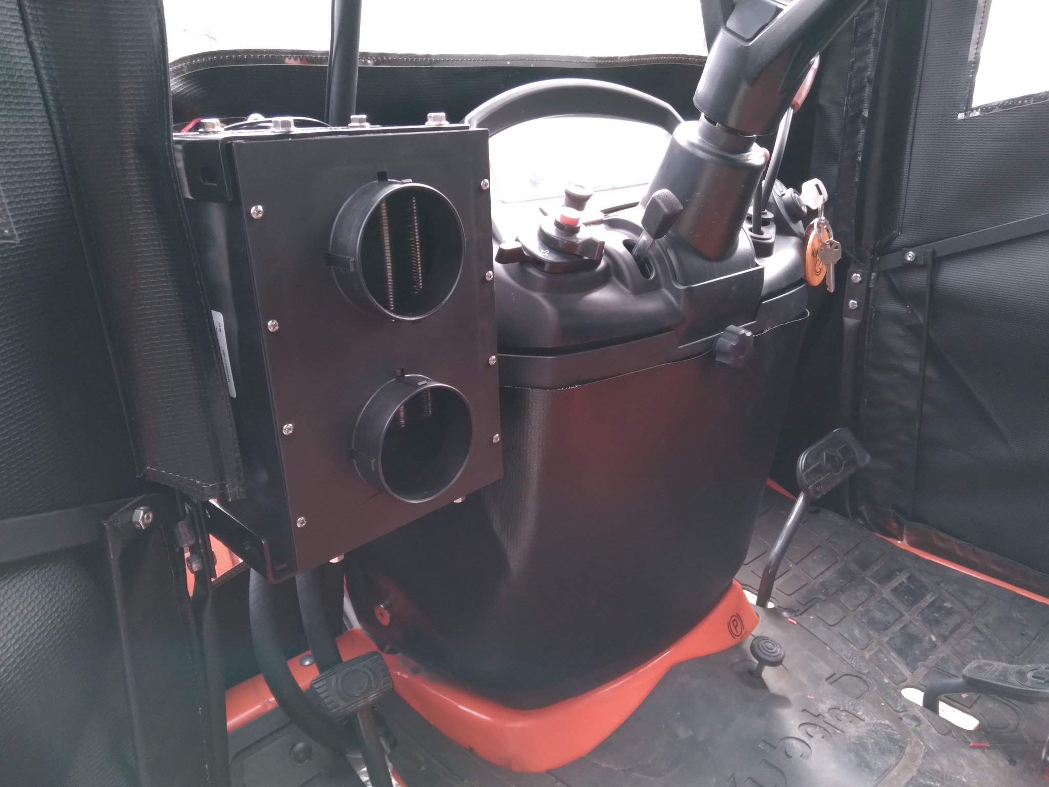

Winter mode. Fits in garage with rops down!
Nice and toasty in the cab!
