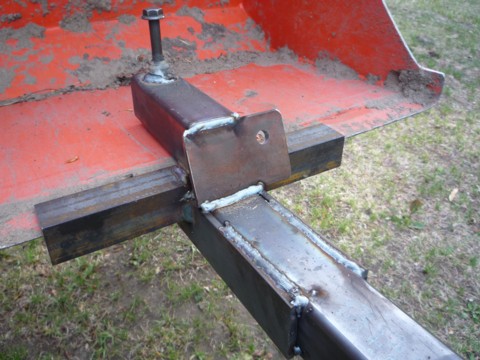

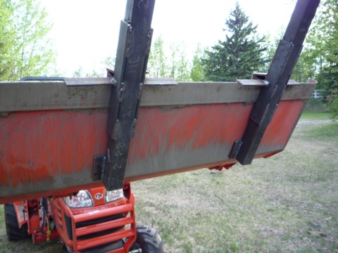

I needed a set of pallet forks to load and unload a 250 gallon water tote (empty) into and out of my pickup. I looked into commercial ones, noted that they tend to be $400-$500 a pair, and are much too heavy-duty for a little squirt like a BX1850. So, being the cheap so-and-so I am, I built a pair, and after a bit of tweaking find they work beautifully.
The loader is rated for ~500 lb, and the pair of forks weighs maybe 50-60 lb. The closest commercially-available clamp-on ones are much heavier than that, and reinforced 2" square tubing is plenty strong for this kind of machine. I've posted the pictures of them as they sit in case anyone else would want to build their own, maybe you can improve the design for your application (I can only imagine the beautiful fab job Wildfire would do on something like this!).
I'm into it for ~$60 in steel, 3 hours cutting and welding and now need a $10 can of spray paint. Only question now is Tremclad Black or Kubota Orange . . . .?:D
