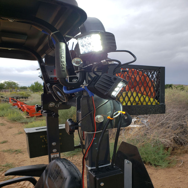

Below is my led light project with photos!
Please feel free to ask any questions, comment, yell at me, etc.
Again, that you all so very much!
Paul

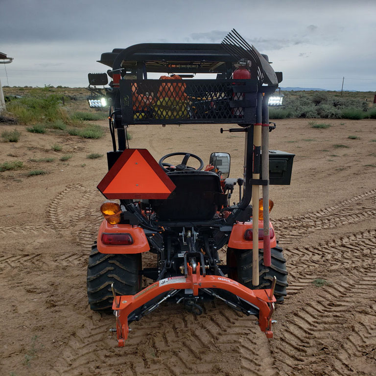

These LED'S are 60W per light front and side floods for a total of 240 watts.
I would have put more but that's at or near the maximum amps can pull.:D
Mounted a lighted weatherproof switch that lights up when the LED'S are on near the headlight switch.
Used a trailer wiring box for a clean water proof install.
Put a relay in wiring box with a trigger when the key is on.
Mounted LED'S on the ROPS on each side with a bracket.
Front view & Rear view.
I may be small but I will be SEEN!:cool:
Thanks

I found these particular LED flood lights on Amazon and they literally have LED'S built in to the side and in actual usage they seem throw about 20% as much as being projected forwards.
That probably explains why they are so bright and use 60 watts each!:eek:

Thanks! Have 4 mirrors,2 on the canopy and 2 clamped on to the fel.
Like to see what I am backing in to and like seeing what is coming up behind me when I go out on the road!
Call me small and paranoid!:D
