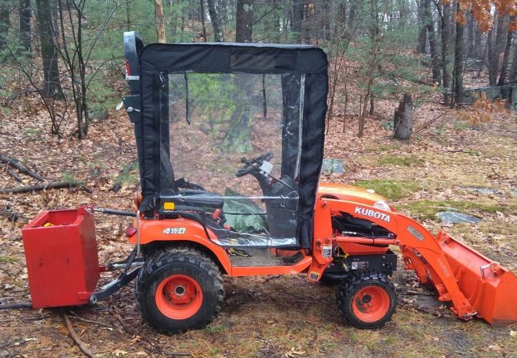

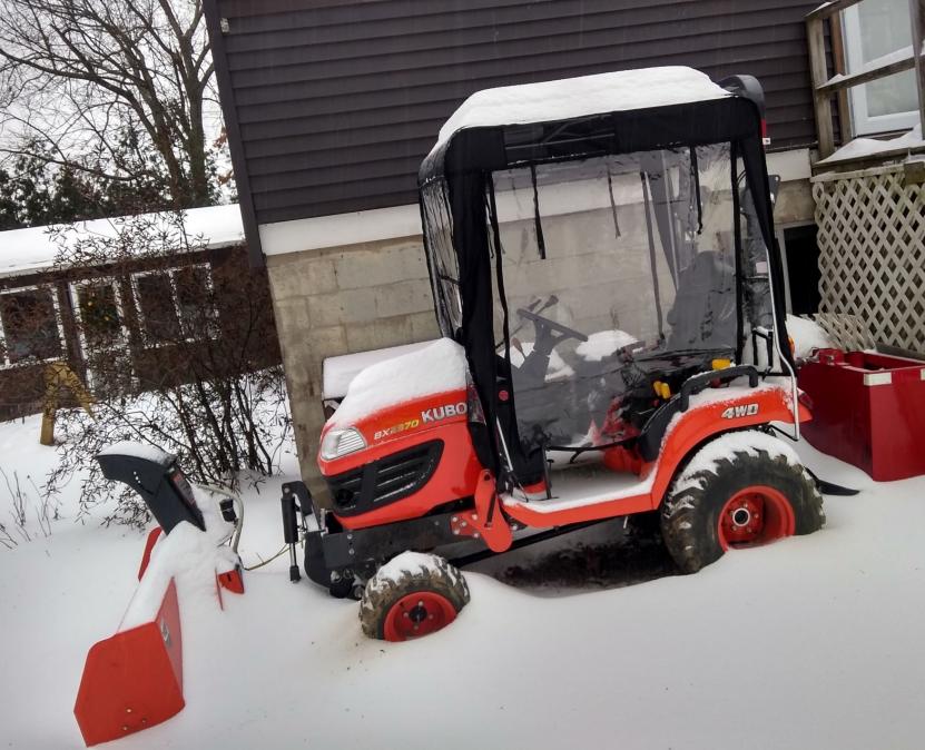

Better than heated steering wheel or gloves is a putting a cab on the BX.
I put a basic $300 vinyl cab on mine this year. Big upgrade from trying bundle up against the wind and snow blower output.
