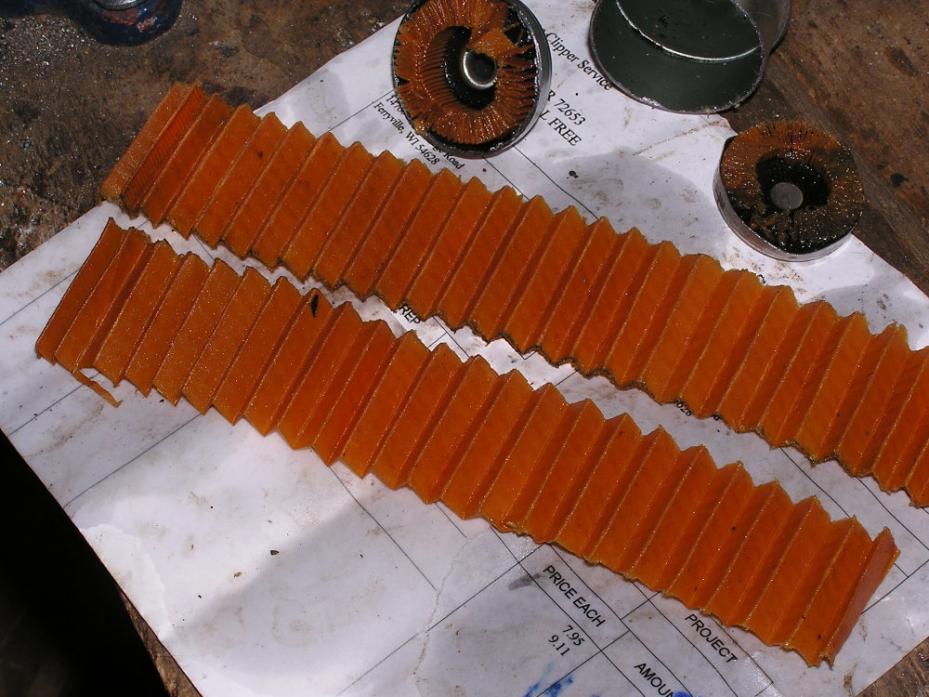

Opened up the first filter. Photo shows the folded paper stretched out with one fleck of something. I had assumed the orange color was rust. Maybe just the new color. No crud in the input side shell.

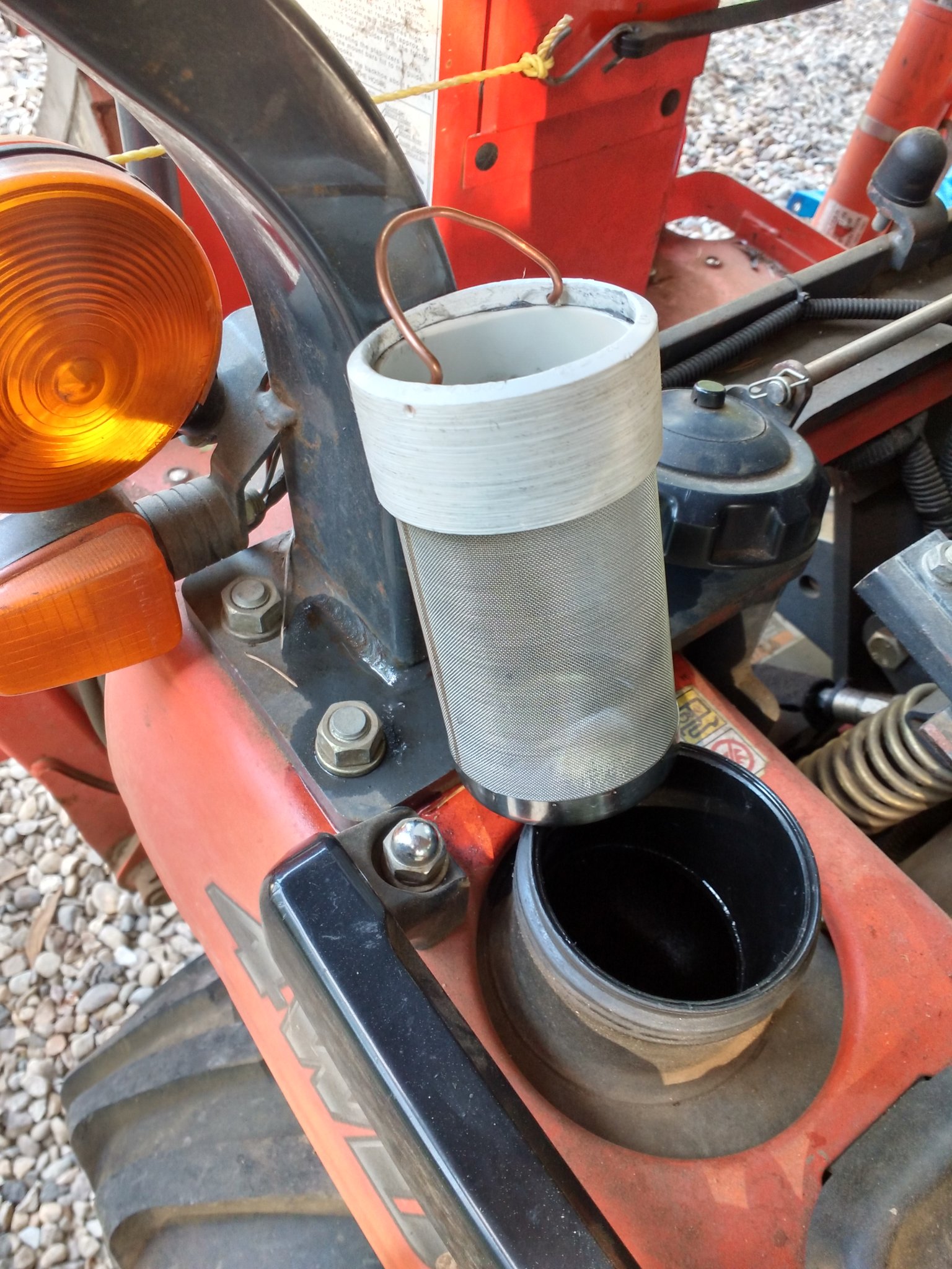

No matter how careful you are, sooner or later some piece of crap is going to get into your tank. Use a filter at the fill port of the tank, either from the dealer, or Mcgyver something like this yourself.
