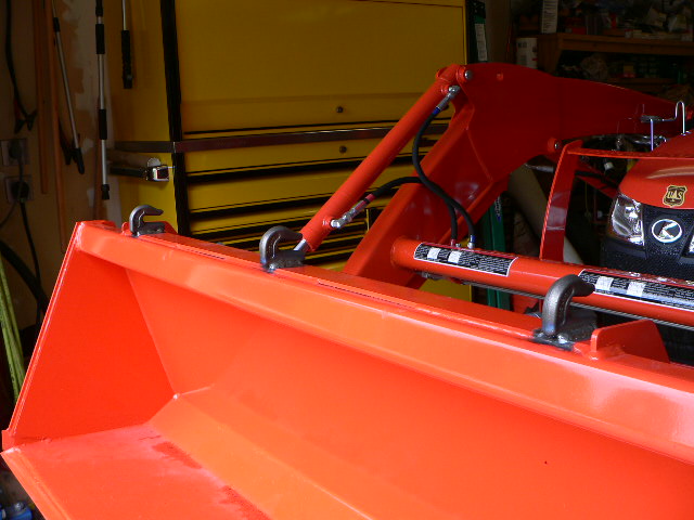

I also put a set side by side in the middle of the bucket as well. Works good for lifting from the middle and for hanging extra chain when lifting from the ends.

Welded two chain hooks to outside of bucket, and drilled and mounted trailer ball on top of bucket to move around goosenecks, etc, with loader. Use the chain hooks all the time for lifting, pulling, etc. The ball mount is extremely handy. Tractor is a m6800, w/la1162 loader.

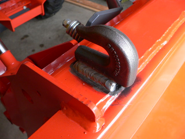

I welded 3 of the 3/8" chain hooks, (these will grab and hold 5/16 chain also) the top of my bucket was already reinforced. I got the weld on hooks with bevel already in place, then painted it with genuine Kubota touch up oain. I kept my outer hooks right in line with the curl ram to keep flex out of the bucket.

Nice beads. My welding is pretty awful, or I would have welded some on mine by now. 😁

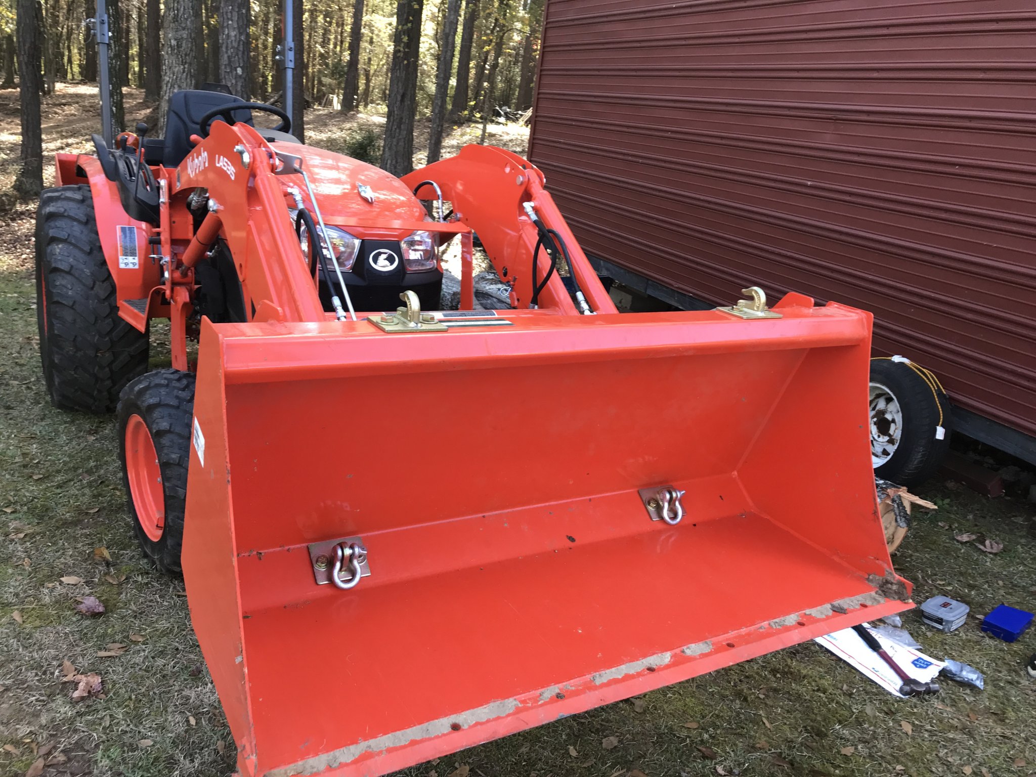

Good morning fellas, I was wondering what type of chain hooks to use on my B2620, either the slotted type for chain only or the rounder hook type which can accommodate rope or chain or rope?
Here's a combination of what I wanted and what one of my dealer's mechanics suggested.
I put grab hooks on the top edge of the bucket so I could use the bucket cylinders to help with the lifting/pulling, but also added clevis rings (D-Rings) to the back of the bucket down low. If I have something that I really want to pull on hard enough to increase the risk of breaking a sling or chain, I can use the d-rings in the bucket and a 1/2" clevis so that if it does break, the loose end goes into the bucket rather than hitting me or my machine.
I put grab hooks on the top edge of the bucket so I could use the bucket cylinders to help with the lifting/pulling, but also added clevis rings (D-Rings) to the back of the bucket down low. If I have something that I really want to pull on hard enough to increase the risk of breaking a sling or chain, I can use the d-rings in the bucket and a 1/2" clevis so that if it does break, the loose end goes into the bucket rather than hitting me or my machine. View attachment 51648

No, just galvanized. I took them off and put them in the toolbox till I need them. You can see my drill and hammer in the photo. I'd just finished mounting them when I took the pic, and did a trial fit with the clevises to make sure the bolts didn't interfere. If I put the bolts in with the nuts on the inside, they get in the way. They don't hit the ground and they're not visible turned the other way (unless I curl the bucket back and raise it up high).
Already had a few comments about getting some KO paint for the hooks. I don't mind keeping things looking nice, but I'm not sure that painting something with the sole purpose of suffering the abuse of a heavy chain is productive. They're zinc-chromate plated, so they won't rust for a little while. Two things I liked about those kits. 1. There's a backup plate the same size and thickness (3/8 plate) as the hook/d-ring mounting plate on the other side of the bucket. If you pull one off, you just ripped one hell of a hole in that bucket. You'll note that I mounted them near bends in the bucket. The strongest points that won't distort when I pull on something. I also tried to put them where they can be used only in tension mode on the bucket cylinders, or very little force on them. That should keep me from being stupid and breaking a bucket cylinder. 2. The mounting hardware included Nylock nuts, so even if they get loose, they're not coming off. I'll have time to see they're loose and take appropriate measures. I can still take them off to address any serious rust issues on the bucket if needed. I've already used them to move some pretty hefty water oak logs that I cut up for firewood. They were heavy enough to bounce the back of the tractor with the box blade on and ballast in the rear tires. Must have bigger ballast for that kind of work, or smaller logs. :)
