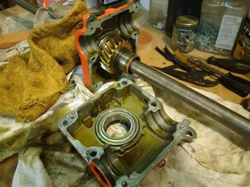

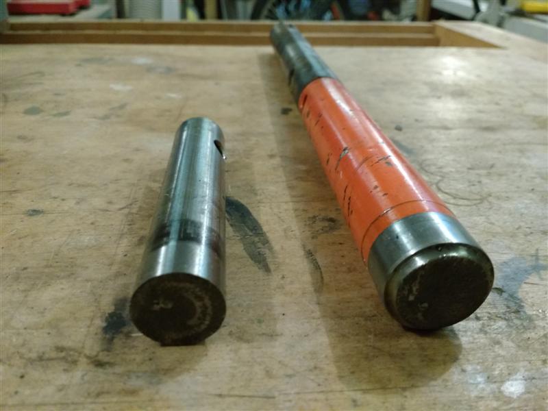

Of course, that is when things break, on days when nothing is open. We're talking about a 2750 snowblower which was operating perfectly when suddenly the augers quite, no warning, no catastrophic shock or nothing. Initially the thought was shearing pins but the auger shaft spins freely without engaging the blower shaft. So here we are, snowblower disassembled and can't order parts till tomorrow. The broken part is the shaft that holds the fan, and goes into that mickey mouse transmission at the front of the blower. Snapped clean off just inside the housing. Anybody have any idea of the replacement cost? Part number is 70060-02190.

I am trying to split the transmission and have about 1/4" space in between the halves and now see that the right hand seal and bearing on the auger shaft are pulling into the case. Do I keep on going, or is there a snap ring of some type holding the seal onto the shaft. There seems to be a retaining ring inside the seal, but it is impossible to get at.

This is an older snowblower, seen quite a few years of use, so maybe the shaft just fatigued. Anyway, it came apart by just forcing the transmission halves apart (very carefully) and the shaft slid out of the bearing and seal on the right hand side. From there, getting the rest apart was fairly easy. Everything in the case looks pretty good, very little wear on the brass gear, but I did wreck one of the tapered roller bearings pulling it off the shaft. I should have removed the worm gear first and then just tapped the broken shaft out of the bearing. Well, live and learn. From the part numbers on the bearing, it should be available at a local bearing outlet.

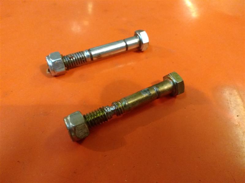

Make sure you are using the proper shear pins. Wrong bolts can cause failure of other components...

Can you post a few pictures of the areas where the shear bolts are and of the shear bolts that you are using and have not yet failed.

Ok, the blower is a BX2750D, serial number 21218069. Not sure how old it is because the tractor and blower were bought used. It has worked well till now and has broken shear pins when they should have sheared and has also broken them for no reason at all. Here are some pics of the damage.
