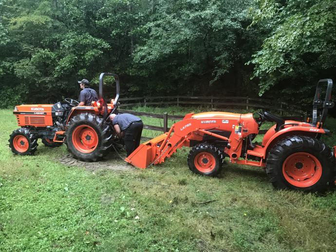

Recovery has not gone well, I suppose you shouldn't bring a smaller tractor without a front and loader to try and haul a larger tractor up a steep hill.
My tractor remains on the hill and they packed up their's to go back to the shop for a larger one. I suppose doing it on a super rainy day in North Carolina wasn't a great idea either.
Hand them a copy of this when they return.

Probably the 2 guys that will be putting a new motor in your rig:rolleyes:
33,383
8,695
I'm thinking it was the operator and his assistant that was the reason they couldn't get it to move.
That tractor looks plenty big enough to tow the other, it should be a free wheeling implement if they bothered to take the transmission and put it in neutral. :rolleyes:

Well from the looks of it the loader is down, So there is the loader drag, two the implement is down...more drag. YES that tractor can pull it free wheeled...but with all that other stuff dragging? :rolleyes:
With the engine dead how would you remove the loader and the implement? the first being the hardest.

I've had to pull a tractor with the loader down, it's really not to bad. The key is to get the loader off the ground. :) When I did it, we put the bucket into the float position. Managed to get a chain under the bucket, attached to the front of the tractor so as it tightened it would raise the bucket off the ground.
Put the tractor in neutral and away we went :)As long as it's in neutral, and not on a steep slope, it doesn't take much to pull one.
Chain under bucket of the loader to the frame of the tractor, that lifts the bucket off the ground, I block them once lifted.
another option is to use the three point and a chain to lift the bucket off the ground then block the loader.
Just about any three point implement can be unhitched when it's down, or a come-a-long off the ROPS will lift it right up. ;)
Getting a loader off a dead tractor is easy.
One way is to use a set of jumper hoses and use the good tractor to power the hydraulics off the dead one to remove the loader.
The other is 2 bottle jacks under the boom arms and off it will come.
Note: In the picture that was posted the extrication professionals (dealer shop monkeys) hooked the chain under the bucket but then hooked to the cross tube of the loader, rather dumb way of hooking up to it IMHO!

I know I'm armchair quarterbacking here, But based on the pictures i don't think they did anything like you mentioned based on the picture.
I've pulled a 20,000lb backhoe out of my yard with my little l1501 2wd. It was a John Deere backhoe. Was really kicking myself in the butt afterwords for not getting someone to take some pics :rolleyes:

I am sure the dealer will handle this in a professional manner .Some of the comments here are a little harsh . Two men trying to get a tractor moved . WE can not tell the true condition they are facing. Shop Monkeys Come on we are better then that.
James
You have never worked as a mechanic have you?
Shop monkey or Wrench monkey is what a dealership mechanic is called, it's not what I consider a derogatory term.
But On the other had, I can look at a picture and tell they don't know what they are doing! ;)
