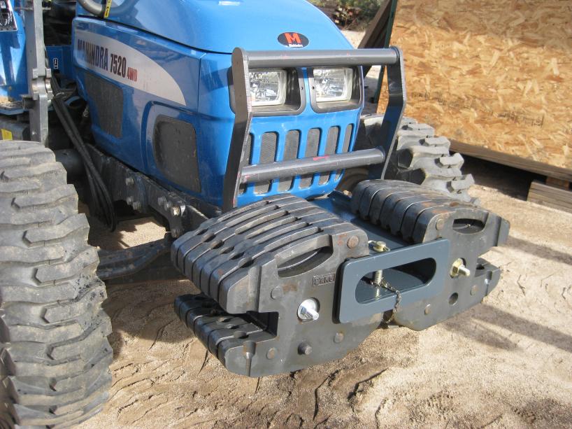

MtnViewRanch
Oct 10, 2012
719
176
Lakeside Ca.
That's the good thing about being a welder and having the equipment to fix/modify and fabricate as needed. Obviously had I known prior to buying it, I would have just bought a heavier box blade but I've got it and I'm gonna give it a try. On a different note im going to make mounts on the weights to hang them on the front of the tractor as well to aid in front traction when my loader is off.
Additional front weights, as in double. I love doing field work with the loader off. :cool:
