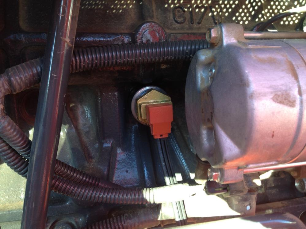

Hey all,
New to the forum, but not kubota tractors. I recently installed a block heater for my L2501 P/N 70000-00297. Got the number and part from my dealer in Cottonwood, AZ. Chose the middle freeze plug on the Left side just before the starter ( Instructions had NO preference for this model tractor). All went well on the removal, those little suckers are a little tough, but tapped it sideways and got a hold of it with pair of needle nose and a little twisting & turning finally got it out. Little red locktite on the bushing..... tapped in in with a wooden block, checked for spacing and teflon tape and screwed the heater into the threaded bushing. Let it set overnight and refilled the coolant and I seem to be losing coolant from somewhere other that the area I installed the heater! Now mind you when draining the coolant the radiator does not drain the egine block. During removal of the freeze plug it squirted just about everywhere. I ran the trator for a good hour until the temp gauge moved to make sure the thermostat opened. My big question is: Since there is NO SIGN of ANY leakage around the bushing with the heater......... where is this coolant coming from? I did no damage during the removal (except to the plug itself). I been watching this all day and still have drips on the oil pan and mounting surfaces. Is it just residual from the draining out the freeze plug. I'll post a photo..... any info would be appreciated!
