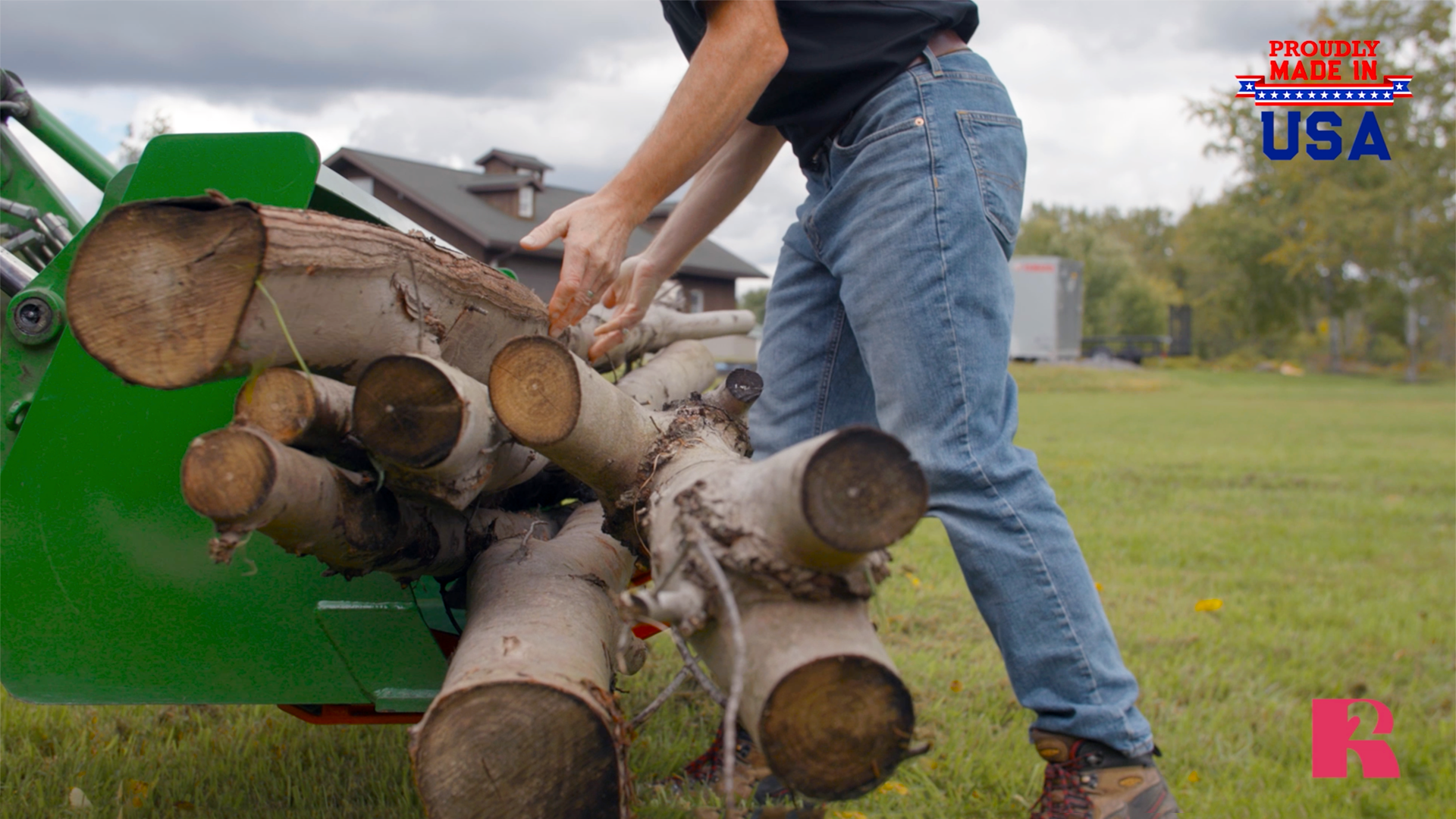

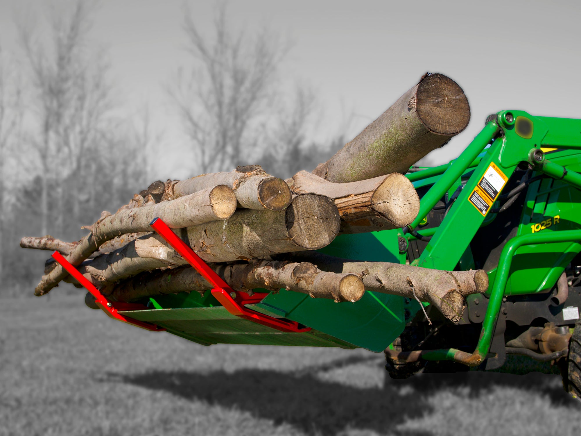

you can make/buy 'bucket extenders' to fill more LIGHT debris into the bucket..

Here's one way.
Bruce

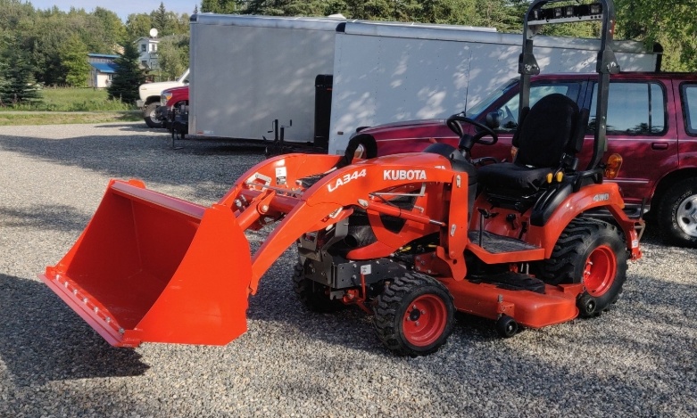

Kubota Dealer. It's the stock bucket off my LX2610. I've had a 72" Kubota bucket on order for my LX from the local dealer for over a month now so it does take a while to get one.

Specs on the B2371 are:
54" Bucket 175lbs
6.7 cu. ft. Struck, 8.1 cu. ft. Heaped
I have a 72" ordered that's :
L2236 72” Light Material Bucket 323lbs
12.7 cu. ft. Struck, 16.0 cu. ft. Heaped
