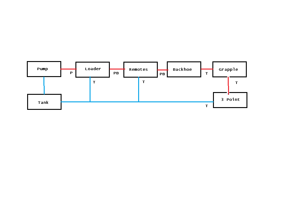

The grapple is not feeding the backhoe. That is the problem.
There is no need for a tank port to be rated at full system pressure.
I will draw you a schematic. High pressure in red, low pressure in blue. Both the backhoe and grapple are using the tank port for high pressure carryover. The grapple valve is rated for that - the backhoe valve is not. Move the grapple ahead of the backhoe and everything is OK because when the backhoe is mounted the 3pt is disabled.
6,015
3,252
Dan,
I would’ve expected that the backhoe would have a power beyond outlet port that went to whatever was down stream, and a return to tank port. Your drawing surprises me, but I have no knowledge of the backhoe control valve in question.
let’s say the grapple was not on your drawing and the backhoe fed the three-point directly. Wouldn’t the situation at the backhoe T port be the same, if the three-point hitch was run up to the end of the stroke and held there dead headed?
6,015
3,252
Second Question, how is the 3PH disabled when the backhoe is mounted?
I clearly see what you are saying if the grapple valve is moved ahead of the backhoe control valve assembly, and the 3PH is eliminated from the circuit, so that the backhoe T port goes into the return to tank line.
3rd question, if the the 3PH is out of the picture when the backhoe is on, why do you show it in the drawing? Just trying to be sure I am not missing something.
Edit: Now I will go back and read the thread again. I was having difficulty following what was being discussed, kept thinking how a drawing would help…(Did go back. Discussion makes sense to me now…)

Dan,
I think you are asking what I asked. While the explanations here make sense I still have don't quite get the 500 or so max number at the 3pt holding it and hitting end of stroke. Maybe it is internal design of the 3pt valve I am not aware of. I am OK with not getting it but glad to have read this discussion too.
Now I see what you're talking about, and it was EXACTLY the problem I was envisioning from the descriptions. Without some kind of pressure reducer, the only way to protect the BH is to make sure it's the last thing next to the 3PH. I'm still a little put out that 500 PSI valves are used on something that has a 2500 PSI supply. It ain't like they didn't know, nor is it really designed to fit any other brand of tractor that might not have that much pressure. Makes no sense at all, really. Why not size the hydraulics for the max system pressure?
