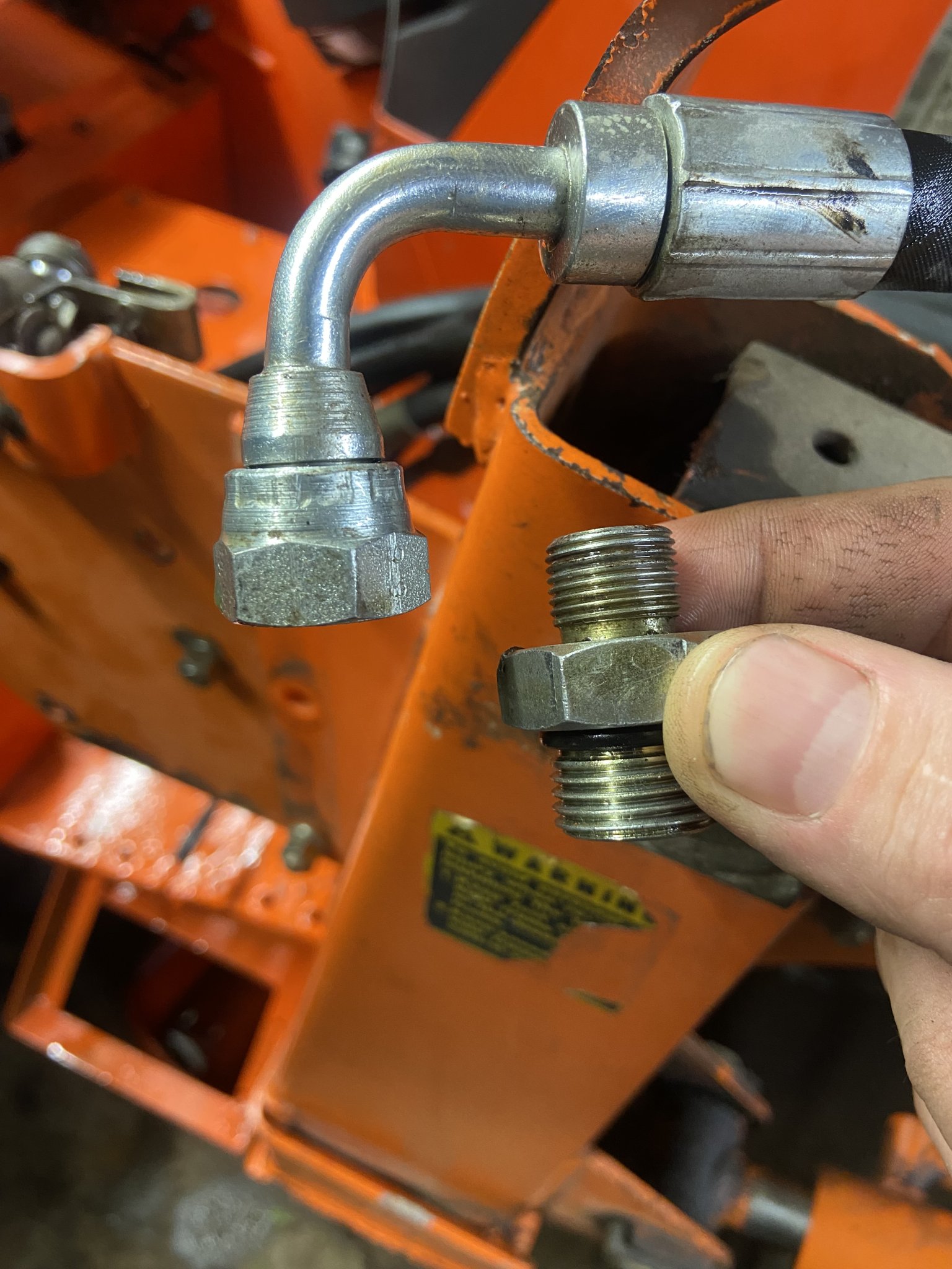

It looks like the hoses all have JIC female swivels which are easy to match. Looks like size is JIC-8 but you jeed to confirm by measuring the male threads.
The ports in the valve look like SAE oring boss. You would have to remove the existing adapters and measure the diameter of the threads. My WAG would be SAE-8 but you need to confirm.
None of those connections should have pipe dope,/sealant applied to them.

The loader does not operate smoothly and is sometimes dangerous as stated in the above post.
All fitting look like this. Just some are 90*.
I trying it find a place where I can find this to fit the 3/4”-16 and the 7/8”-14. Will have call around tomorrow. Not sure what size I have on the hose but gonna read about it and measure. I believe it’s an m16 but what’s the proper size and name I don’t know yet.
Do you know if I can mount this hoses right or left or it matters for the float to work on the down position correct?
