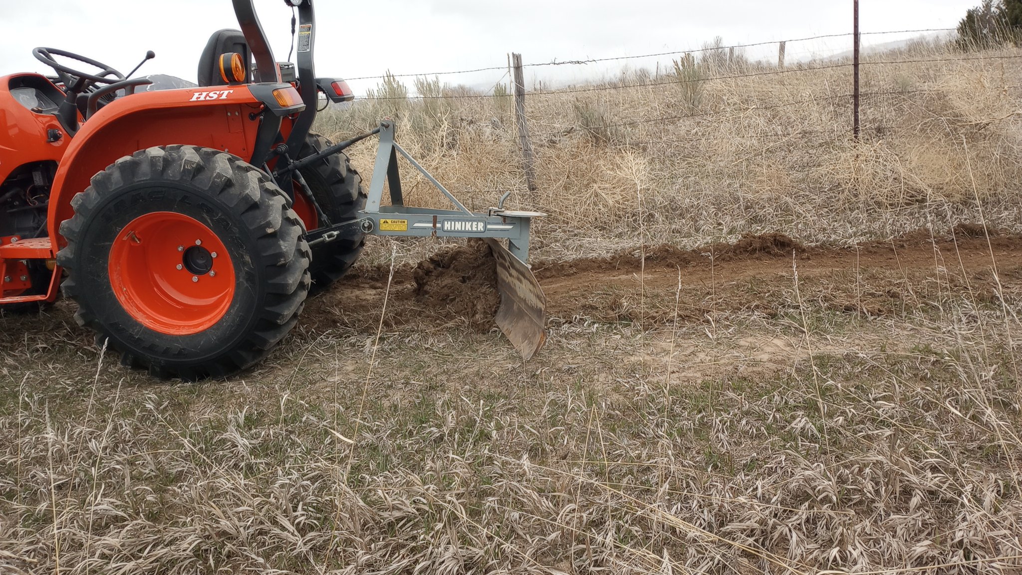

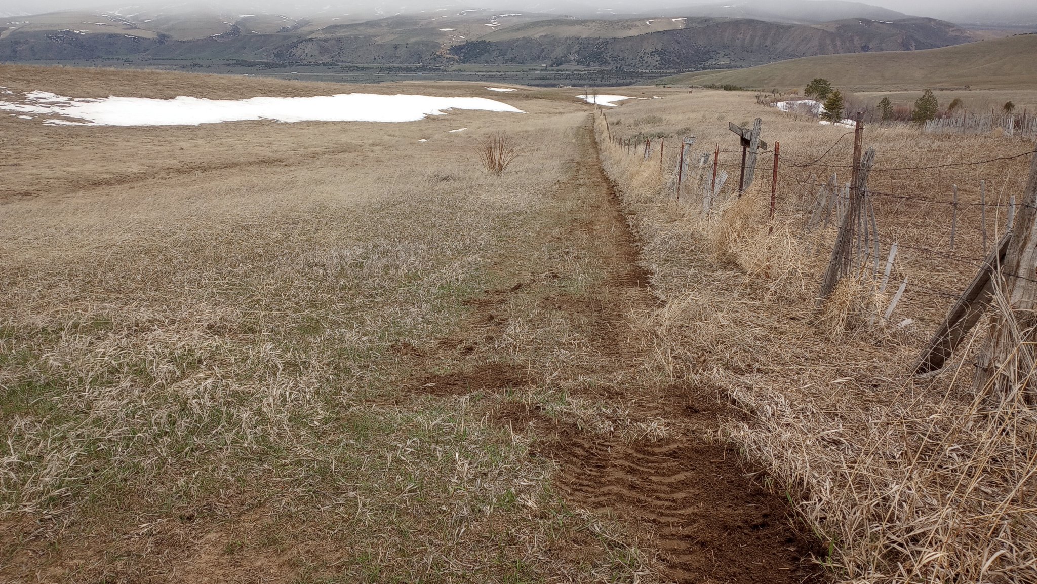

I now know the top link has a stop, as I ran it out all the way, with about a 4" drop to the side, and just a bit of side angle, too much was worse. What made all the difference was the second pass, that's when it started cutting in much better. Logic tells me more passes would result in more of the side slope being removed, but it started snowing and blowing heavily so I quit. All downhill worked. The one thing I really have to watch is creating an erosion scenario, so I don't want to make it level side to side at all. This will be a big improvement, as it took out some bumps also.

I now know the top link has a stop, as I ran it out all the way, with about a 4" drop to the side, and just a bit of side angle, too much was worse. What made all the difference was the second pass, that's when it started cutting in much better. Logic tells me more passes would result in more of the side slope being removed, but it started snowing and blowing heavily so I quit. All downhill worked. The one thing I really have to watch is creating an erosion scenario, so I don't want to make it level side to side at all. This will be a big improvement, as it took out some bumps also. View attachment 125732 View attachment 125733
This is where hydraulic tilt and a box blade with scarifiers would help. That's what I use to cut a level driveway. This is the perfect job for a bulldozer, but as you say, you want to use what you have.

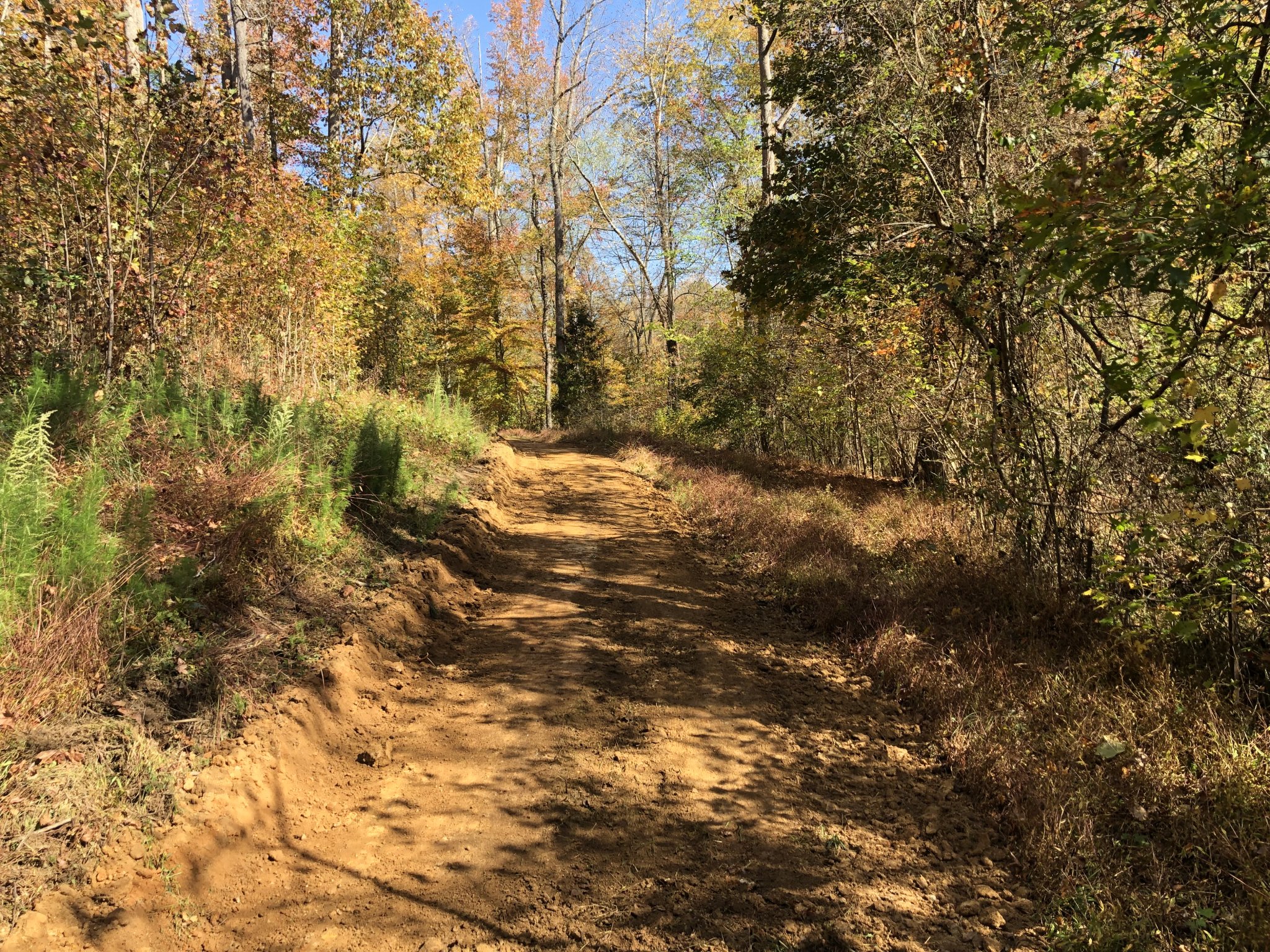

Cut a section to your liking with the box scraper. Get it flat. Go higher than you think on the low side because it will compact. Get the first section flat, large enough to get your tractor flat. Turn around and use the front end loader taking small bites and dumping to the low side. Keep your tractor flat and level.
Did it that way for years on very steep hillsides. The key is to not get to close to the edge, esp with a bucket full
Rear blades have no downforce and although they look like it's what you need. It isn't.
Or, rent a dozer and operator and he'll knock it out real fast.
You want to cut more than you fill. If you understand that. If it's real steep cut is everything. Keep your tractor on the cut only. Until it compacts.
Check this out. Minute 3:30 to 4:30 is the method.
