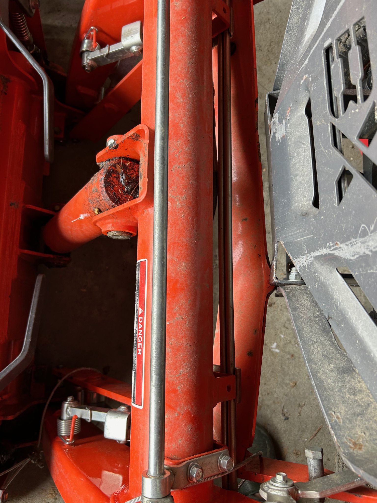

I guess I must have bent it a little at some point when trying to re-mount the loader, not going in square. The stand has bent more with use, the 90 degree bent piece that crosses by the hydraulic line. It's also twisted just a bit at the front left attachment point by the bucket. I've straightened the cross piece out a bit by pulling on it with a ratchet, but it bends again, worse.
I've currently got it held onto the left side of the main loader frame with steel cable and cable clamps wrapped tightly around it. Without that it will pull off at the front attachment point.
I guess I get a new stand for it. I assume this is a reasonable DIY replacement?
I've worked this little loader hard at times. I commonly move a few very large diameter logs at a time, and in winter, besides pushing snow around (on a sometimes uneven gravel drive), I move piles that fall off the metal roof. These loads of wet snow are at the limit of what the loader will lift.
I guess besides the DIY question, I wonder if I get a new loader should I find someone who welds and add some reinforcement to the cross piece, the one that is angled and runs along that hydraulic line? That is the main bend now, the weak part, but it has also twisted slightly where it attaches near the bucket.
I'm pretty surprised it hasn't held up. 100 hours on the tractor. I don't know if it was slight damage trying to re mount it -- assuming that -- or not holding up to use. I know it's the lightest duty tractor/loader I could get, but I'd still assume it would hold up generally to anything I'd do. I'd like to say I'll just be more careful re-mounting it, but that can be hard sometimes. I find it either takes about two minutes to re-mount the loader, or 25 minutes. The loader usually stays on, but during mowing season it's mostly off.
And a bit worried there might be something wrong with the loader itself, structurally. It seems it should have enough torsional strength that it wouldn't depend on this thin stand for any rigidity. It should be firm on its own and not bending anything. Maybe I should have the dealer come out to look at it. They do housecalls.

This would be clearer if I started it and lifted the loader. This view from the top. You can see the bent part down under the front grill guard. Maybe I should start it and get it up to eye level.

Yeah, I know where to straighten this one -- but I think it is much weaker for having been bent a few times. I guess if I keep the original one I would find a welder to add a strengthening element to it, or else drill and bolt on some kind of reinforcement.

Oh no, it's not bending while stored. It was initially bent a bit while trying to attach the loader. With use, the bend has become worse, the metal weaker. I assume now it bends with perhaps normal torque of the loader in use because it is weaker on account of the initial bend and repeated bending. However, I worry there is something wrong with the loader that it might be squeezing it harder than normal, and thus bending it. I can't really tell why why it bends now, but I assume and hope it is because of the initial bend/then weakness. I've ordered a new stand from Messicks, and I also ordered the dolly for removing/storing/attaching it, with the idea I won't bend it again while trying to mount it in my garage bay. We'll see. I'm also going to bolster the new one before I put it on, by bolting some extra steel onto that part.

To follow up: I got a new stand. Bought a 90 degree bend length of steel and a steel rod (maybe like 3/8 diameter). I cut them to length, used JB weld to glue that rod with a bit extra around the edges in the L piece and clamped them onto the new stand where the old one bent (along the whole cross piece), mounted it. It was pretty easy to replace. Then I drilled through the stand cross piece and the new brace piece in about 5 spots, bolted it, gave it a few days to dry.
Since then I've used the loader a bit -- scooped some wet muck out of a ditch, moved half-dry split firewood, some loads of mulch from a pile to the garden a ways away. Not a bit of bending.
I'm guessing that bending the old one in attempting to re-mount it and then straightening/re-bending it made it so weak it easily bent when using the loader much at all. I think if I don't bend the new one while mounting it (I've got the dolly on order), it won't be a problem again.
