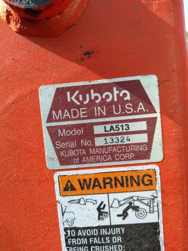

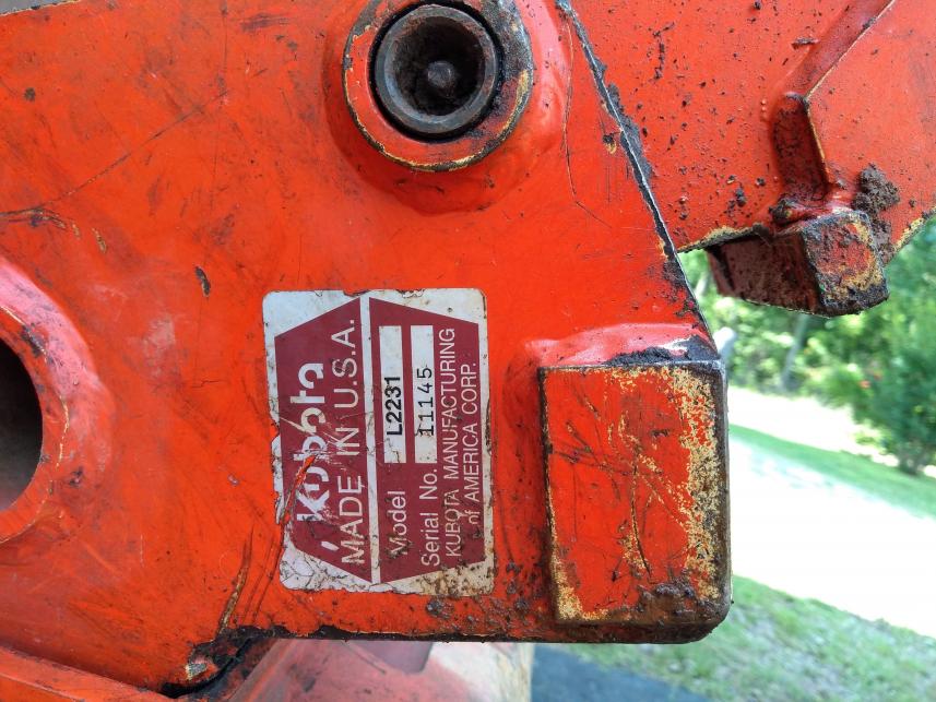

I have seen others with this problem in the past. My dealer isn't too excited to help with the issue, understandable since I'm the 2nd owner & the tractor is 13 years old. I feel like Kubota/ the dealer has the responsibility to make it right since they're the one that sold it with the wrong part. Here's the story... I purchased a L3430 from a widow woman. Her husband worked at the Kubota dealer before he passed. He traded in a L2500 on the L3430. At the time the name of the dealer was Perrin & Gray Tractor. At some point the name changed to Gray Brothers equipment & that's what it is now. I've owned the tractor for about 4-5 years. I've used it to clear brush, brush hog, move dirt etc. Been/is a good tractor. I noticed the cyl leaking on the bucket the other day & thought no big deal, it has 1260hrs & I've used it fairly rough at times so I'll pull it off & get it fixed. $417 later the hydraulic shop says the rod was bent & before I install this cylinder be sure to check for binding. I check & sure enough it's hitting the loader arms. I call the dealer, tell them the issue, give them serial# & they verify it's the wrong quick attach on the tractor. They do some checking & say it should have a L2230, which is no longer available. It is now a L2230A, which won't work because of the serial# split on the La513. They're not admitting they/someone messed up when they sold it & since I wasn't the original owner I can't prove it wasn't installed after the original purchase. In the end I just want it to be right & not bend the rods again. If I spend a total of $1500 to fix the issue that Kubota installed incorrectly it sure puts a bad taste in my mouth. Here's pics. Anybody know what QA is needed to work?

Now complaining about it won't do any good, fixing it will, and it won't cost anywhere near $1500 to fix it properly.
It's a simple fix, weld a couple of blocks onto the loader stops so the SSQA stops before the rods hit the arms. ;)

Why are the rods bent? I see bent rods all the time and a large majority of the time it's due to asking more of them than they're designed to do. It's not that hard to bend a 1 1/2" solid steel rod if they're fully extended-which is what I see a lot of. Some folks use the bucket for grading, curl the bucket all the way forward and back drag. Snag a rock or root and the rods are very likely to bend. Not saying that's the case here, but that's what I see a lot of.

Kubota doesn't install loaders unless it's ordered pre-assembled. I NEVER saw a pre-assembled L3430/LA513, I did a ton of assembly and loader installations on those. I remember quite a few subframe bolt hole threads having boogers in them and having to buy a M16-1.50 tap to clean up the threads. That's why I asked if the SSQA was installed at the time of tractor assembly & prep, or was it done afterwards. You may never know as the dealership's ownership changed, and when that happens...or if a business system changes....history files can go away. Kubota may have record of the contract, though but unless the dealer is willing to look that up for you, Kubota is not going to give it to you because you are not the original purchaser.
