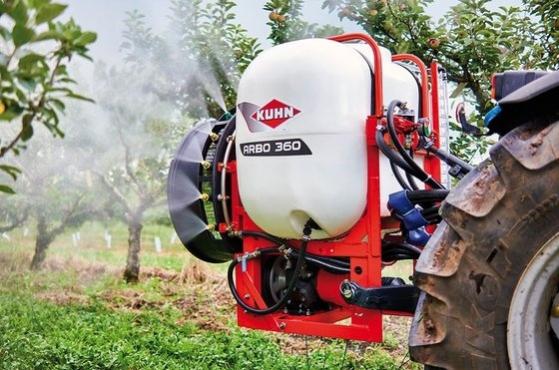

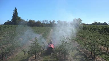

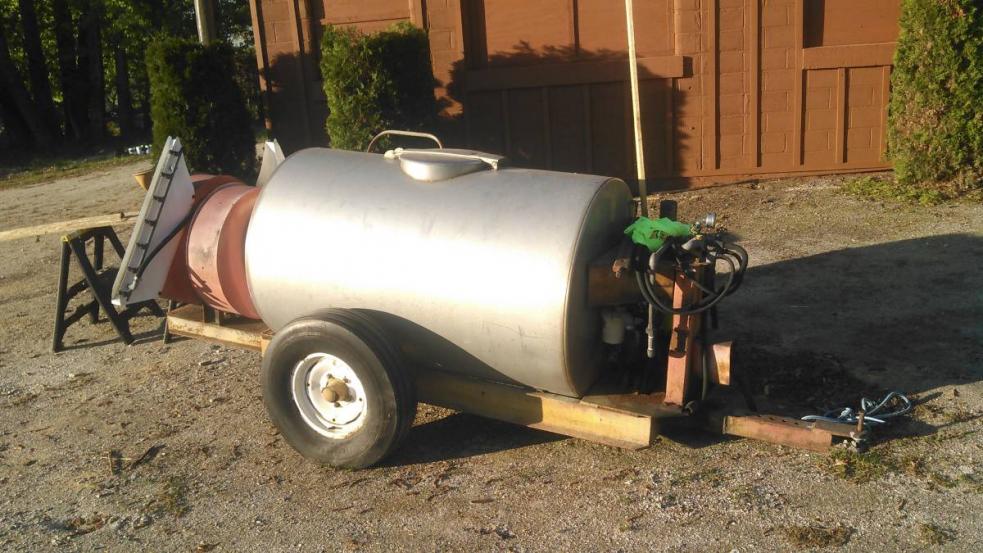

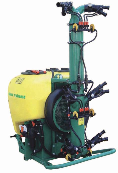

I an not anti herbicides and other spray that people traditionally use in a vineyard but I am extremely opposed to excessive or wasteful spraying. We are surrounded by cherry and apple orchards and I despise seeing them blasting their chemicals high into the air. See Pic 1 There are some attachments to these sprayers to minimize the overspray but they do not address my need for two seperate heights. See pic 2. Also, these traditional trailer sprayers are way to big to make the turns I will have at the ends of my rows. They do make smaller 3 point mounted air blast sprayers but they are expensive and do not address my alternating row heights especially since every time I make a turn the high and low rows will alternate. pic 3 I have also seen some veturi based 3 point sprayers but this is new technology and is off the charts expensive. pic 4
