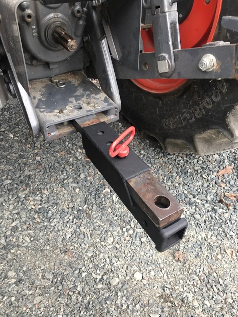

i would buy or build something like this. You could cut off the 2 5/8" ball and weld on a plate with a hole for towing pin on implements.
