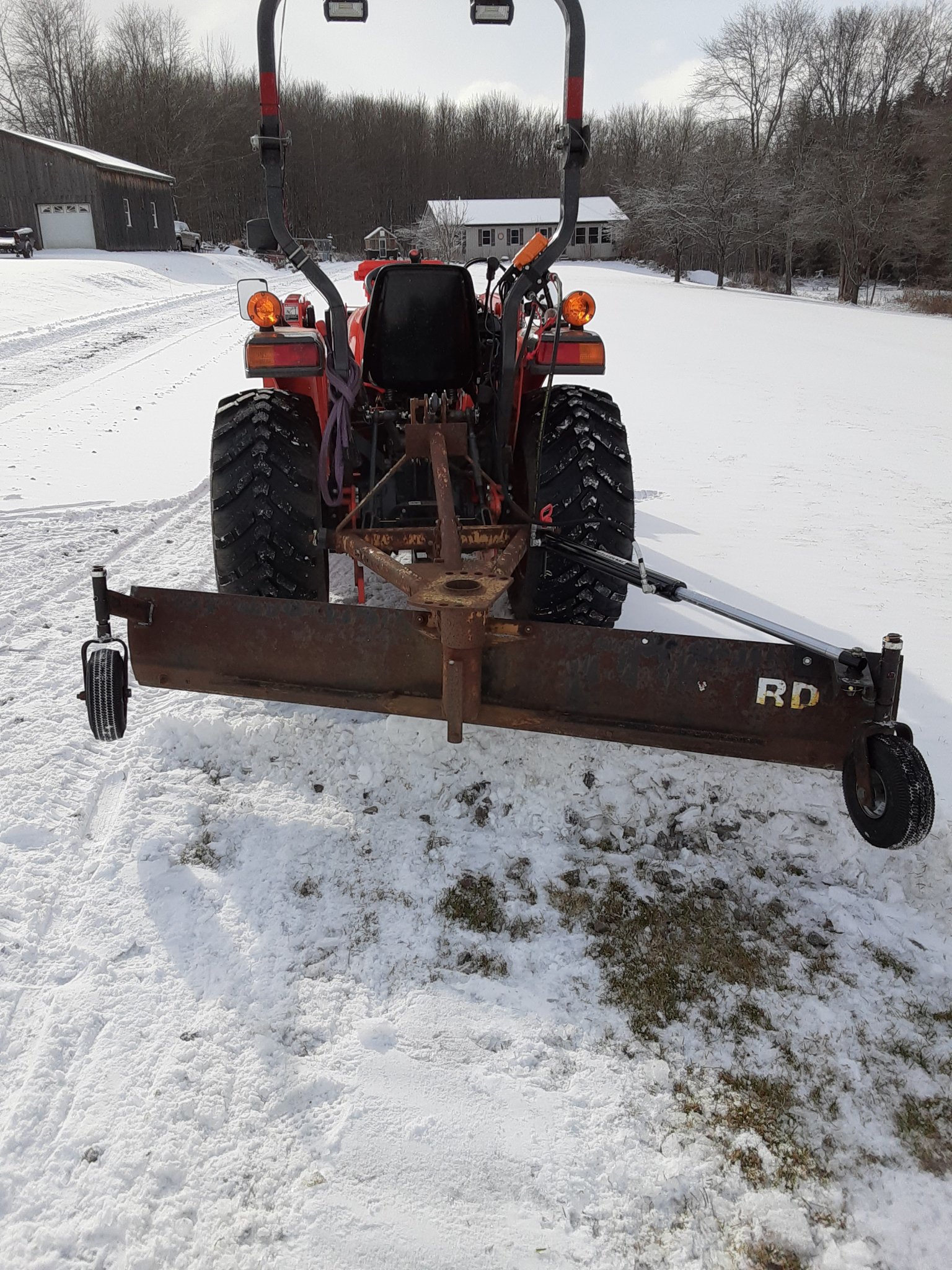

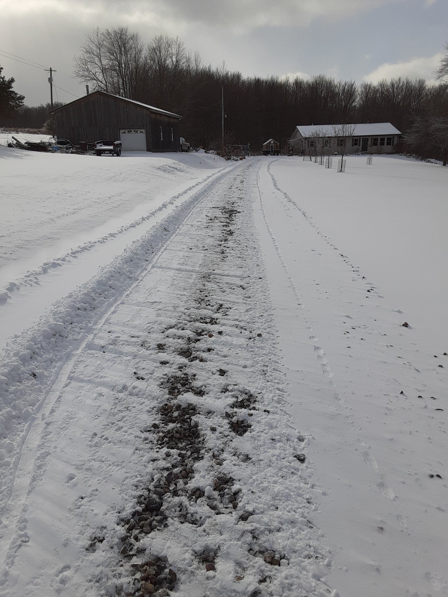

I have a 300' plus drive and put down some more stone this year. Bought it from the same place but it seems larger and not packing down as good. I usually plow with a front blade on the 8N but tried a while back and until it freezes more it was moving a lot of stone to the sides. I had this back blade for the 8n and some wheel brackets from an old 3pt finish mower. I figured if the wheels could keep it up an inch or two it could do till it freezes and if more snow back to the 8N. The wheels are adjustable with spacers but need new tires. Rather than get the HF specials I bought some better ones from zoro for about $20 each. The are rated at 30 psi and 400lbs each.
Tried it today and it works quite well. Was able to also do some along the edge of the woods, about 700' for dog walking. I made it hydraulic angle for the 8N but not wanting to mix fluids I bought an extra cylinder and with 2 pins to swap out and it is the same one I use for my LP stone rake. The one drawback with it right now is I can't reverse the blade to bush back. I need to make another bracket for the cylinder or remove the cylinder and use the pin manually to angle.
I paralleled the 3rd function valve to the back along with a switch paralleled too. That is the yellow box on the right roll bar.It allows me to change the angle from there while i am turned looking back. It is the same connections and switch I use for the hydraulic thumb for my BH77. The box is magnetic but so far it works good there for the backhoe too.

Looks good!! I was thinking of doing something like that for my front snowblower for spring/fall.
How exactly do you adjust? (is it a pin or screw thread?) - close up of one wheel would be appreciated.
Well done.
Well done.
Thank you,
If I remember later I will get a picture. But they have spacers on the pivot shaft. you move them from top to bottom of the mount. there is 1/2", 1", and 1-1/2" approx so I can raise it about 3" total. I welded the mounts on with the blade leveled and with no spacers and wheels touching the floor. To make it level if I change the spacers much I can level with the top link so the wheels pivot mount is vertical and pivots smoothly. There is a 3/16" hole in top of spindle for a hairpin clip or cotter key.
the wheels are 10" pneumatic tire.
Bill

Excellent work Bill. Very utilitarian and basic. (the best kind of engineering most of the time)
I appreciate the extra details. I zoomed in but couldn't make it out. I have similar wheels here just
mounted to a pc of plywood that I used for a little "trolley" one time, but it never gets used, so thinking
of repurposing them.
I had considered maybe those jacks from a trailer, you can buy for $45-$50 to make adjustments quicker, but seems like you've solved it w/o all that cost and fuss.
2 thumbs up from me !
