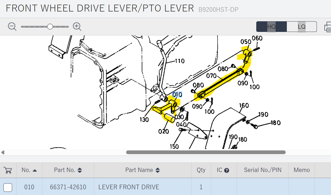

On this recently acquired B9200HST, I found the the 4wd engage lever is frozen stiff. I applied rust buster over a couple of weeks and finally just enough heat to be able to remove the lever to see if I could get more penetrate i there, no luck. I purchased a Kubota B9200HST WSM (97897-10131) for this tractor and cannot find any reference to this lever or its mechanical makeup.
Can someone tell me what I should be looking for and/or any fixes, troubleshooting or remedies that I can perform to get this into and out of 4WD without breaking anything? Thanks for the help

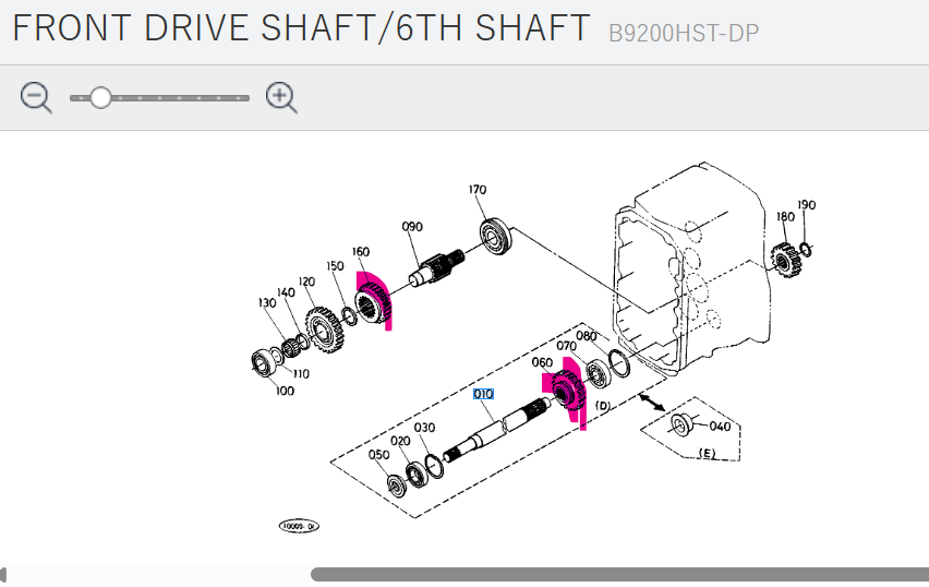

Should be in your manual. When I get a chance I will look at the one for my B7200 - I expect the mechanism is similar. I have had mine apart but it was a long time ago. IIRC its just a sliding gear or collar.
