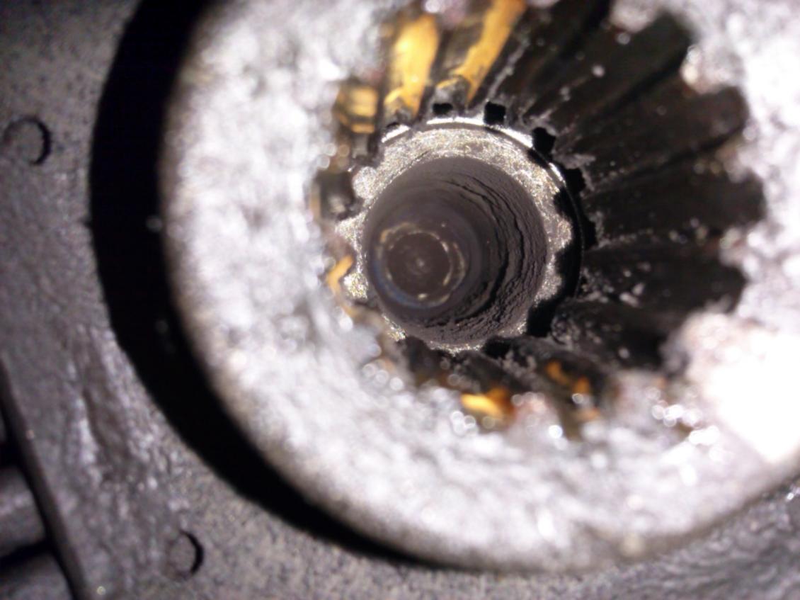

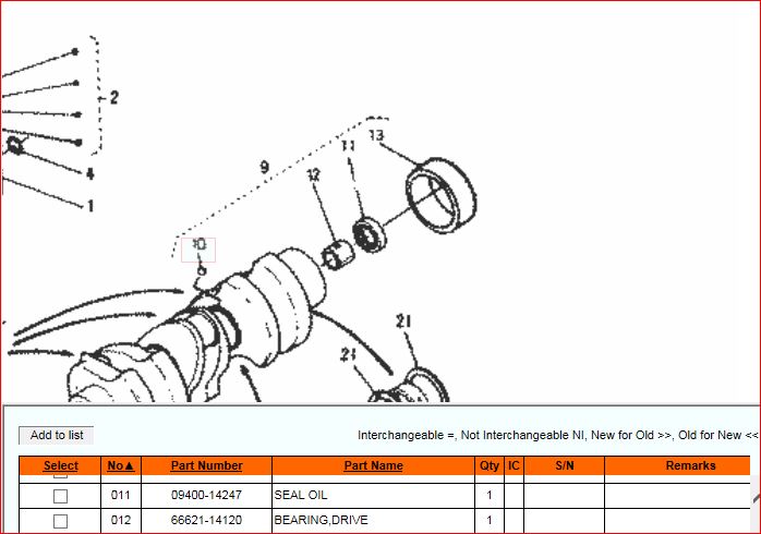

Please repost a less fuzzy pic of the end of the transmission input shaft, that will tell us if it has a pilot bushing / bearing (#12) or not, most if not all of those models did. ;)
Also replace the seal #11 while your at it. :p
Thanks, yes I am going to replace both front and rear oil seals while its this far down. I cleaned everything the best I could and took some better pics that will be posted shortly.

Make sure before you put everything back together that you check the pilot bushing/ bearing in the end of the crankshaft. Sone use a bushing, some use a roller bearing. I am not sure of when the change was made. If it a bushing it probably needs to be replaced. If it is a bearing it could be ok but I would replace it anyway.
Thanks, Yes I am going to replace everything clutch related. Everything in there is contaminated with oil. I've already ordered most of the parts excluding the pilot bearing as I'm not sure what's in there now.

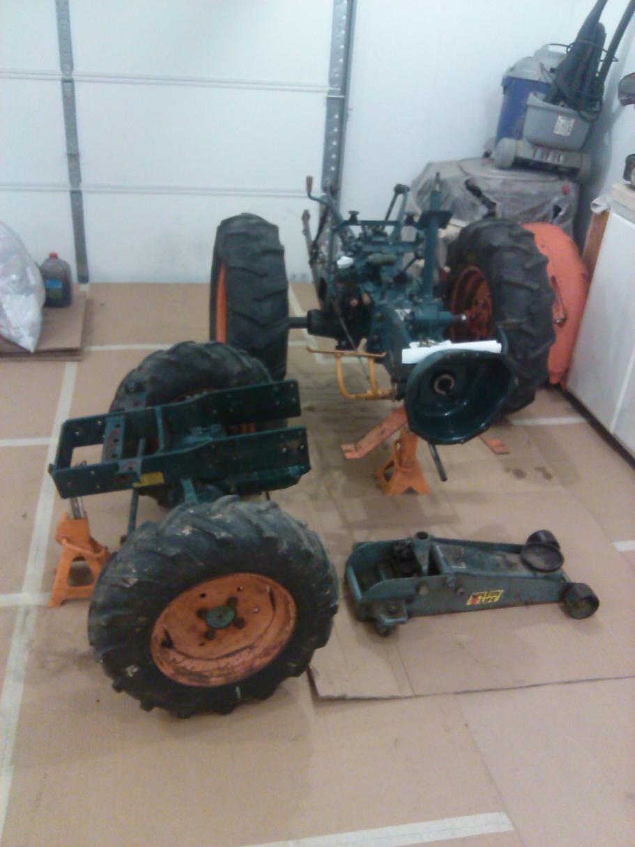

Alrighty here's an update. Removing the engine tonight and hope to have the oil pan off. I want to see what went wrong in there and get it fixed.
The throwout bearing is trashed. The clutch assembly is heavily contaminated with oil. Everything will be replaced. Both front and rear oil seals will be replaced while its all torn down.
I've already ordered a bunch of parts and a list of things I still need. Is it OK to reuse the old head bolts or should I get new ones?
