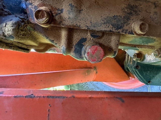

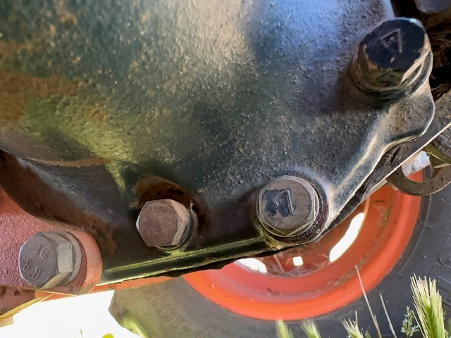

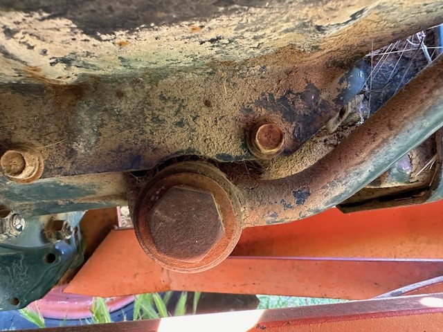

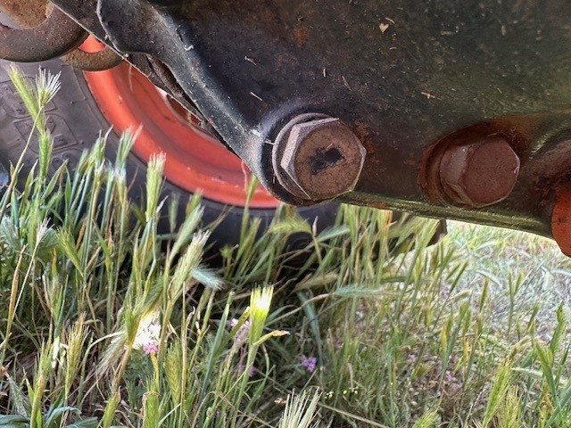

Thanks everyone for your answers. I'm blaming the old shifter boot. @wolfman - are these the 4 drains you mention? The red bolt on the left side doesn't have a screen. My parts list shows only one screen on the rights ide but I've seen posts with 2 screens.
29,000
5,337
Yes that's all the drain on the rear.
And yes the DT has just the one screen filter, where the HST has 2 screen filters.
