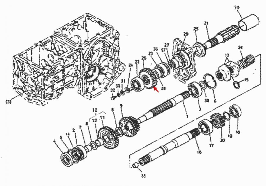

Ok, managed to press the gear and bearings off. When I pressed the gear off the back bearing and the gear flew off so I wasn't able to take note of their orientation.
In the attached image, for the spur gear #26, which way should it be oriented? The gear has a flat side and a side with a ridge, the image appears to show the ridge facing toward the front of the tractor but I want to be sure before I put it back together. Should the ridge on the spur gear face the front of the tractor or the rear of the tractor?

Yes ridge is towards the bearing. ;)
Very insightful sir, thank you
Actually if I zoom in on this picture it shows the ridge facing towards the front of the tractor (or toward the rear bearing). As for how far to press everything on I am lost, I wish there was some documented clearances. Given how little space there is for any clearance I might just have to go with equal spacing unless someone has a better idea.

Just a note:
You can't look at lsmurphy's pictures and expect them to look like the way yours will look he had to use a different gear that what is normally used, if you note the width of the gears are different, and if I remembered right he had to swap the gear direction around to clear the case.
lsmurphy has a B7001 not a B7100, there are a few minor differences in the two and that gear arrangement is one of them.
Kubota's norm is for the ridge on the gear to go towards the bearing otherwise the outer edge of the bearing and not the center will hit the gear.
Also as far as getting it set right, they normally make it relatively impossible to over tighten the setup.
The sleeve after the gear is also a stop that keep the gear from being set to far in.

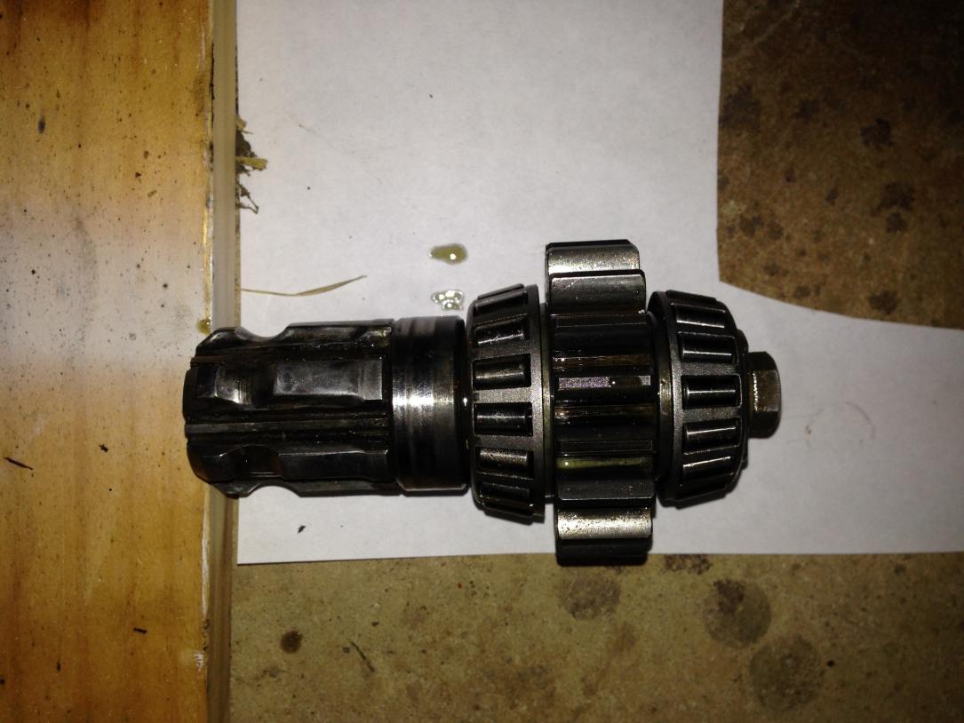

Just a note:
He used a different gear on the lower shaft, the PTO stub appears to be stock
There is a bearing on both sides of the gear
I pressed everything snug to see if I would have any open space and there is absolutely none to be had, if I slacked off on anything the shaft would protrude from then end of the bearing and it wasn't that way before. (see image of new bearings pressed on) One thing I did notice, before I pressed the old bearings off was that the spur gear had a very small amount of play, after I pressed the new bearings on there is no play in the spur gear at all.
29,226
5,512
Sorry I got it turned around, but it looks like you have it set to install.
