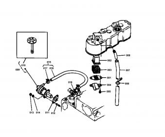

Is the part that needs to be cleaned #003 in the attached pic?

Yes, clean #003 this is the wire mesh.
also clean #001 the bottom plate with the drain holes.
On the old auto diesels these should be cleaned every oil change. The baffle is there to catch the oil mist made by the valve train and drain it away from the vent tube.
High blow by will over power this baffle and push the mist into the tube allowing oil to drain from the tube.
Try a test and extend the tube up into your view. Work the tractor and watch. Under certain loads/conditions does the tube start blowing oil?

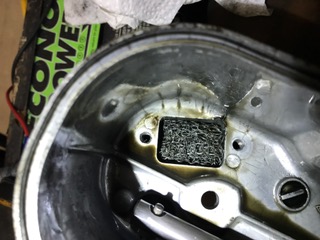

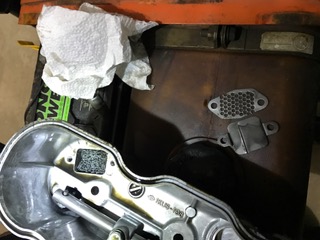

I pulled the valve cover and pulled #001 and #003. They were completely clean-not a spec of dirt or carbon.
I ran the engine at idle and high speed with the valve cover removed. The only oil flowing was through the lifter arm journals. No oil was being blown up from the valve rods.
One idea. I've been using the synthetic rotella oil the last two oil changes. Since this is a machine from 1976-would non-synthetic oil maybe prevent/reduce this?

Everything looks very clean. Did you clean the wire mesh? The mesh is very dense and you really don't know what is inside. Clean on the outside and solid on the inside! Maybe not, but you do want to eliminate the part 100% from further consideration.
Sideofabarn
B7100
Jul 29, 2015
38
parkton, MD
Jeff-Yes-cleaned the wire mesh but there was zero carbon or dirt in it to begin with. I just put it back in place before the pic.
