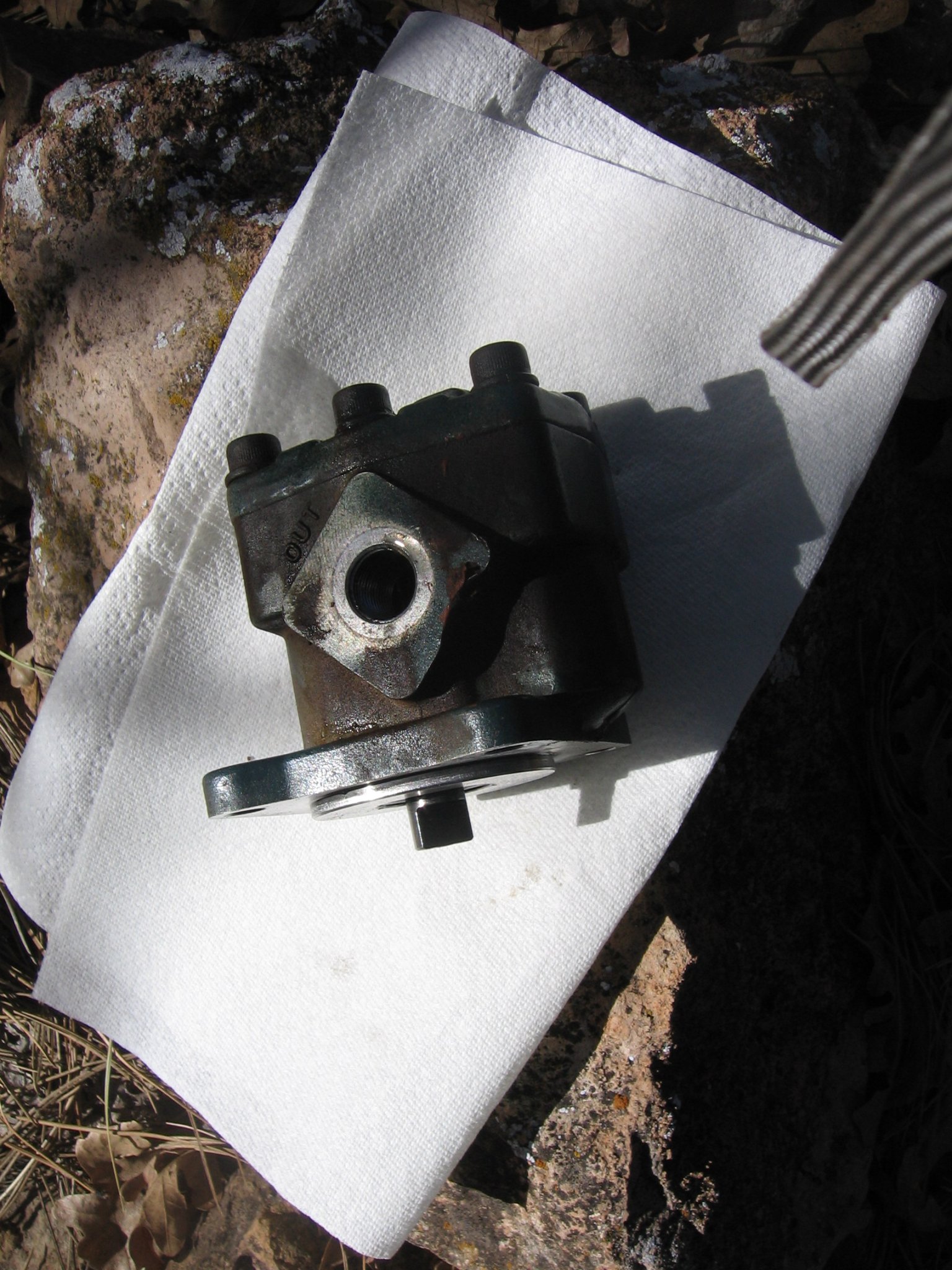

I had the same problem on my L185 and the repair was fairly simple and straightforward.
There will be o-rings inside the pump that you might want to replace while you’re in there.
There are probably some o-rings between the pipes and the pump housing that you might also want to replace. Probably none of them really need to be replaced.
It looks like there is only one seal available so that makes it simple. On mine there were three different seals depending upon the serial number and the pump was not original so it was a guessing game but it was obvious when the correct seal was received since it fit!
Use clean disposable aluminum pans to work in and use clean rags to cover up the parts if you don’t get it back together in a reasonable amount of time (2-3 hours??). Use clean rags to keep the oil under control, it will want to get everywhere. Using di gloves will help.
Buy a quart of your hydraulic fluid to use to lubricate the pump parts as they go back together.
If possible try to get the pump lubricated by putting some fluid in the top port before installing the top pipe.
And don’t be over zealous on tightening up any of the bolts. They are all pretty small diameter and the pum case might be aluminum.

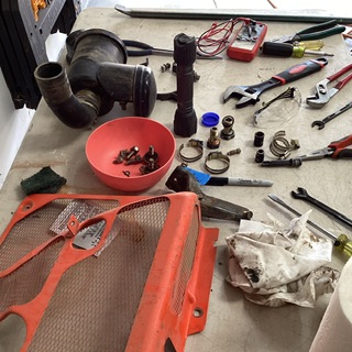

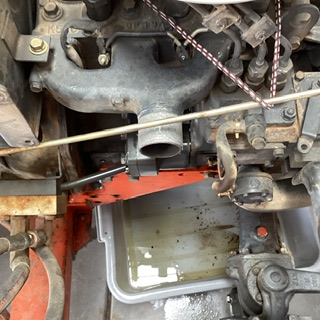

All of this would be a lot easier if the FEL was removed.
This was torn down at the cabin, 150mi from my shop, so limited access to tools.

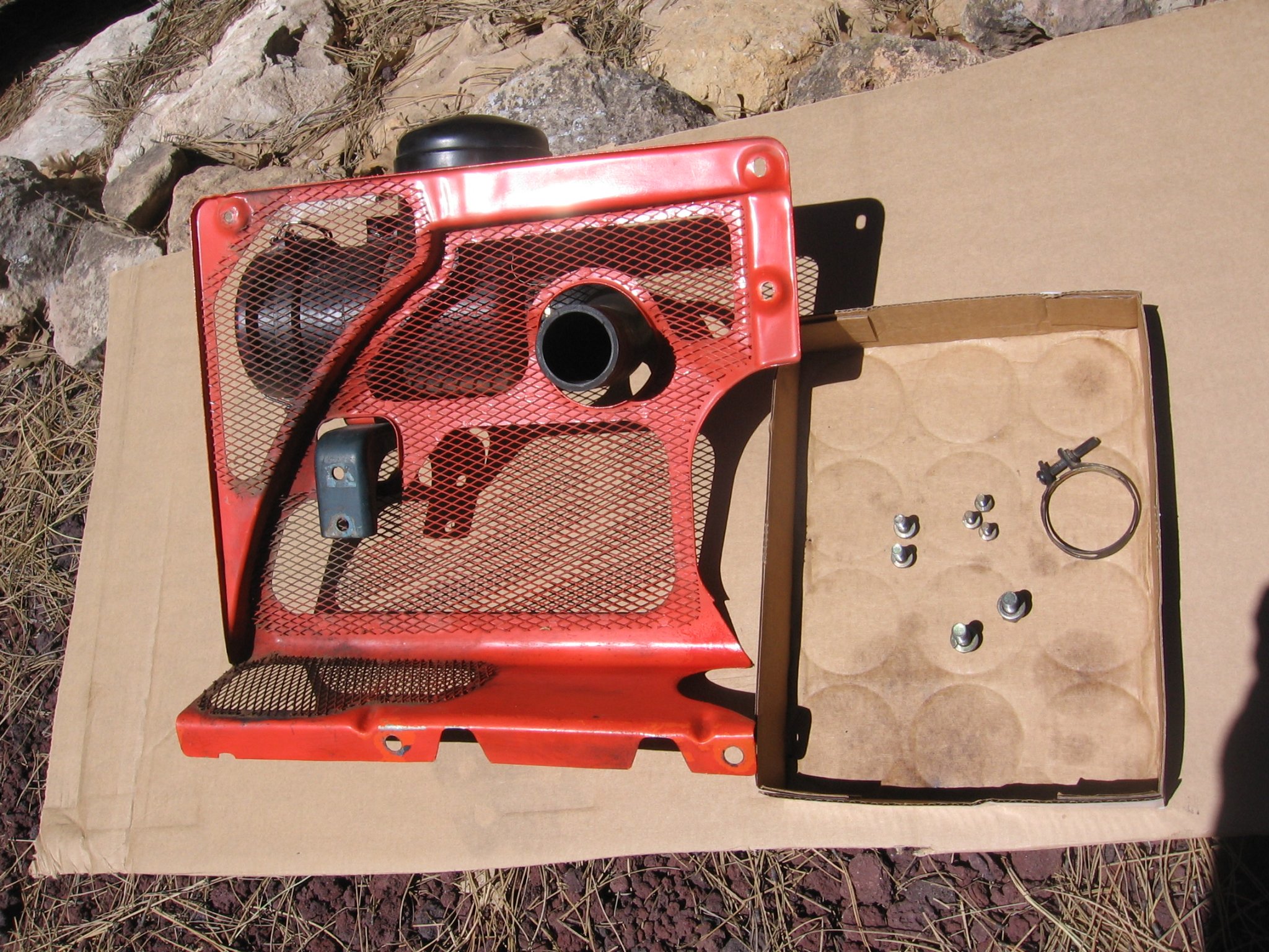

Engine oil drained, oil filter replaced.
Engine side cover & air cleaner removed.

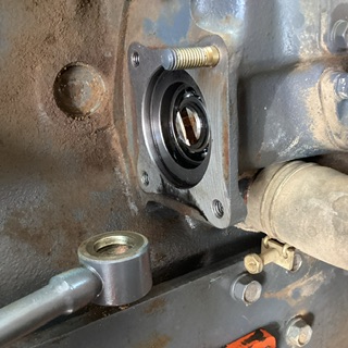

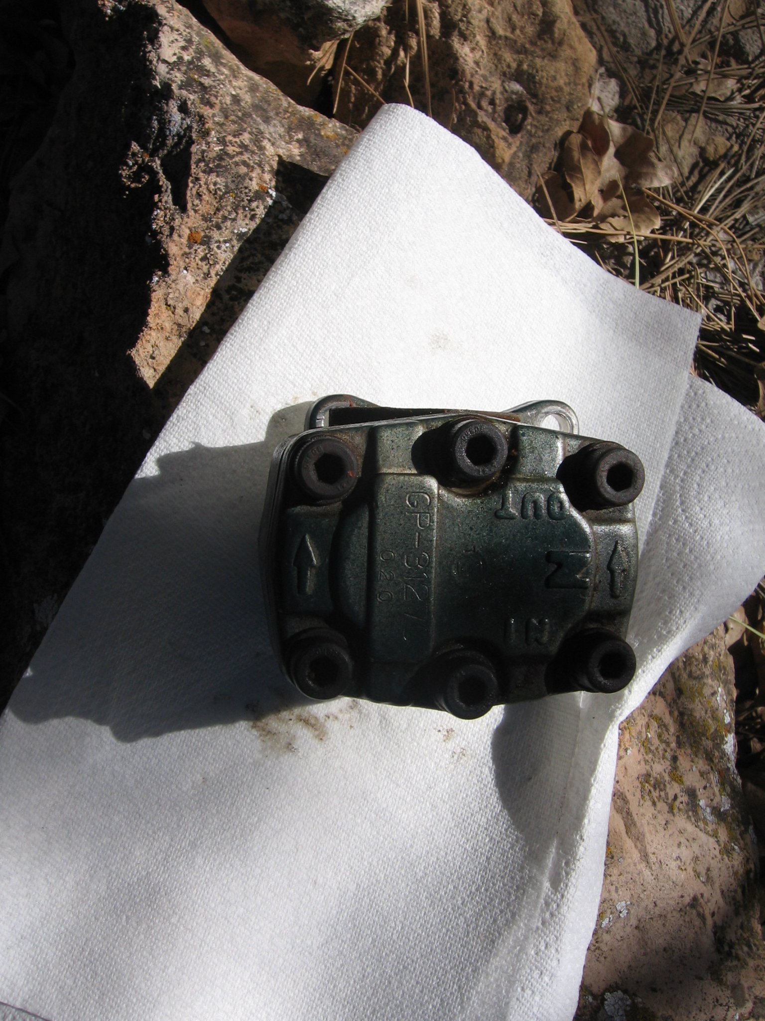

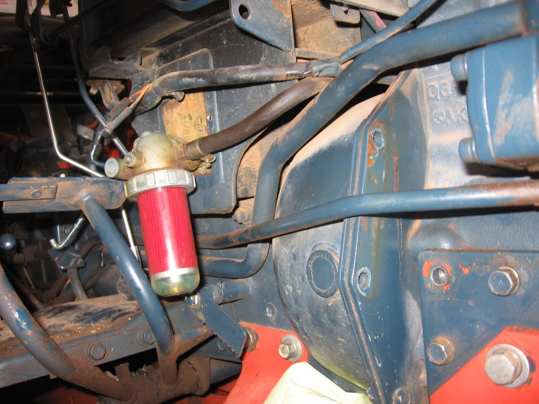

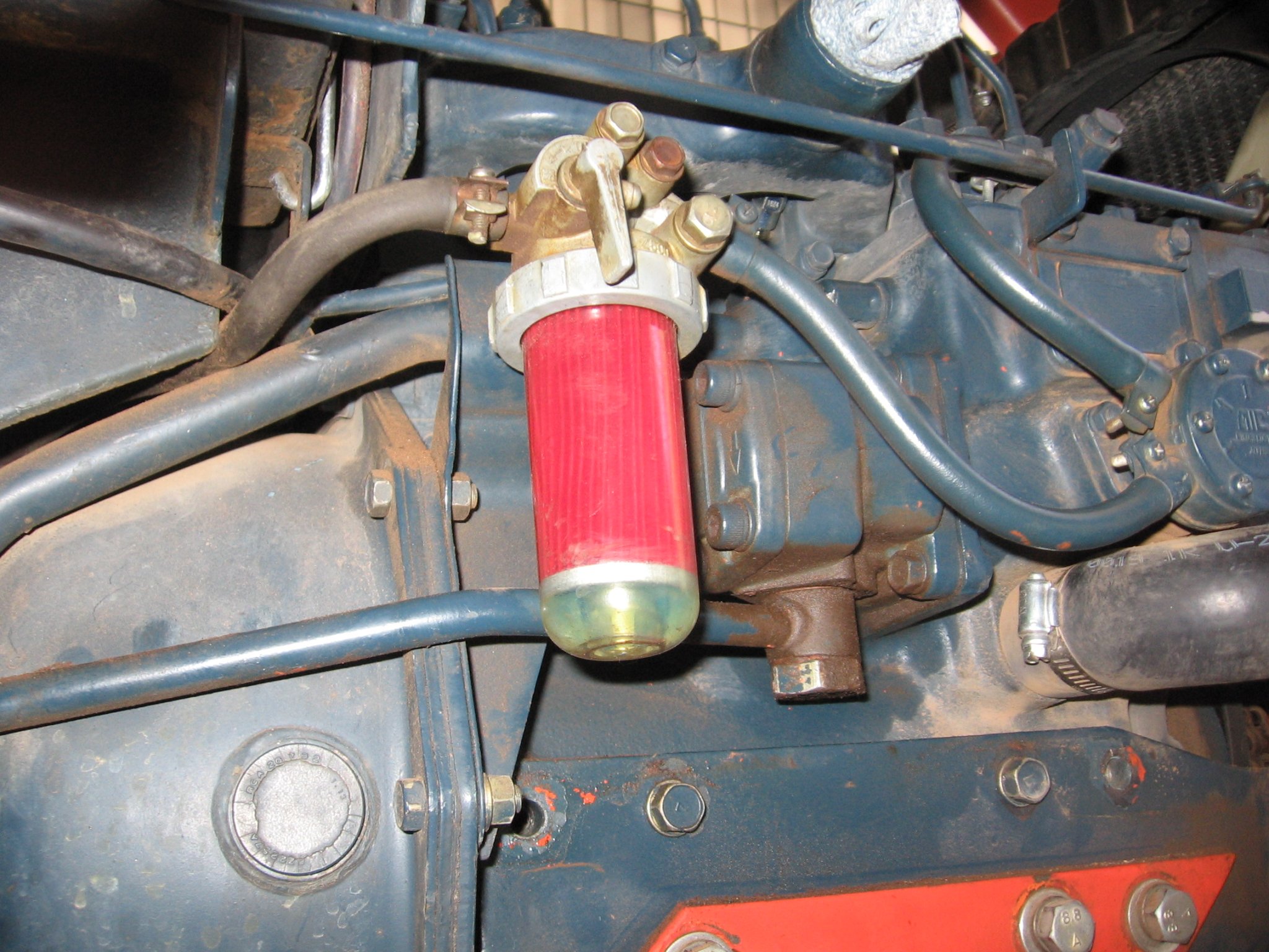

Views of the pump.
7,305
2,260

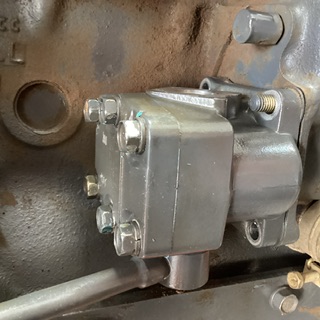

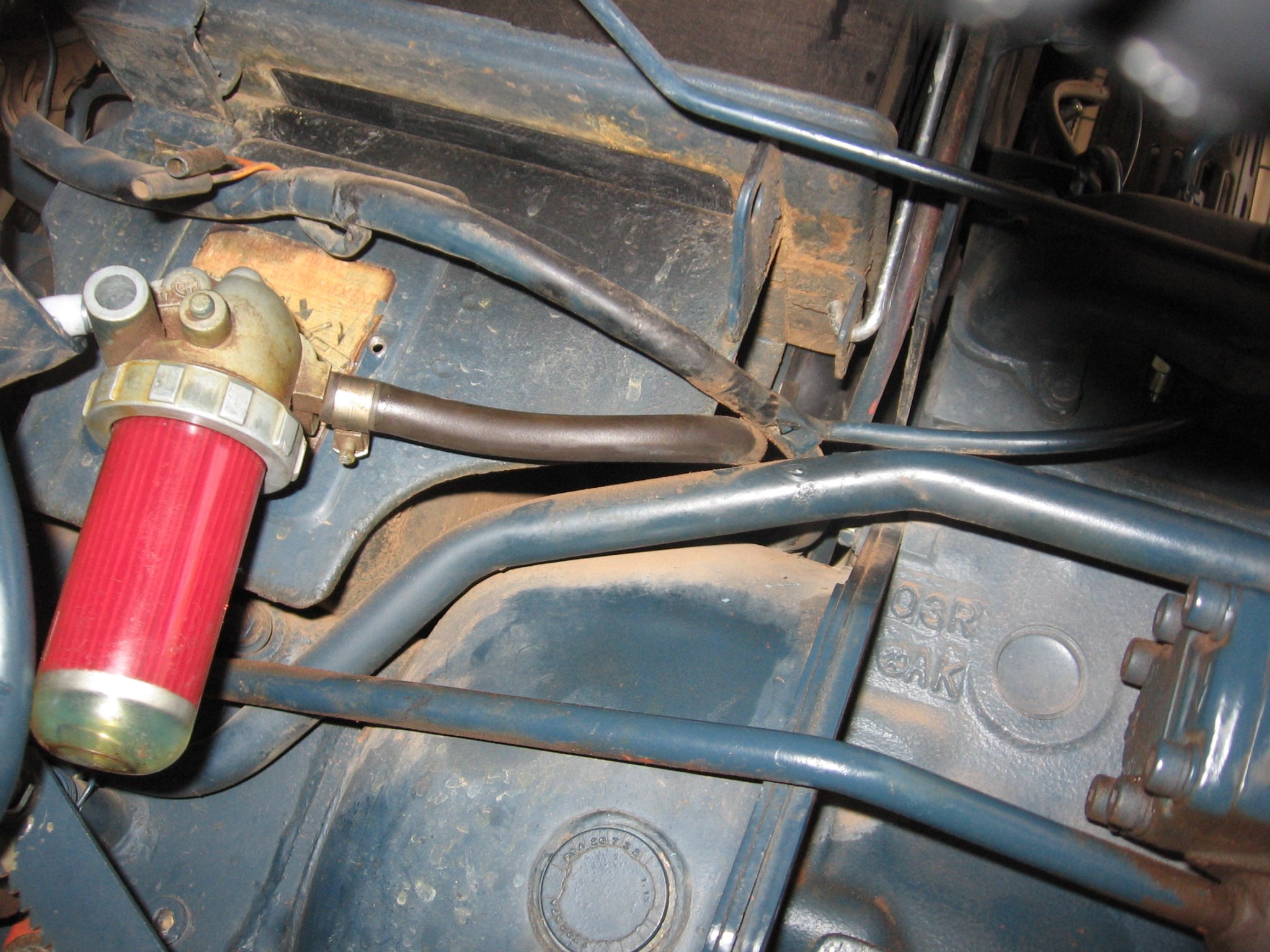

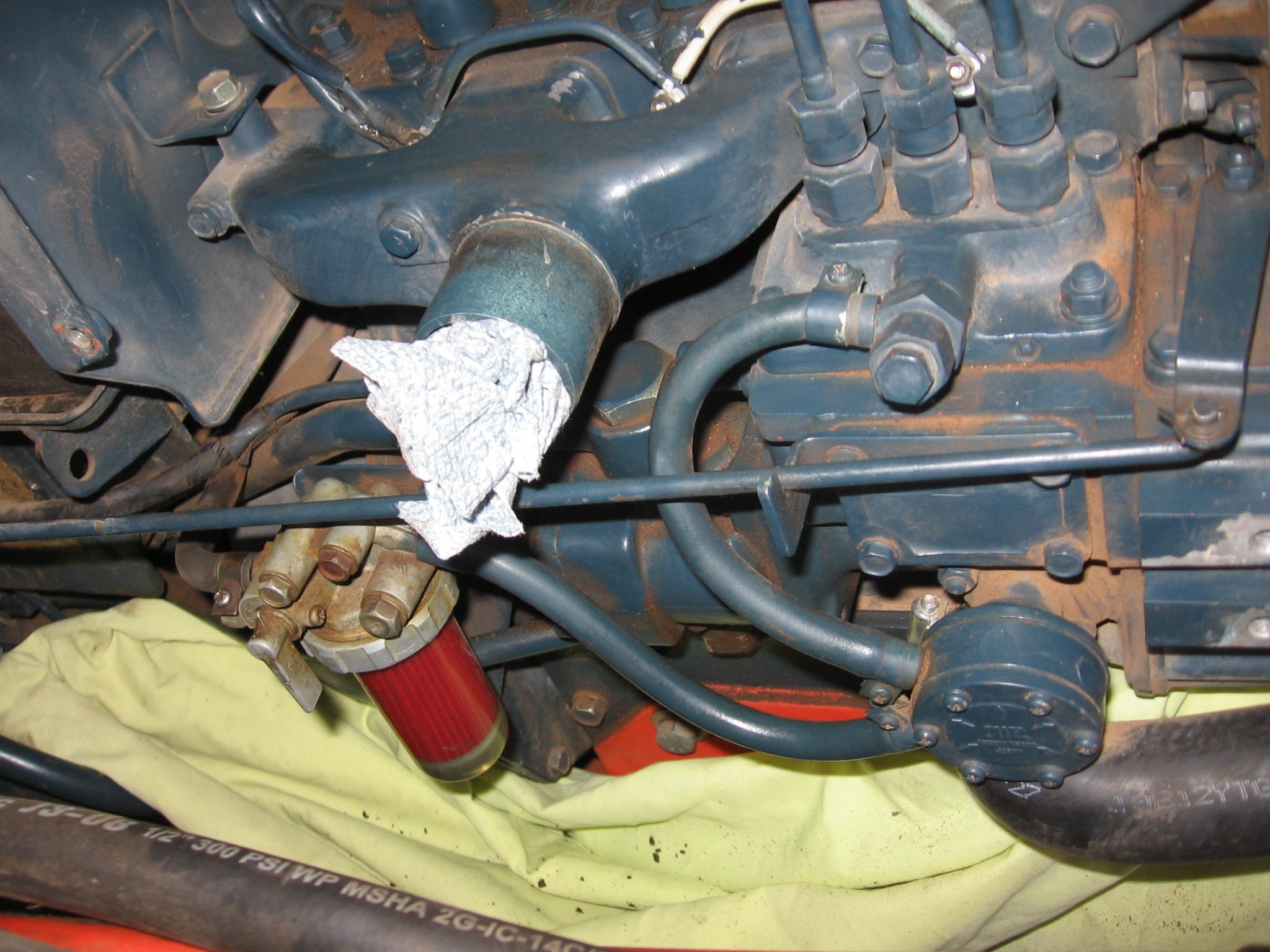

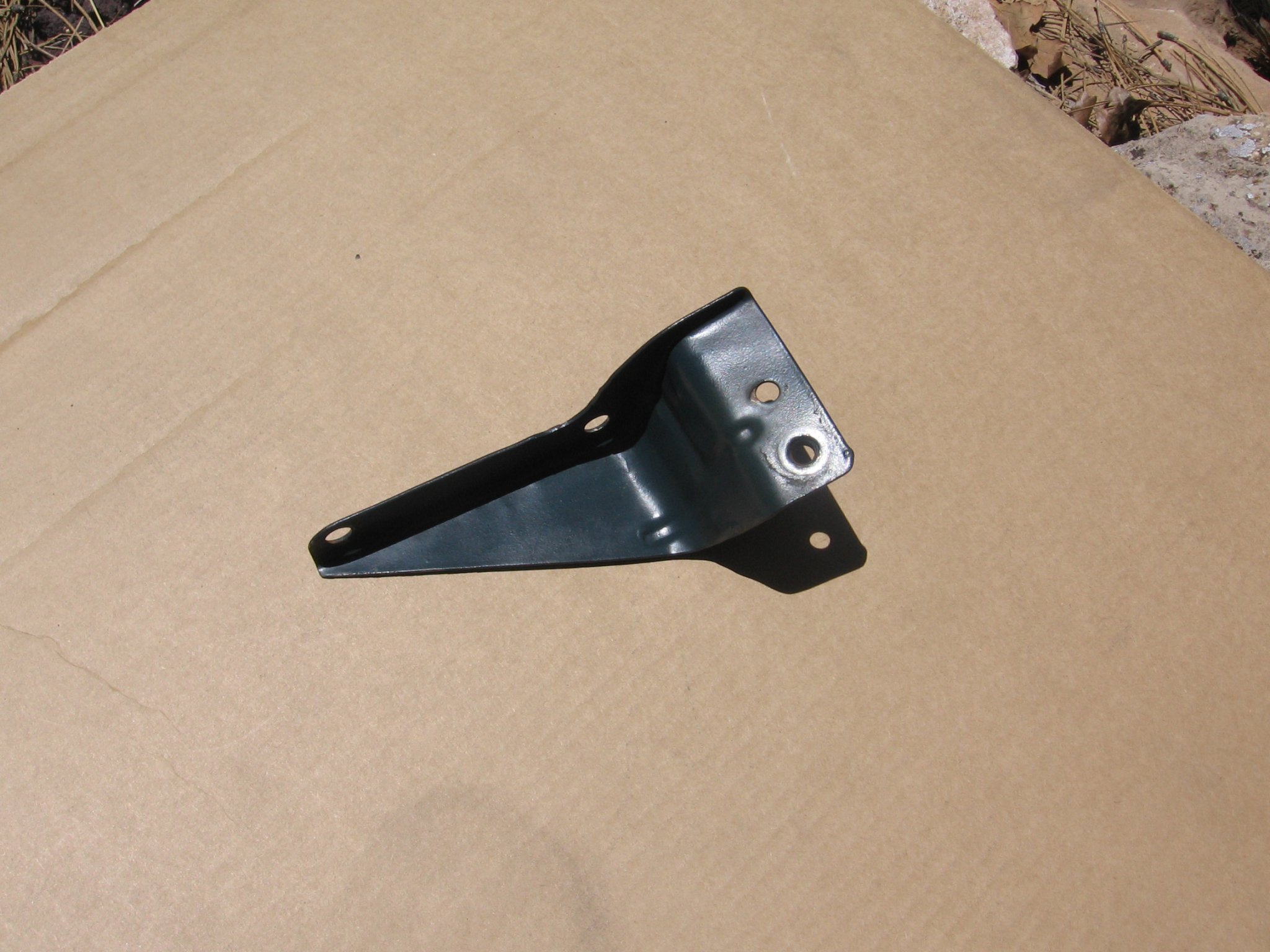

Fuel filter assy swung out of the way & bracket removed.
7,305
2,260

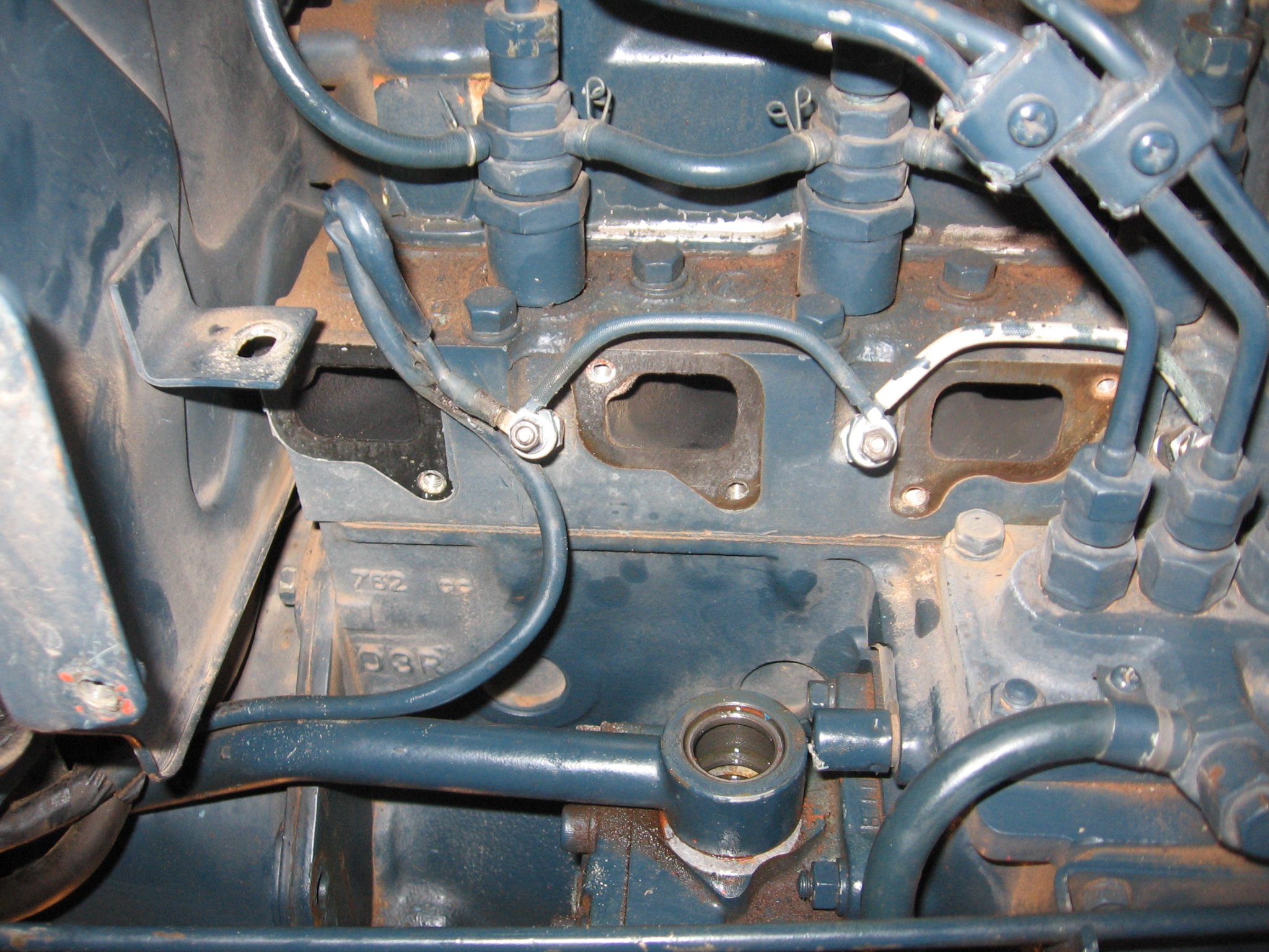

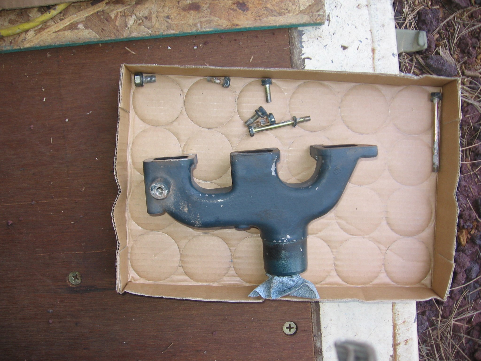

Intake manifold removed.

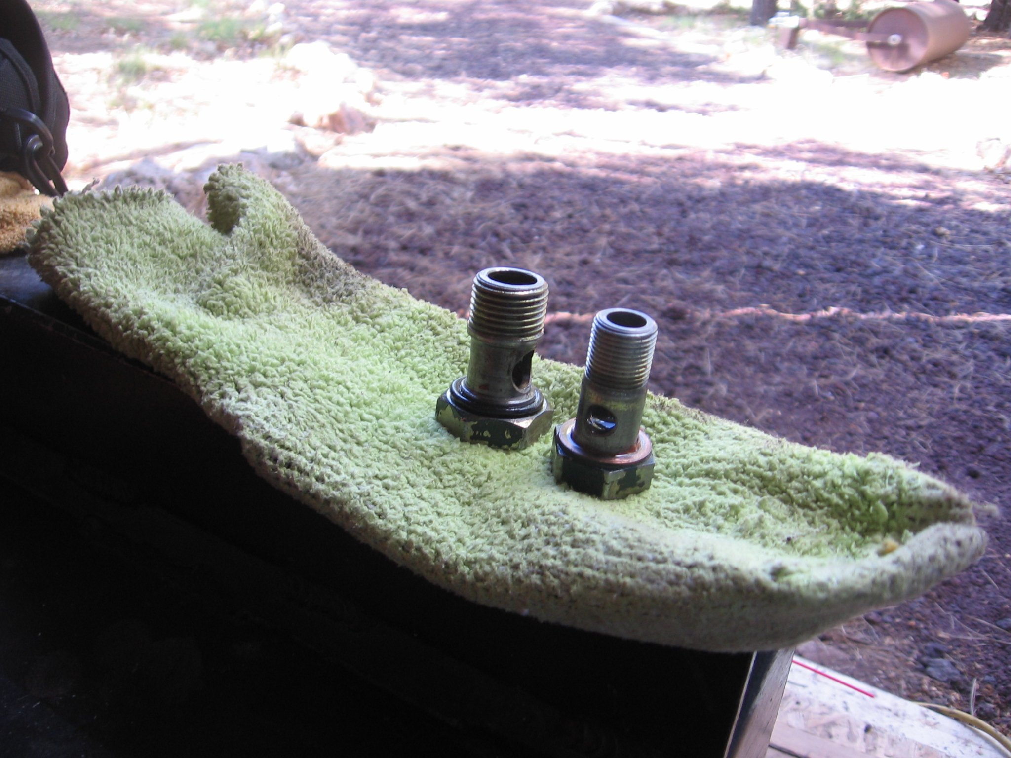

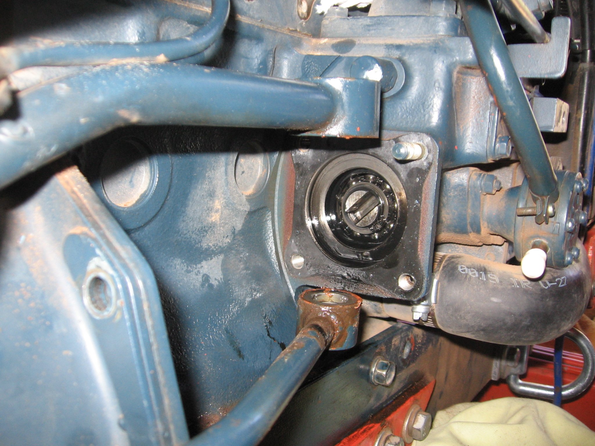

Banjo bolts removed.
7,305
2,260

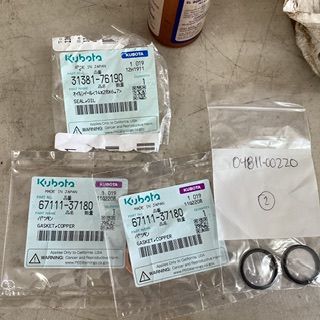

Parts on order, still lots of cleanup & gasket removal to be done.
Lots of fun trying to find 26mm (lower banjo bolt) and a 29mm (upper banjo bolt) open end/box end wrench. (at the cabin)
Was able to break loose the bottom one with a 12" crescent and the top one with a 16" crescent, without mangling them, but I doubt I could get the bottom one (high pressure side with copper crush washers) tight enough to seal with a crescent.
Have a 26mm in the home shop, and a 29mm is on order from NAPA.
Cannot get a socket or probably even a box wrench on them.
Tight access to the intake manifold bolts and the four that hold the pump on, but otherwise pretty straight forward.
I recommend a good variety of open end/box end wrenches, 1/4" & 3/8" sockets, ratchets, extensions, u-joints, and flex drives.
When the wrench & parts come in, I will head back up and take more pics as work proceeds.

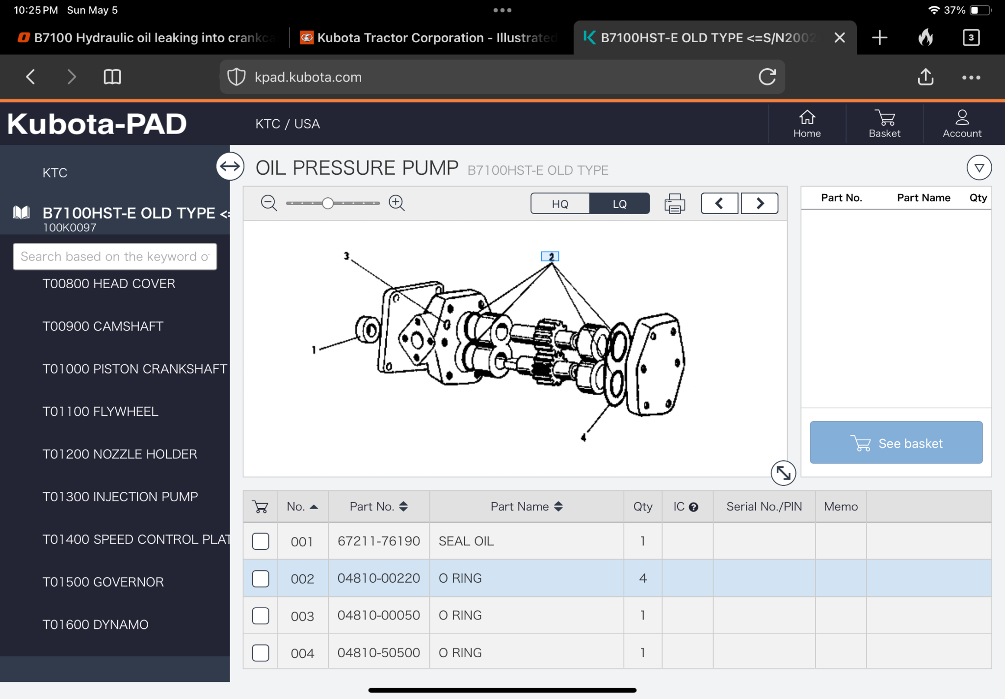

7,305
2,260
I will probably replace all the o-rings and shaft seal in the pump in my shop before heading back to the high country.

Seems like that one stud should be installed on the upper inside hole. That does not look like a spot you can even get one eyeball on!
My tractor is so much easier to get to the pump on!:p You have as many steps (if not more) just getting ready to pull the pump as it takes to get the pump off.

What are you doing about the rusted out hydraulic tube?
It has 45 years of seepage, covered with some dirt/dust, then a black engine oil drip on it.
But it does look like it is rusted through.
It is as solid as the upper one under that dirt & oil.
It looks a little better in the 2nd pic in post #8 and the 2nd pic in post #9.
You are absolutely correct, it would have been easier. Breaking that back one loose wasn't too bad, but unscrewing it all the way out was a PITA.
I might have been able to get that back bolt out without pulling the manifold, but it seemed easier to pull the manifold rather than fight it all day.

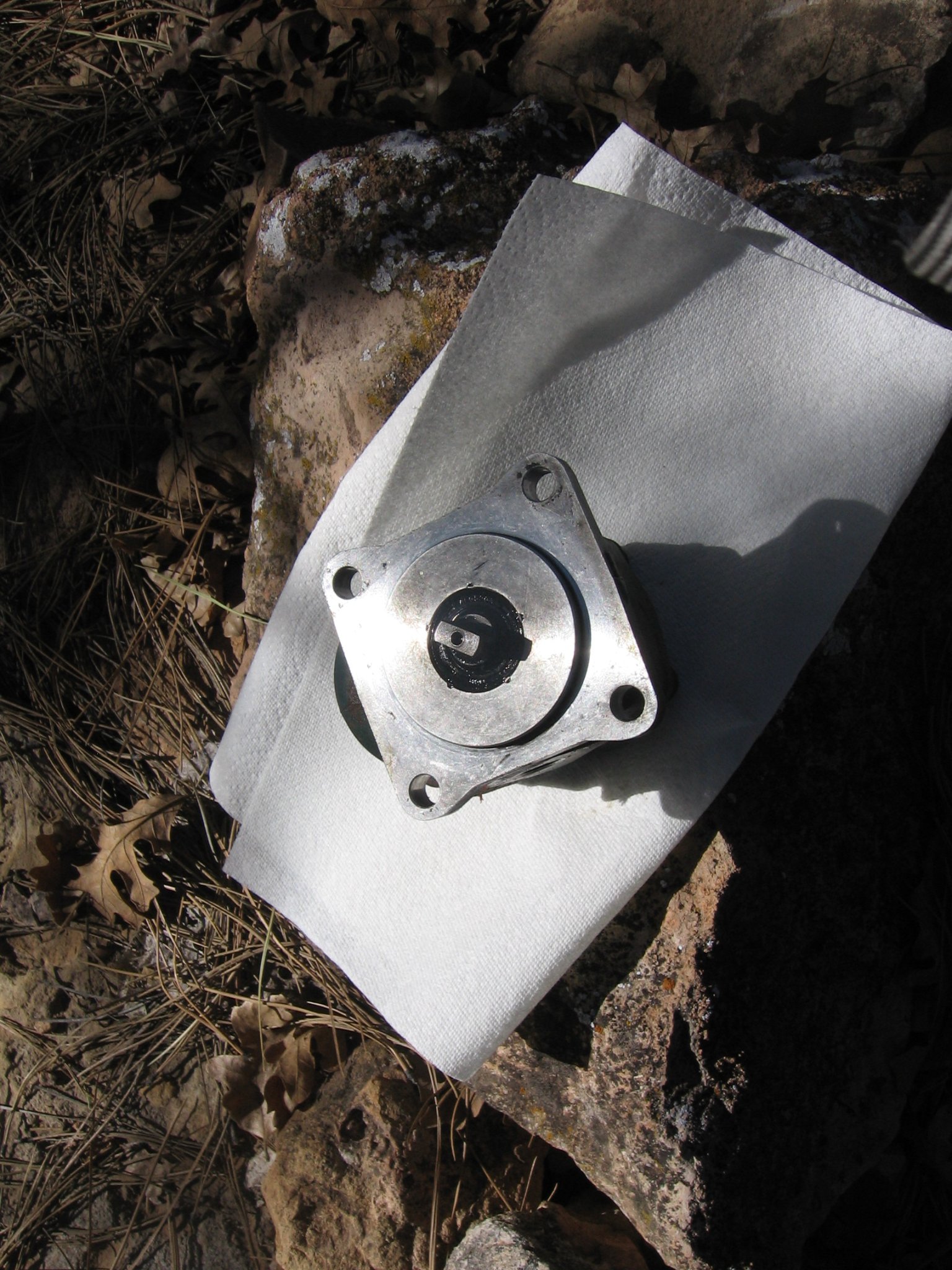

7,305
2,260

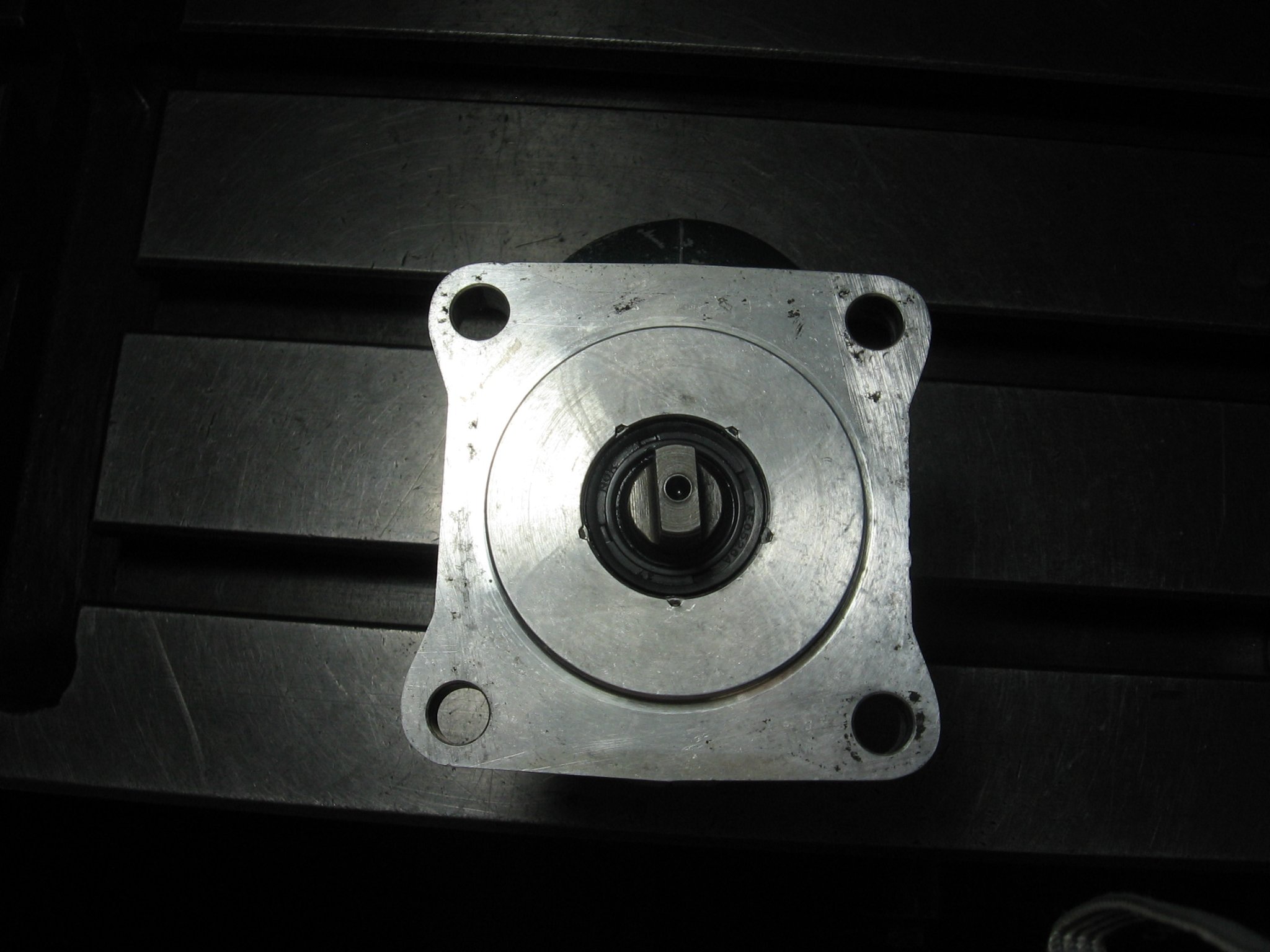

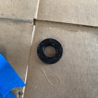

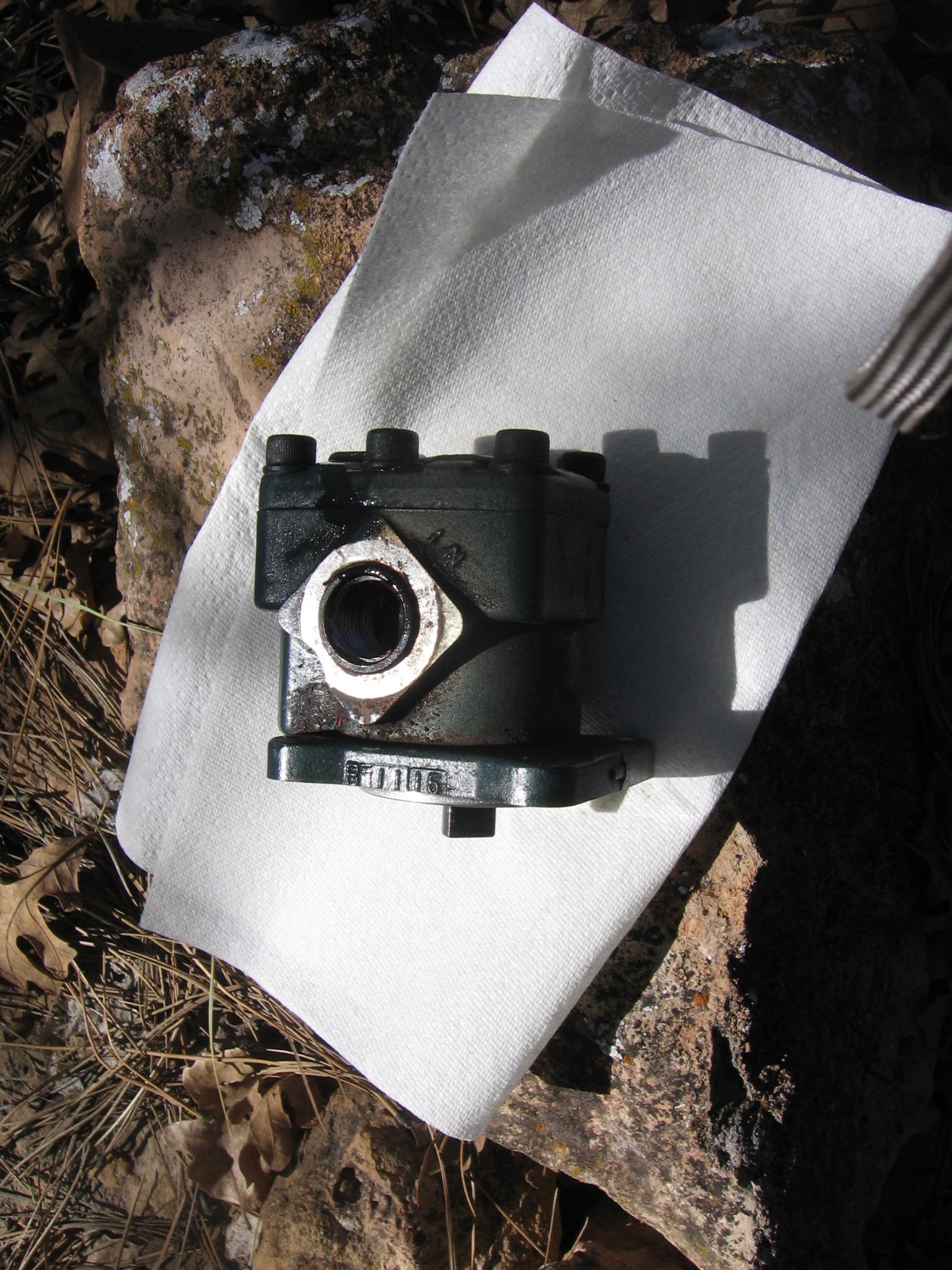

Cleaned up the pump today and found that the seal has been staked in. (5 places)
I have found no mention of the seal needing to be staked in.
Over zealous previous repair?
Comments?
