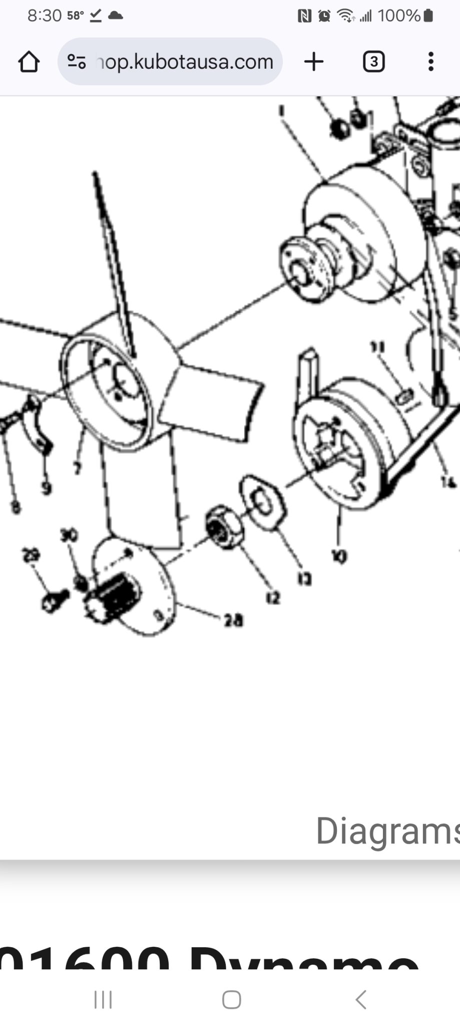

Is this your drawing?
Yup. It’s not the correct reference to what we’re talking about. I just figured that out.
My question is why can’t I put a splined gear that accepts the chain drive to match the chain drive gear I have attached to the old pump I got with the loader? I can either buy a gear ready to install on n the shop lined crank shaft or have one made to mate up with what I have in hand. I think I can solve my problem this time way.

I suspect your gear is actually a chain sprocket which is one half of a chain coupler. The other half of the coupler goes on the end of the tractor side shaft and a double row chain is wrapped around them to join the two shafts. An inexpensive standard part.
The hub in the parts diagram I posted fits over the nut for the crankshaft pulley and bolts to the face of the pulley.
My suggestion is have your machinist make a custom hub with a standard keyed bore for the crankshaft. From there out you can use off the shelf shafting to connect the hub to your pump. Easy for the machinist and you.
