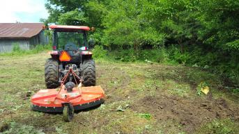

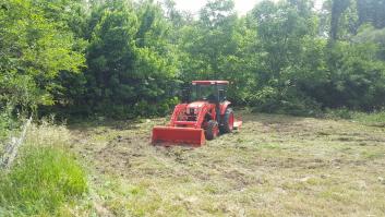

I have the Kubota Grand L3560 and really like it. So far it has completed every task we have thrown at it. My dad has an 80 acre farm, which 60 of it we share crop out, so we have about 20 acres that we are trying to maintain and get back into shape after several years of nothing being done.
(Attached a couple pictures of the tractor after we had been clearing one area. Also, a picture of tractor when I first got it and my dad resting on the deck.)
