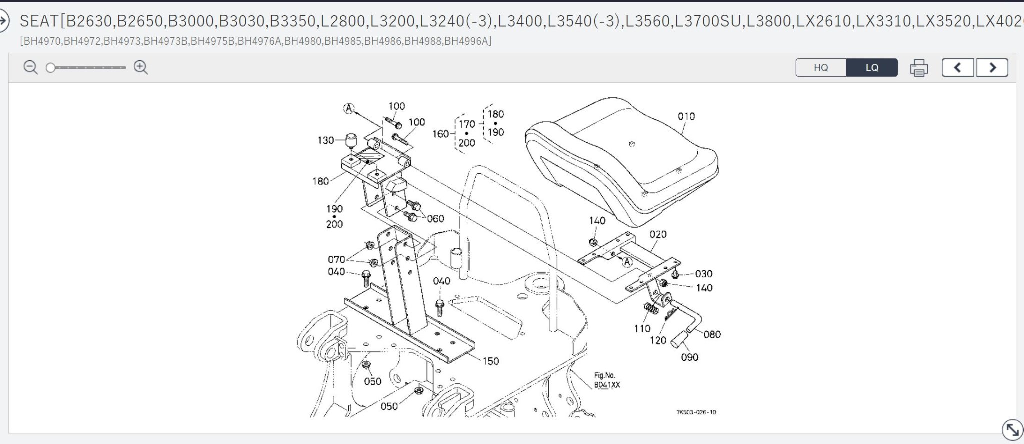

Wondering if anyone else has changed the swivel seat to a fold down seat with arm rests.
I find I move the tractor around a lot when using backhoe, some times I do not Swivel the seat I just sit on the back of it to operate the backhoe. Would be better if I could leave seat facing forward and fold seat back and sit on that. Much cheaper than getting the frame extension and seat kit which runs about $1k will only change seat and leave swivel bracket in case I wish to use it.

I'm pretty sure that someone on here did that recently. They added the second seat without the frame extension. It works but is pretty tight without the additional 12" extension brackets. Hopefully that individual will respond to your post.
see here. https://kpad.kubota.com/books/446/figs/16960

Yeah no cab here what I wanted to do was use one seat but sometimes when using backhoe just fold seat back down and sit on it without have to spin it around
Did not want to add second seat either
Having hard time finding folding seat that will fit swivel frame

CT
