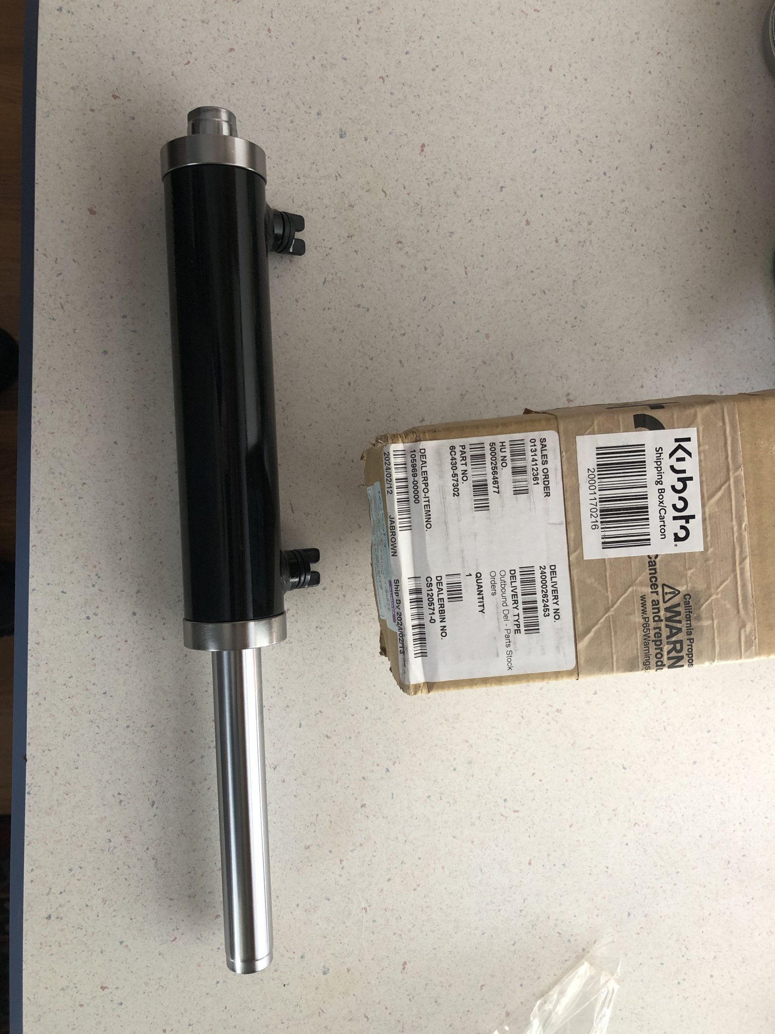

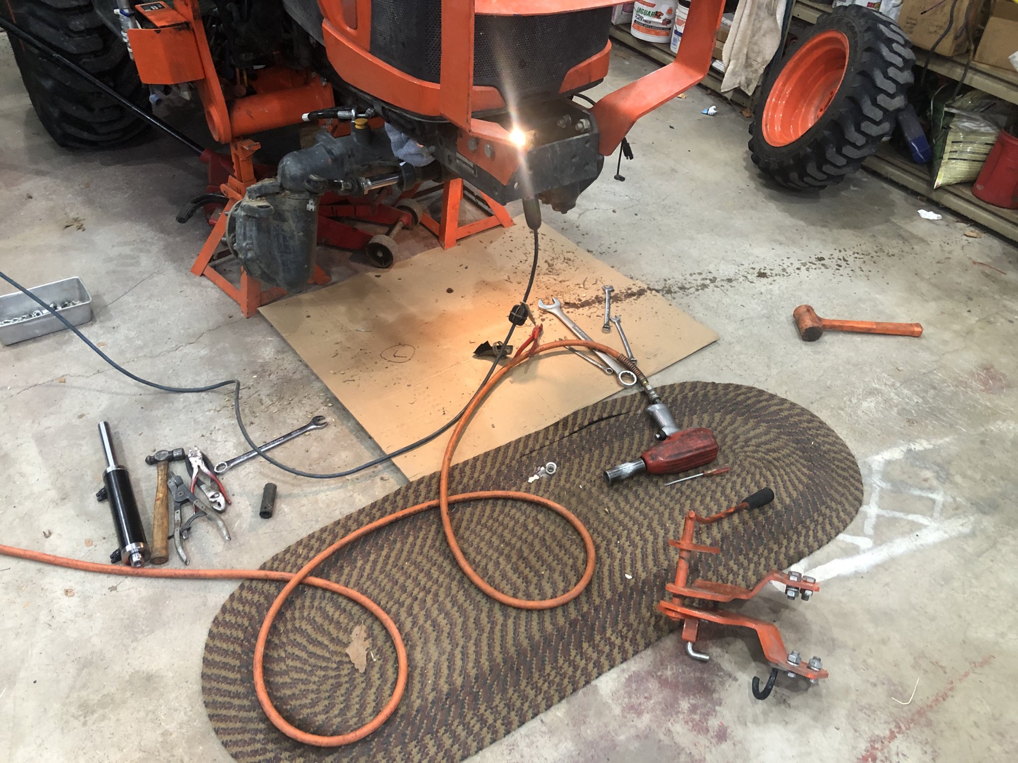

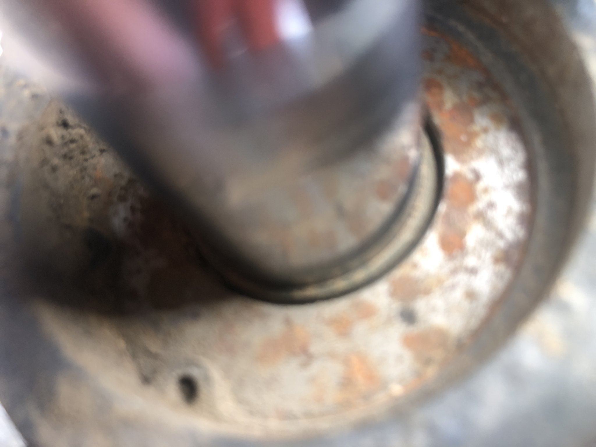

My B2650 steer wheel keeps turning slowly after you turned hard to the right or left while wheels can’t turn no more.
I have a 2017 B2650HSDC-TLB and after 950 hours I had the same problem. I took it to a Shop for repair and they said the pressures all around are within spec but it's their best guess it's the steering unit. Needing it fixed I agreed, but $4500 later and 18 more hours on the machine it did it again. ($3000 of that was to R/R the cab etc) Back to the shop thinking the new part was defective. They said the pressures are all fine as before !!! Bring it back when it breaks where their last words to me.
According to Kubota dealer, the BX models have had similar problems of oil bypassing and causing hard steering etc. So, I ordered another cylinder, ($890) and now I am in the process or trying to get the cylinder off the Kubota. They said it was straight forward off and on, but I found out that's not the case. One needs 22mm and 32mm spanners with the 22mm being thinner than the 32mm. I am stuck at the moment in trying to remove the tie rod ends so I can replace the complete cylinder. I ordered thin spanners but that did not work, so now I ordered two open end wrenches and will resurface the 22mm so it fits the space provided. The right side of the cylinder has two notches (22mm) and the left side does not. Factory did use a red thread locker and Loctite 243 crosses over.
In short, I would have had them replace the steering cylinder first, then if need be replace the steering unit and pump since the cab was off.... so I am not happy their best guess was wrong. An expensive lesson for sure.....
