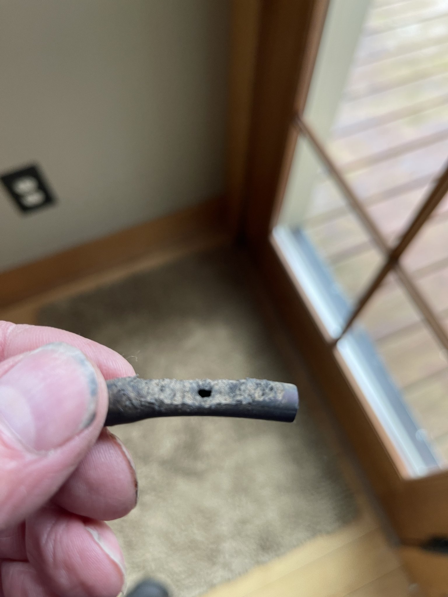

Well the dealer called late yesterday and said that a rodent chewed on the return line. I am somewhat skeptical but…… I did find a mouse nest on top of the fuel tank close to the back.
pauly
2014 B2650, LA534A FEL,B2781B Snow Blower, Land Pride RCR 1260 Land Pride RB157
Sep 23, 2014
150
East Troy Wisconsin USA

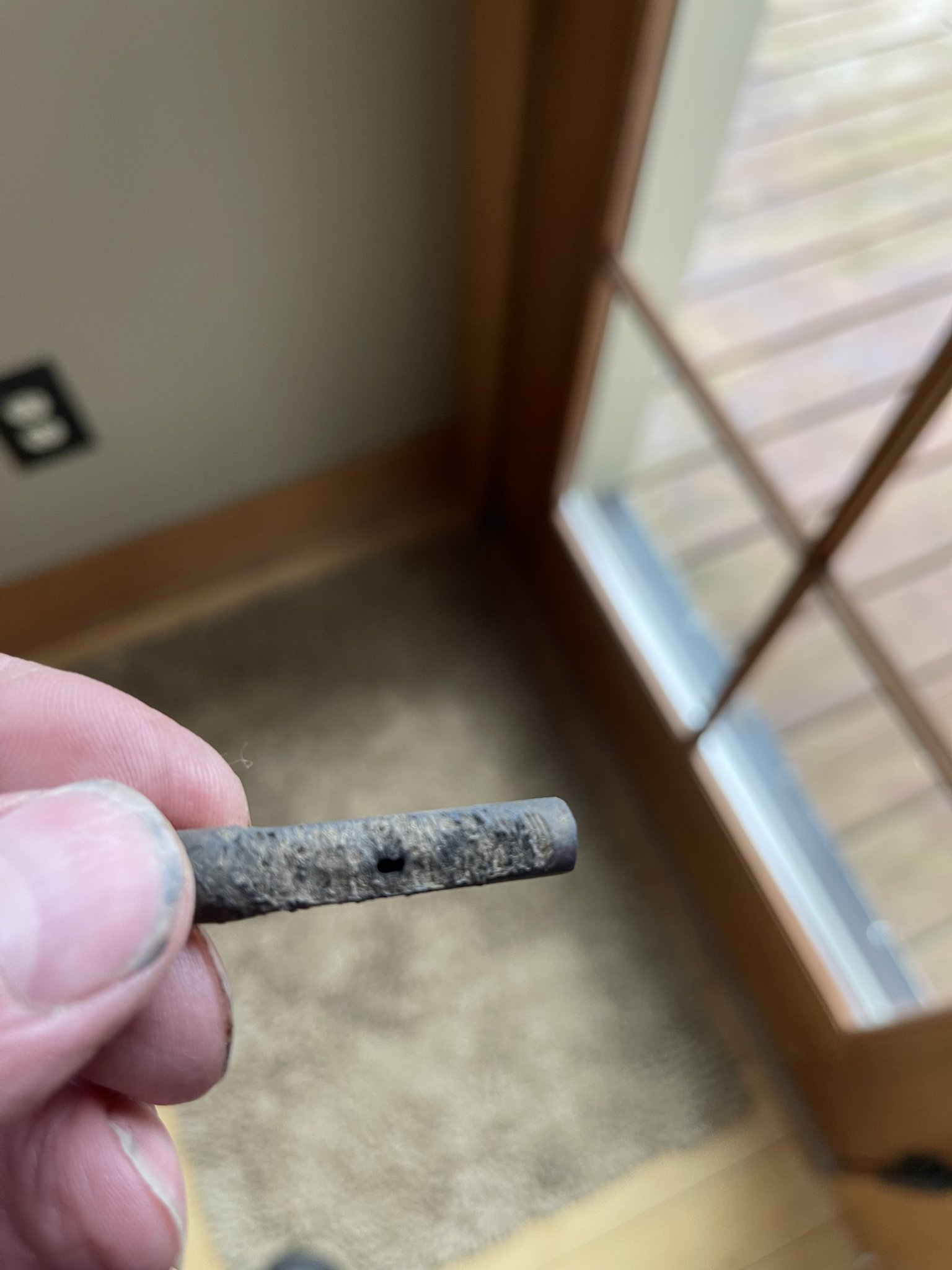

Got my tractor and the damaged fuel return line back. Yes there is clear evidence that a mouse was chewing on the line.
