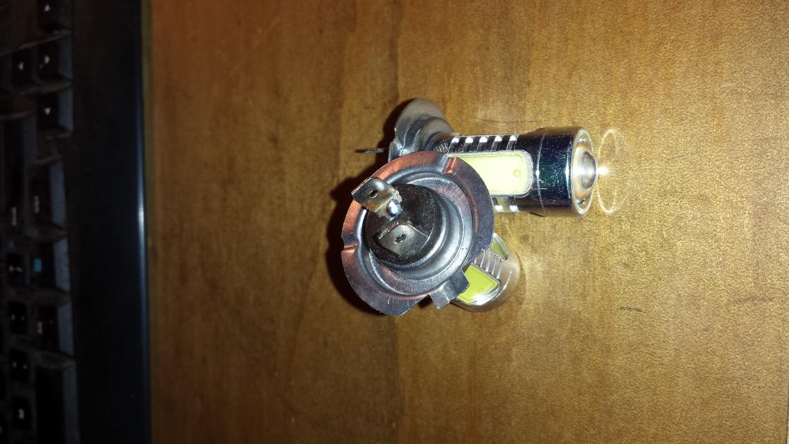

Do you have bulb bases like these?
I got these LED's off of EBay for $2 if I remember right.
They are super bright and only 7.5 watt draw.
