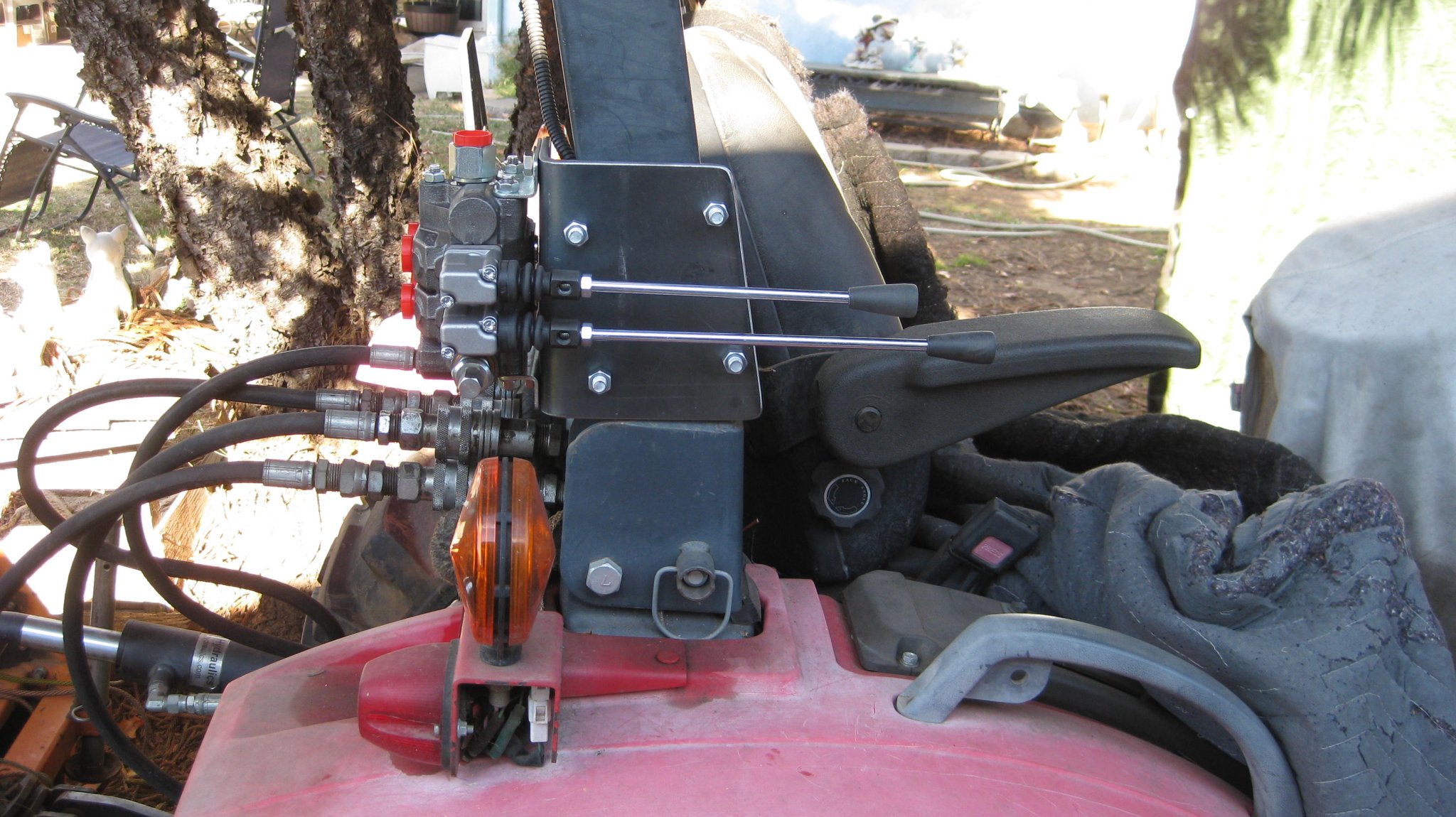

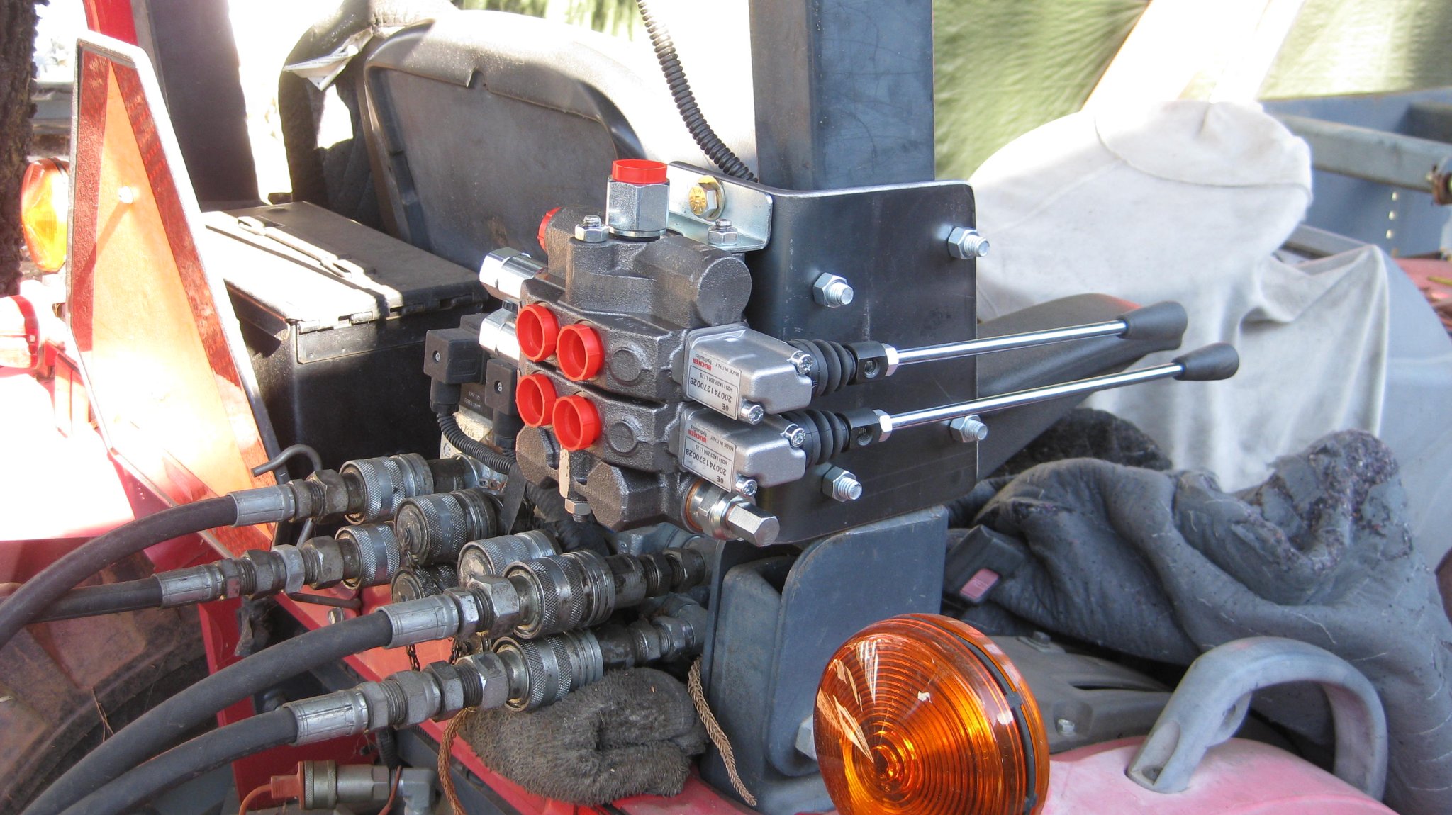

The pictured valve is a fairly clean and easy installation.

How's the location of the valves there, are they hard to reach and use?

I feel that it is easy and comfortable to operate the levers left-right as positioned.
I have not had any complaints.
The levers are out of the way and yet easy to reach and operate.
Keep in mind that this picture is only to give an idea of how the valves would be positioned and mounted.
This tractor has a different setup for its requirements.

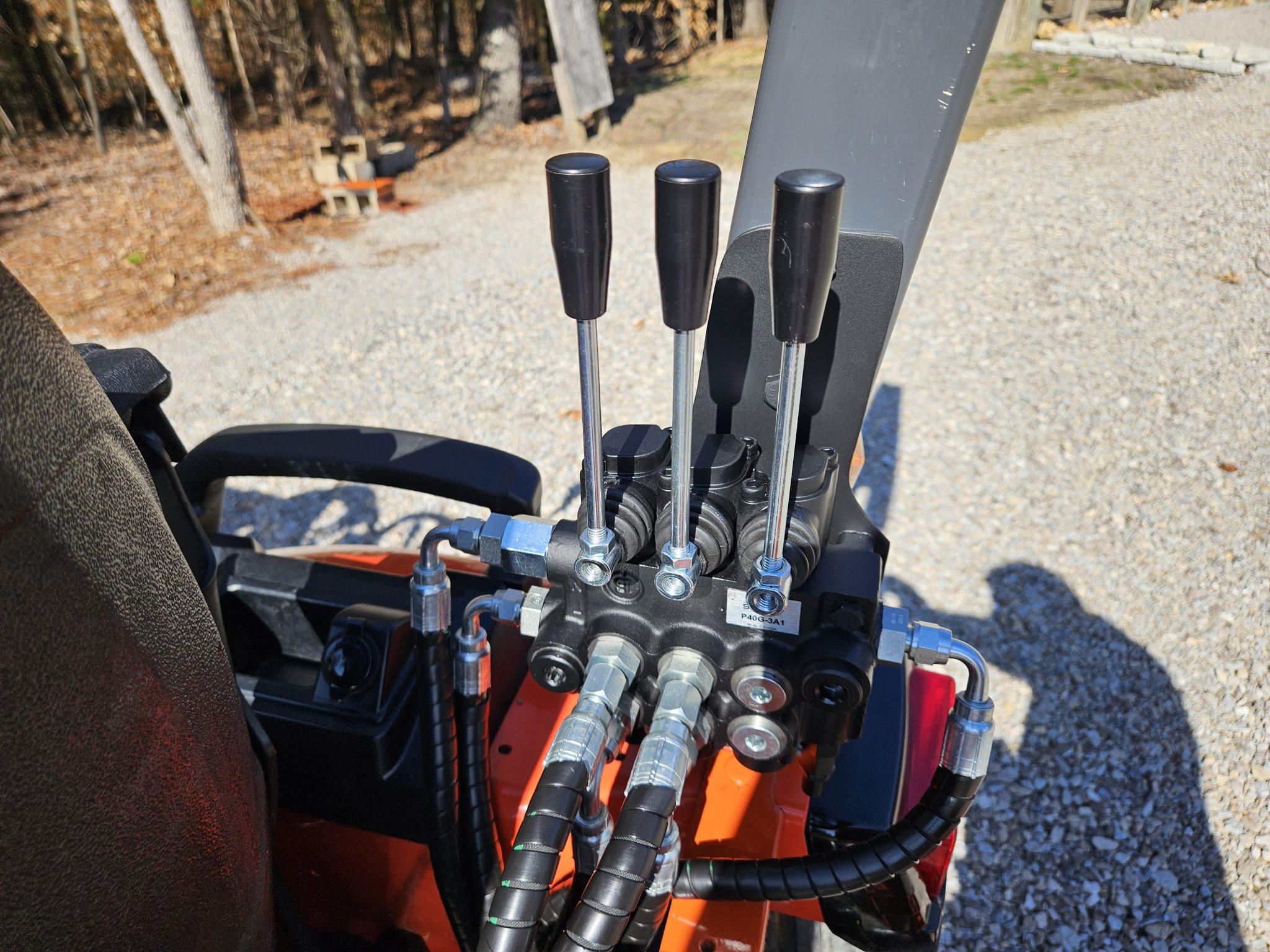

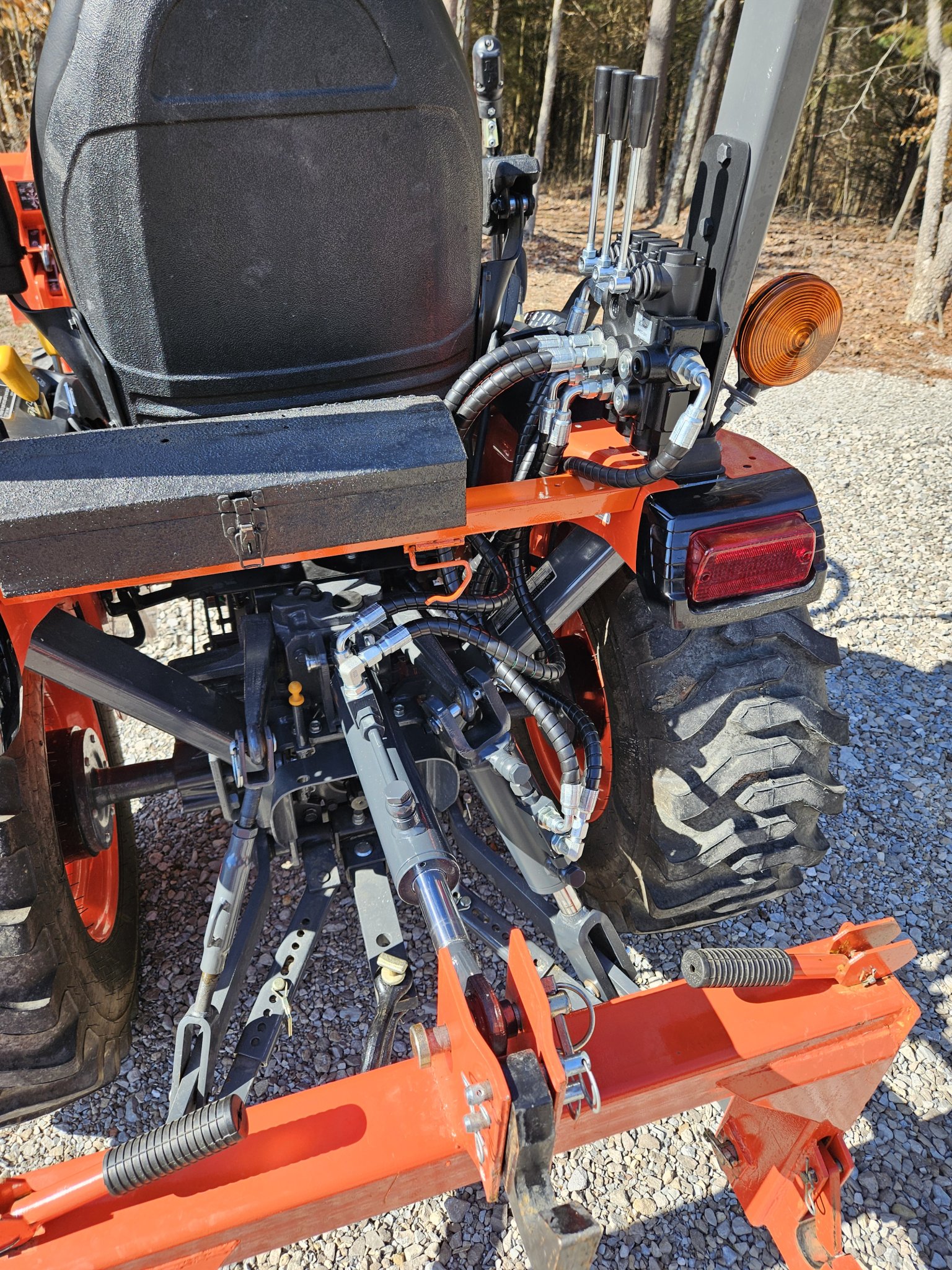

My set up with a Summit valve, plumbed after the third function as described by MntView. Valve body mounted to steel plate with plate mounted to ROPS through existing holes. Primary use is top and tilt. Has worked out great.
