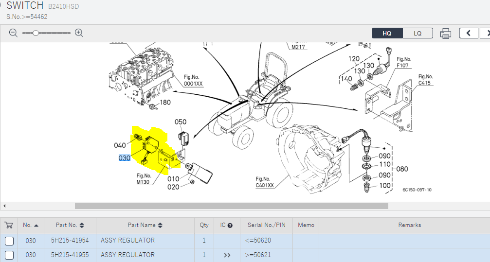

Since the 2410 is so simple since it has no computer, just straight up conventional wiring, this should be an easy fix, but I need to know what components it uses so I don't throw parts at it.
Does it have an alternator or a generator and if it uses an external regulator, where is it located? It's 22 years old now and this is the first issue besides a leaky seal since I got it.

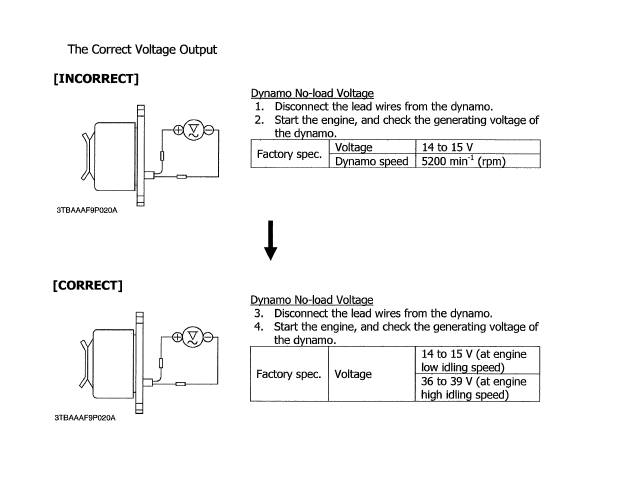

It doesn't have either, it has a dynamo.
It's closer to a alternator with an external regulator but different.
Dynamos are fixed magnet with no brushes to wear so they rarely go out.
The regulator on the other had does go out.
Have a multi meter?
Set it to AC, disconnect the two wires at the dynamo, measure those two wires with it running.
if that tests good go to the regulator.

I think what Kubota calls a dynamo is actually a magneto by definition.
10,213
4,243
