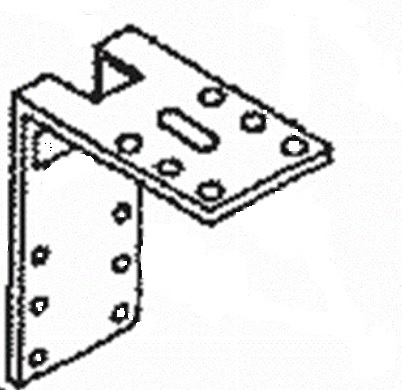

After much reading, it appears to me the OEM backhoe solution in 1999 when the B2400 was made was the B4672. This looks to me to be a 3 pt unit AND requires two things: a frame stiffening piece on each side kit (B4681) and a top link reinforcing kit (for group 1 tractors) maybe part 4644d1018461315,

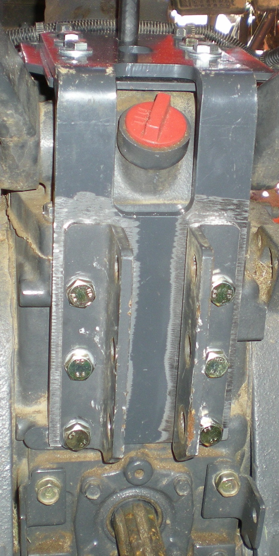

Hopefully, I'll find the photo of my heavy duty top link that I mounted... I've described it a couple of times... All I had time to find was before I welded the ears on. I used new, longer, grade 8 bolts - it bolts on top of the rear casing and the back. If I get a chance, I have a document of several heavy duty top links for many different models....

Yes - that looks like the OEM Top Link reinforcer. If I go with a 3pt set up for the hoe that will be needed along with the support frame kit. The issue is probably going to be locating a B4672 backhoe. I see lots of woods, deer, and even newer kubota units but very few of the older kubotas that were 3 pt.
I need to snap some pics this evening of the rear axel housing assembly on the B2400 to figure out how to attach a ladder/rail subframe. The front is fairly straight forward as it will attach to the FEL housing. It's my understanding that the goal is not to use the toplink at all but rather rely fully on the subframe. In order to do this I will need to fabricate my subframe to go around the axel housing as I will need a support from the top of the Hoe bracket down to the ladder sub frame. More to follow...
