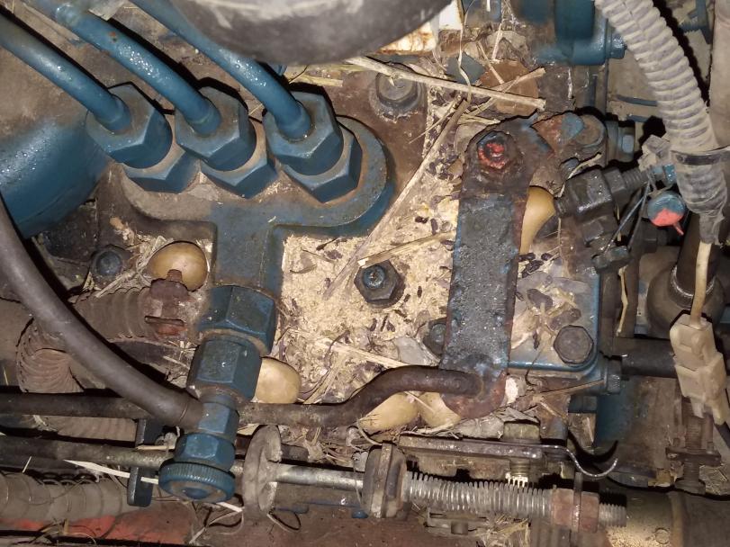

Well I found the problem, I came prepared today, I brought vise grips and a flashlite also many misc tools and a shop lite if I really needed to tear into it as it was parked in a dark shed with no room to even walk around it. I had to stand on a Rotary mower. Anyway popped the hood and to a look the the other end of the Engine stop Knob. It was jambed by large nuts from a nearby tree. My friend needs to get a few barnyard cats. I took a couple pictures before I remove the nuts and started the tractor. Go thing she did not call the dealership as travel time would have been a minimum of 3 hrs round trip. Thanks for the help everyone.
28,966
5,312
popped the hood and to a look the the other end of the Engine stop Knob. It was jammed by large nuts from a nearby tree.
Well I do believe this is a first... But I have heard of the problem being a loose nut behind the wheel! :rolleyes: :D
