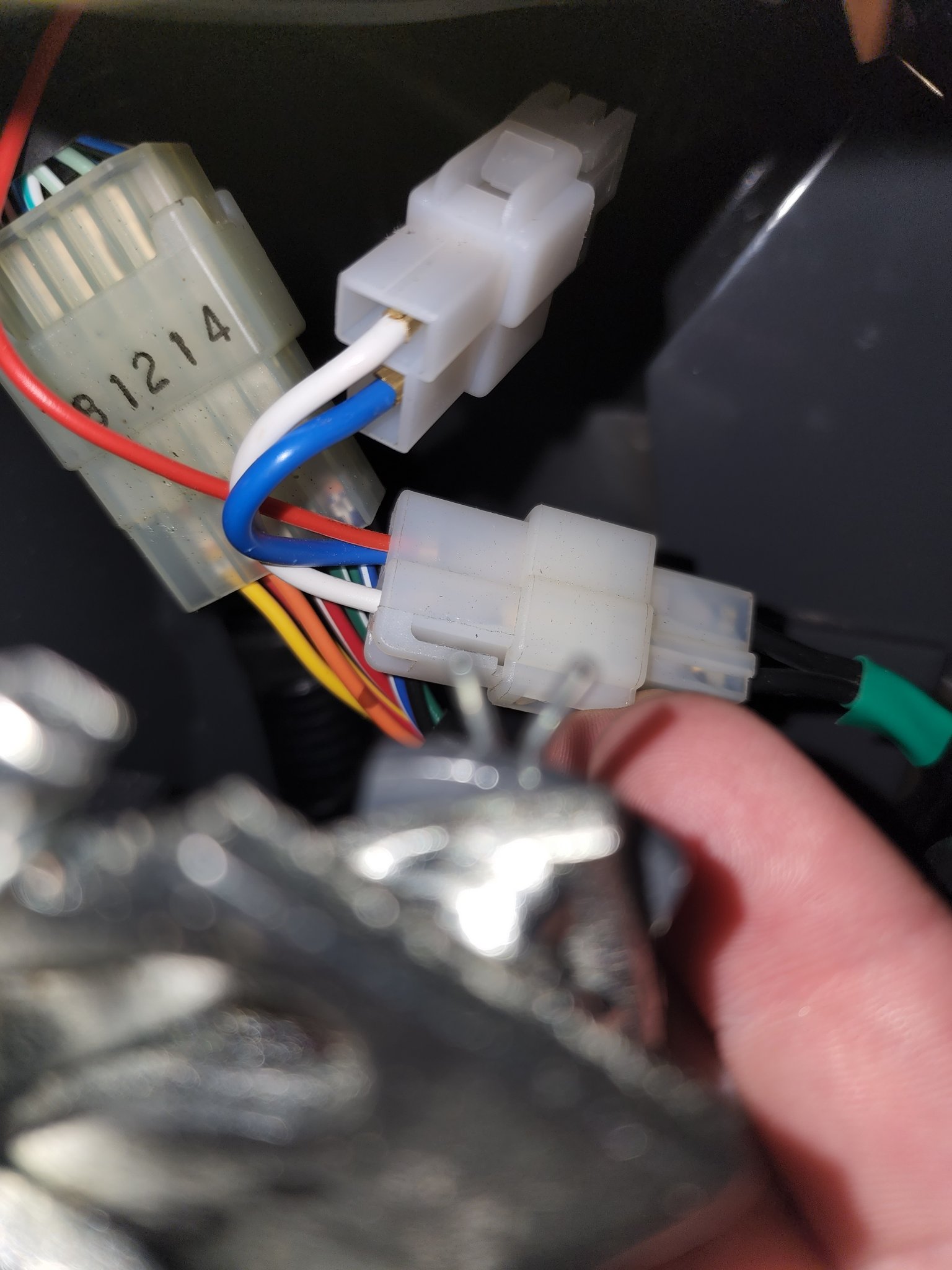

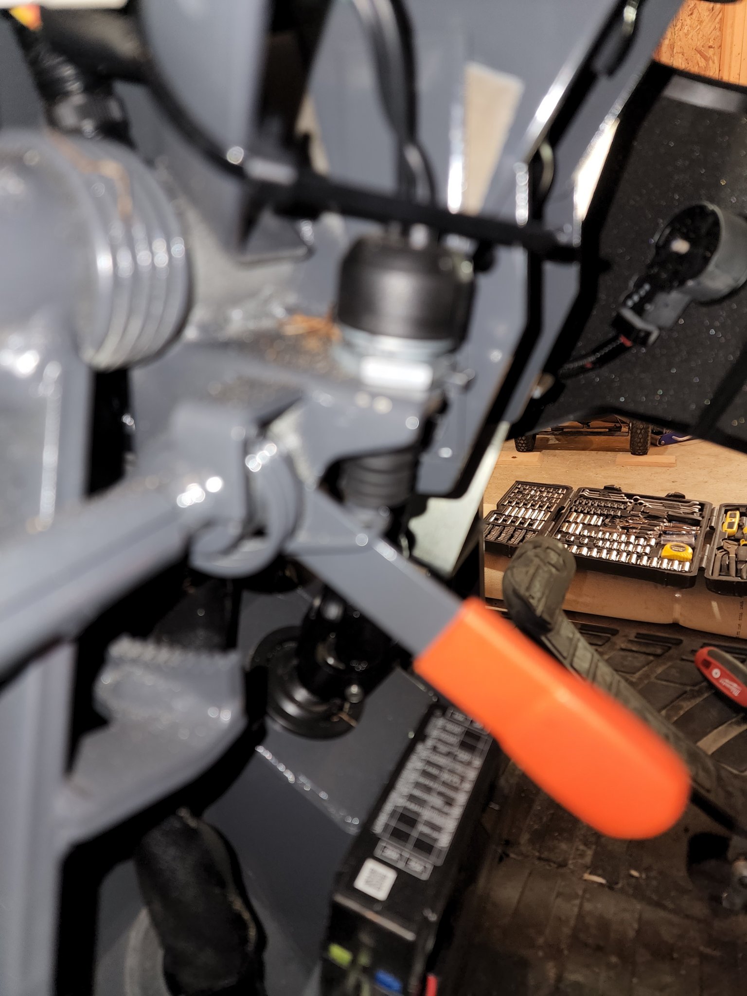

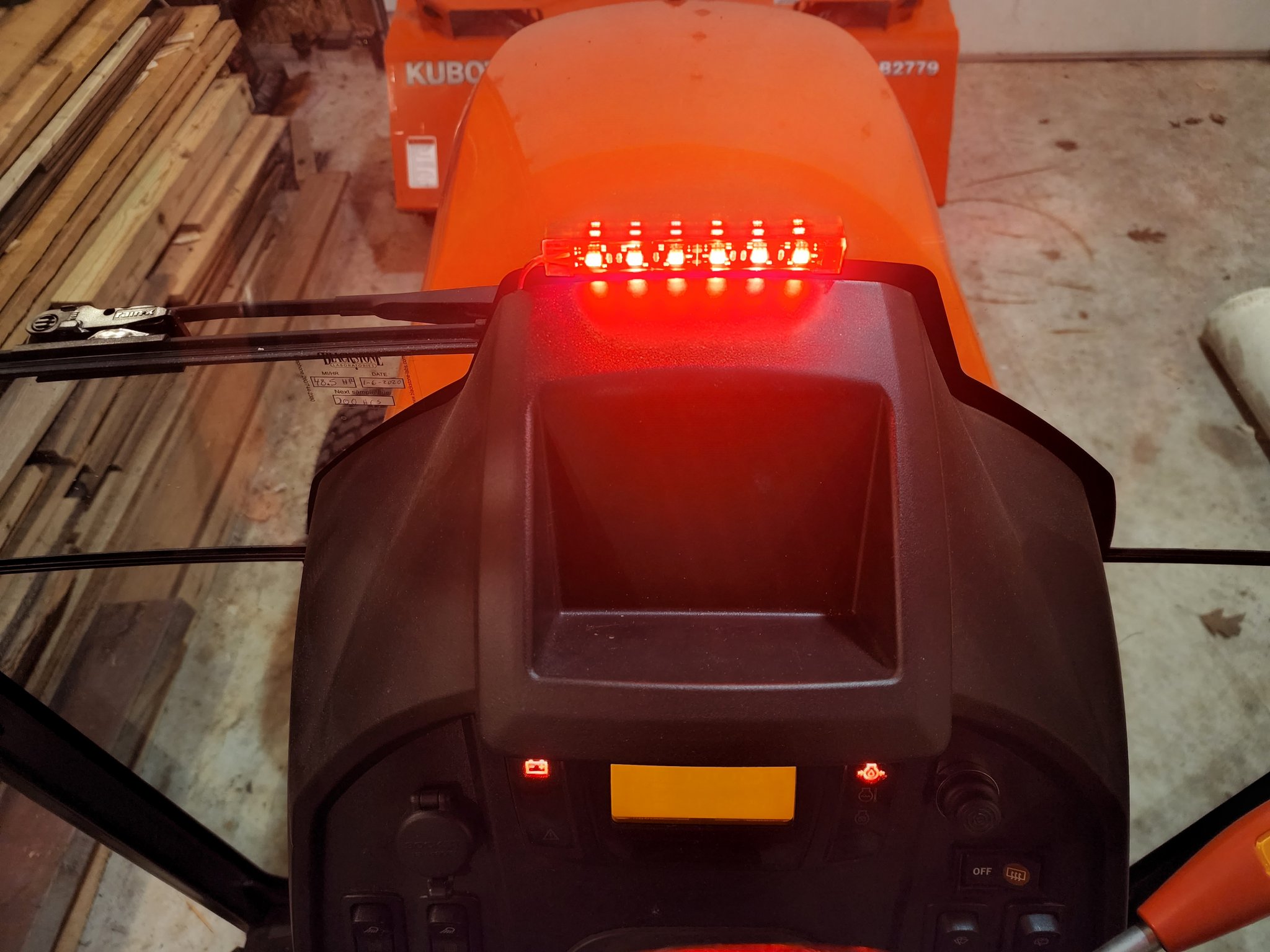

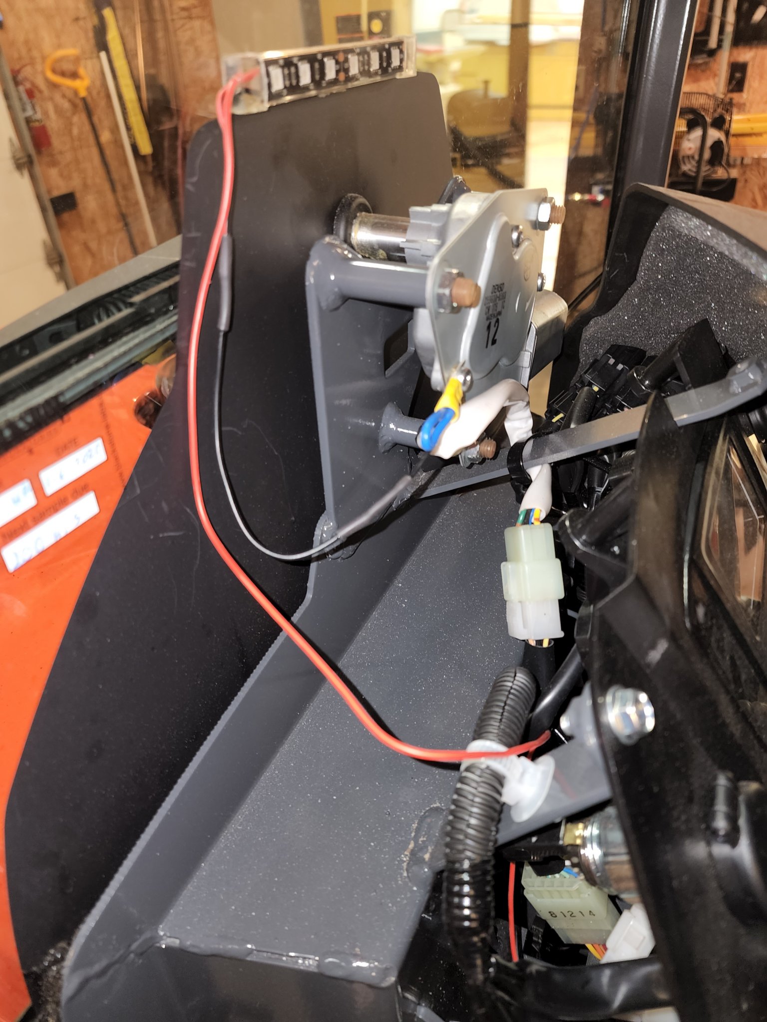

OK here is what I did I was having a hard time making a wiring diagram so I did not include one but its a pretty simple circuit.
picture 1 is a 6 inch red led motorcycle brake light from amazon.
picture 2 is the parking brake lever with the switch (sorry its a little blurry ).
picture 3 is the little jumper harness I made with the red lead for the led coming off it.
picture 4 is where I attached the ground lead of the led.
The connectors I got where from this link
https://powerwerx.com/oemt-power-co...ItilwVb9e2eCtG4Lcbi21FsZf6mMmNNcaAk0ZEALw_wcB
you will need 1 male and 1 female connector
you will have to move the dash out of the way to do any of this it's very easy just 2 10mm bolts on the lower left and right sides and one phillips head screw right behind the steering wheel. The 10mm bolts don't need to come out all the way the plastic dash is slotted.
The led positive lead needs to come off the vertical connector not the horizontal one. If you connect it to the wrong connector your led strip will be on all the time as that has +12v when the tractor key is on.
one thing I should have done is added a small fuse on the + lead of the led strip just in case something where to happen.
Hope this helps.
Oh and its a pain to undo the connector coming of the brake switch you can only get one hand in there to disconnect it.
