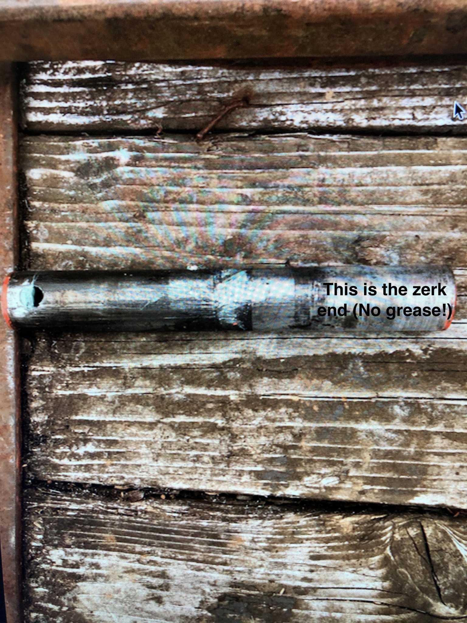

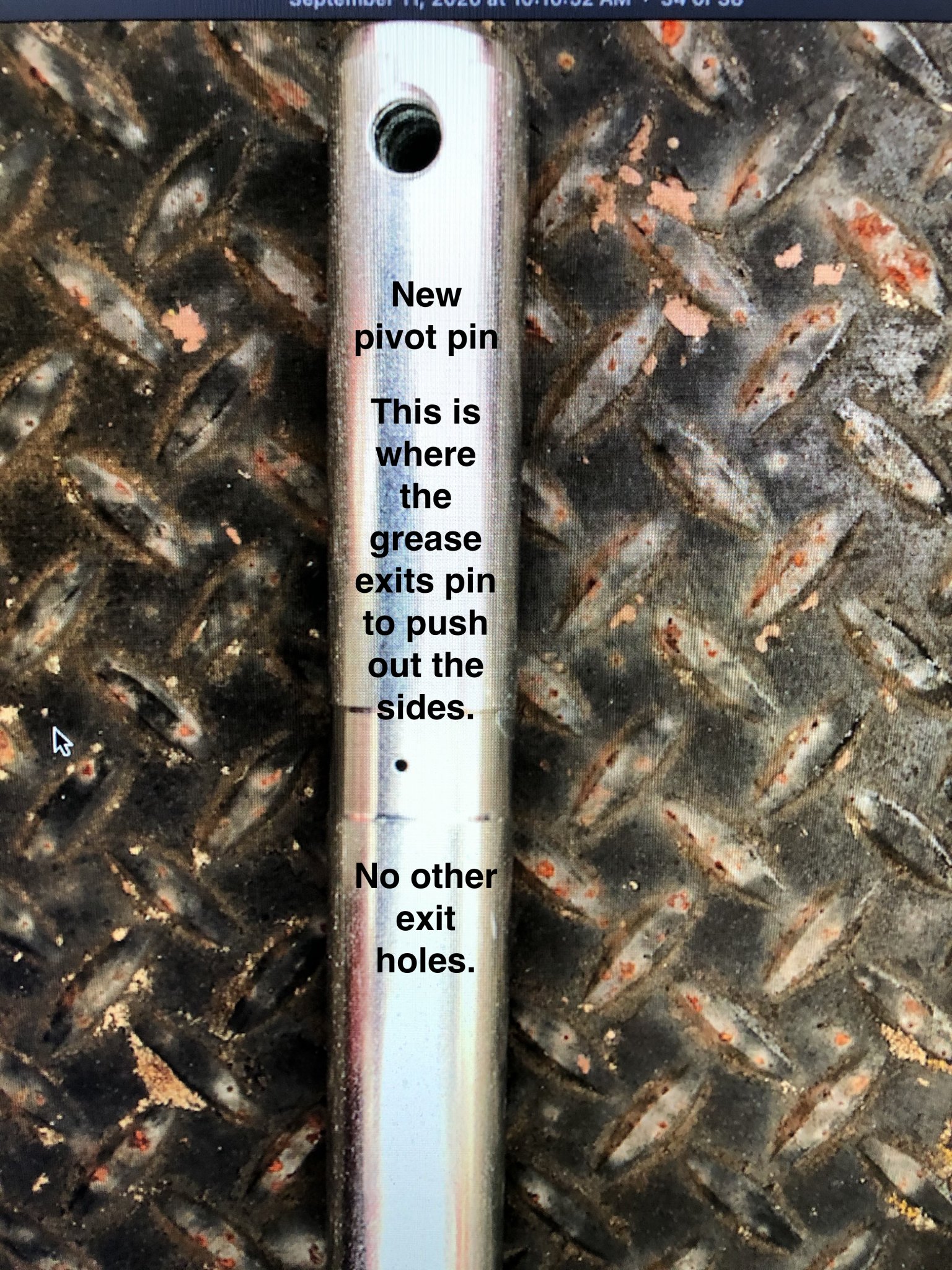

Ok I finally got my tractor fixed. Took it back to Kubota and the tech proceeded to preplace the old pivot pin. He said it was way too hard to pound out and suppected there was something really wrong. After a lot of pounding the old pin was out. Putting the new pin was so hard that he stopped and said it looked like far side of the hole from the zerk is somehow pinching the pin. Said he'd have to grind/hone out the hole (probably a bushing inside?) to get the new one in. Took a ton of grinding and honing but the new pin finally was able to be pounded in. Grease finally came out of both sides of the joint and no noise! Couldn't really see what he was grinding but it worked. There was nothing wrong with the old pin. I've attached a pic of the shiny new pin and the old one the left side of the old pin(the greasy side) was the far side of the pin away from the zerk. This is the side that was being pinched. Still not sure how the grease being pushed out of that small hole would travel to the both sides of the A arm. But it works now! No amount of greasing would have fixed this. Before I noticed that the keeper bolt on the end of the pivot pin would quickly bind up and sear off after a while. All of my other bolts were always loose. After the operation it's now loose.
B520EA02-5FD7-47D4-A837-1E94D86D1291_1_201_a.jpeg A23A202B-2857-42F8-BAAE-9EEB8F972061_1_201_a.jpeg
10,106
4,171
While I'm glad you've got it fixed...
this concerns me..
re: Took a ton of grinding and honing but the new pin finally was able to be pounded in.
POUNDED IN ??? That should be a HUGE red flag...... there is NO way the pin should have been POUNDED in. They're designed to be silky smooth slid in, maybe a rap,rap with a very small ballpeen hammer not POUNDED in.
just be sure to add grease every 10hrs of use, just 1-2 squirts, enough to push out the old and in with the new...

Yeah didn't really like the solution. Tech never said anything about sliding in easily. There are bushings inside and I've never done this type of repair. All bushing work on cars are super hard to get in.
Anyway it's done and I'll be monitoring it for the rest of my ownership.
Hey where did you find the "grease every 10 hrs" reference. I've gone over the owners manual and can't find any lube interval reference anywhere. Makes sense though.
I think a more serious aspect is that there is clearly something wrong coming from the factory. Paint covered zerks is bad enough but I think there is clearly a manufacturing defect. Anyone ever heard of a Kubota recall for anything or is it a squeaky wheel situation?
5,225
2,413
I think I would try removing the pin. If it does not slip out easily, you have a problem in the making, which may not appear until after the tractor is out of warranty.
Sounds like a half a$$ed fix and not the correct solution. As said above, if things are aligned properly, pins slide in and out very easily.
Hand grinding is NOT precision machining...
bird dogger
Vendor Member
Feb 24, 2019
1,578
1,427
North Dakota
They make long pilot adjustable hand reamers just for applications like this.
