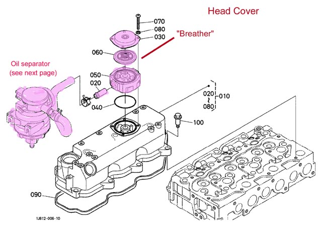

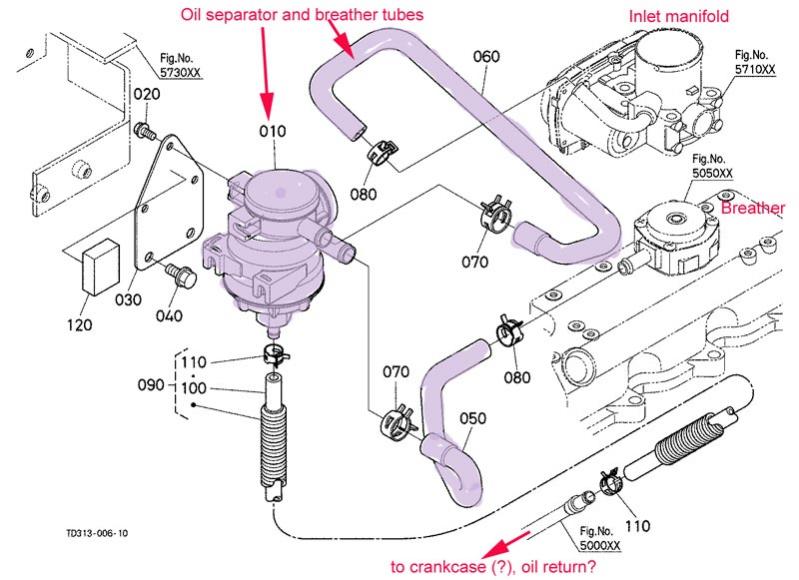

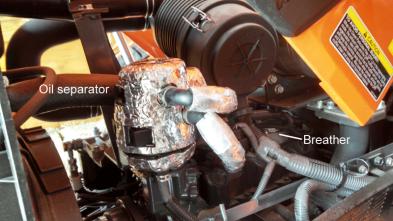

The tech came out today and replaced the "breather" and the "oil separator" and all the associated breather tubes. The names are from the parts diagrams which can be downloaded from Messick's website. I have labeled them as best I can from those diagrams and on a photo of my engine, which is taken of the left side. The new parts are covered with an aluminum foil insulation, and the breather has a diaphragm-like part that was susceptible to freezing replaced with a more open looking structure. The tech was on the clock, and it was cold out, so had to limit my questions, and so I am not actually sure how this is supposed to work? Gases come out the breather from engine, go to separator, then go to this other part on the input side???? Oil drains down to crankcase? or the other way around? Where is the water vapor coming from? Combustion by product? Seems like this would not be a new problem. If someone can help me understand this, that would be great. Thanks!

Bypass gasses come out the breather, and they could have some water vapor to them, just from condensation.
The bypass gases go through a oil separator to clean the oil out of the gasses send the oil to the pan, and then it sends the gasses on to the intake to be recycled and re-burned.
Excess oil would be bad, gums up the motor combustion chamber.
If the breather got condensation or water in it and froze it could blow seals and gaskets right out of the motor. :eek:

That would account for why he was sent right out as soon as the kit came in...the kit itself apparently costs around $400.
How much pressure is the breather part of the circuit under? It was not a nice place to work on, and there was an uncooperative O ring because of the cold, and I can imagine it not staying perfectly in its groove as the new breather was stuffed back in there.
