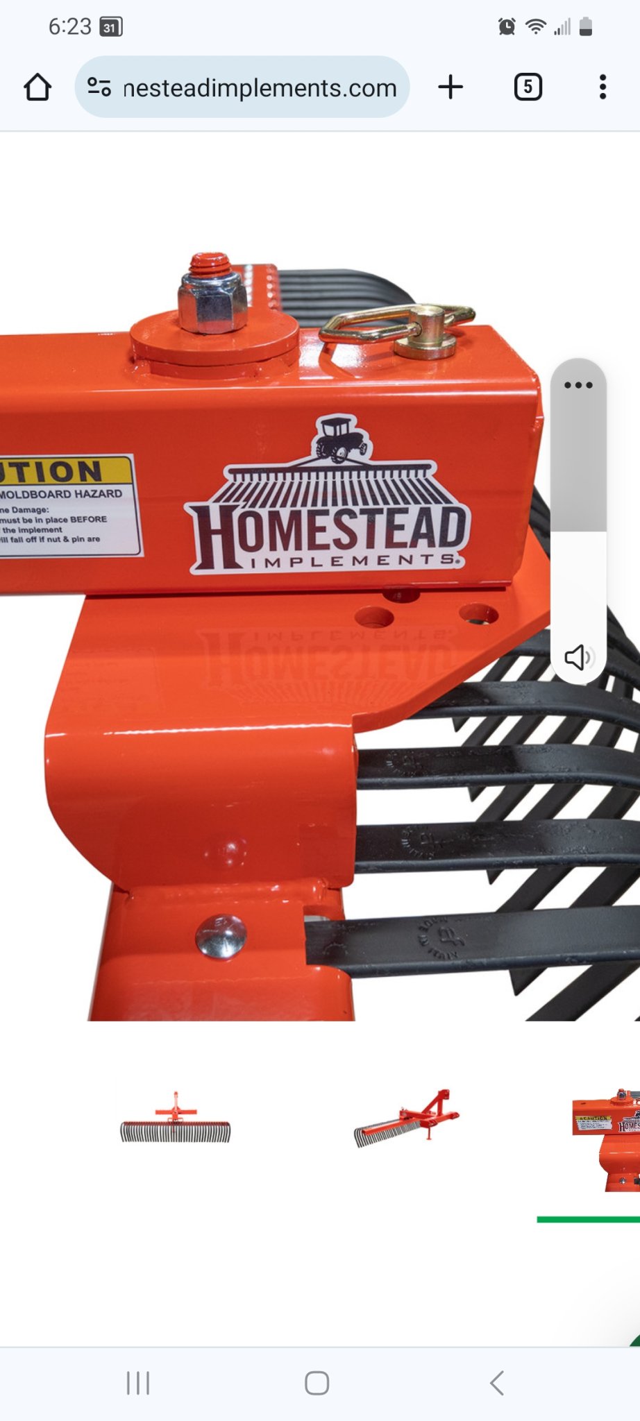

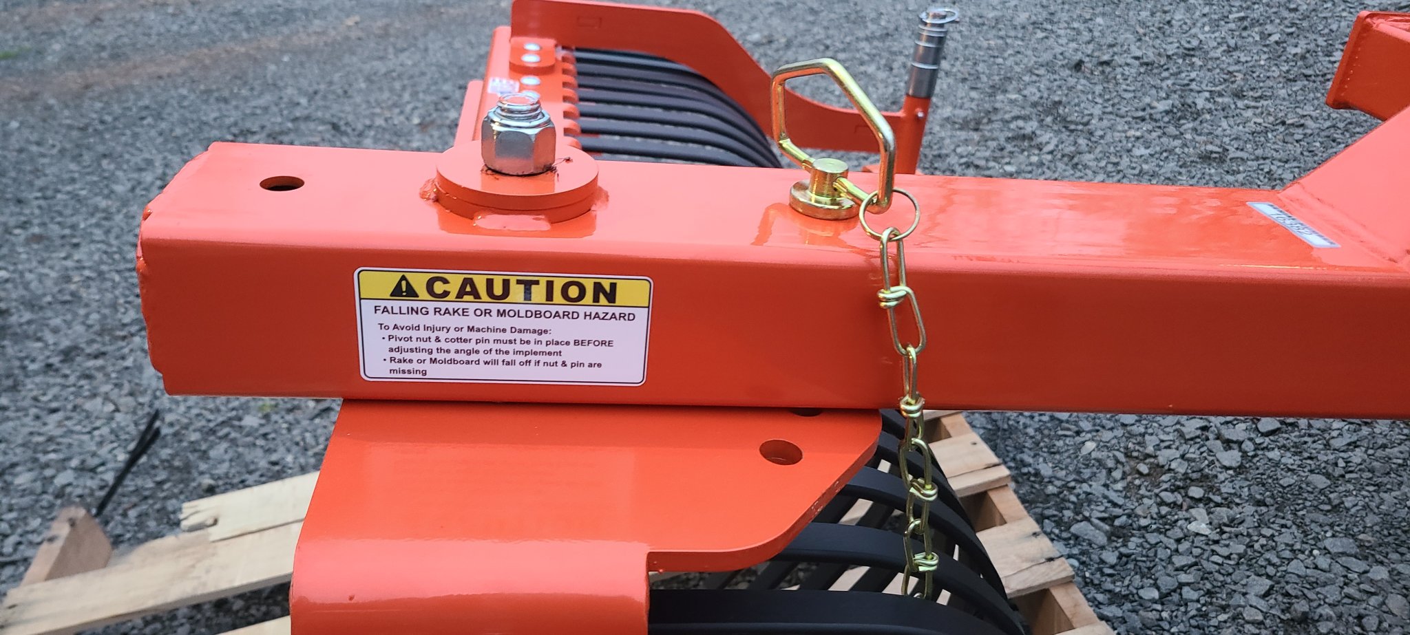

Pretty excited that my Homestead Implements rake showed up today. It was about 4 days ahead of their estimated ship date. I unwrapped it and hooked it up. The rake is shipped spun around backward to make it more compact for shipping. When I spun it around for use while going forward, there are no angle holes that line up. The photo on their website show (what look like) additional holes that I do not have.

I have no experience with that product, but the pics say a lot IMO. The advertised pics clearly have another set of holes. Only other thing I would recommend if trouble hitting the hole is as my pop would say ‘put some hair around it’. Yes I am going to hell for that, but that’s funny 😉and I miss my dad.

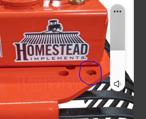

That's what I am seeing. It appears the holes that are visible are for mounting it in the opposite direction.
10,393
2,193
So - how the hell can the pin hit this hole(s)?
5,268
3,894
It looks like the second set of holes are the ones for the pin to drop into. The ones that are in line with the N in implements.

Looks like somebody put the wrong arm on the wrong rake,, just a thought
rh74
LX2610, LA535, BH77, LX2980, RB1672, BB2560, PFL1242
Feb 17, 2024
22
15
Hoosick Falls, NY
To me it looks like they sent you the rake for offset model (does have a second set of alignment pin holes) and frame for the non offset rake.

I know that it is not what you want or should have to do, but why not simply drill the holes required your self and be done with it?
Sure would save a lot of time and hassle.

There isn't another hole for the bolt that it pivots on is there?
