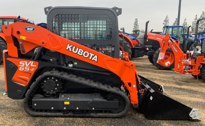

Consider a smaller skid or CTL? More money but lots of lifting capacity and takes heck of abuse. I find with my GL4060 that I don't run out of HP but I do run out of lift capacity.

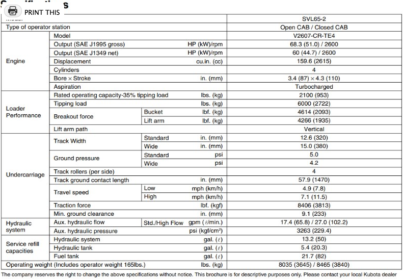

165# used to be the weight of a passenger for weight calculatin for airplanes...
pretty sure it's now 190#
Winter and Summer airline passenger weights were different.
Not sure how it works now.
